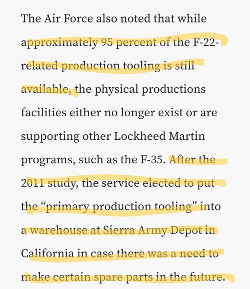

O RLY? Once more

O RLY? Once more
My understanding is that around 2016 the Air Force conducted an audit of the F-22 tooling, etc. that was stored at Sierra Army Depot and found everything they expected to be there was there.
If someone is truly interested in this they could contact the Sierra Army Depot public affairs and ask about the audit and wether the F-22 tooling is still stored there. They could also submit a FOIA request to the Air Force for a copy of the audit and specify that a summary of it is all they need and the full details are non responsive, which would (theoretically) reduce the amount of information the Air Force would need to review.
It is still possible that the tooling "burned" in a "flood" like the records of a certain Air Force agency (I have actually been told this before) since the 2016 audit.
Congress did allocate funds for the preservation of the F-22 tooling. The Air Force has ignored the wishes of Congress before, like when they took SR-71 reactivation funding, used it for other things, then claimed the SR-71 was too expensive and could not fly anyway (because they took away the funds allocated by Congress).
By whom? And can you explain how Raptor tooling can be used to shore up JSF production?
I do believe I used the term 'kludging'. And last I heard, Congress (including agencies such as the GAO) have not been able to independently verify the 95% of F-22 production tooling that was supposed to be still extant.

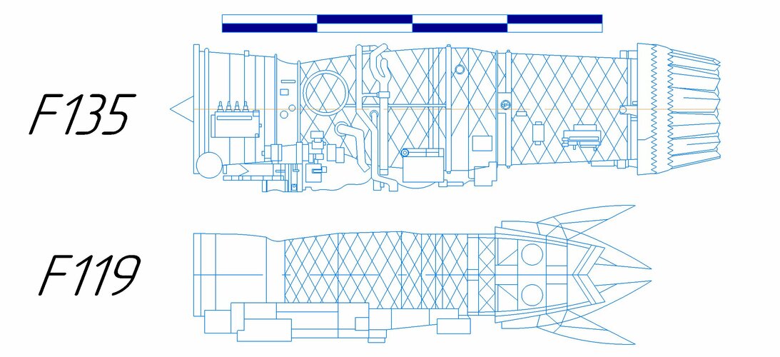

The F135 is larger in diameter, length, and weight than the F119, and would never fit in the F-22 engine bay.
The core module of the F135 is a development of the F119 core with some more advanced technology incorporated. There was a study done on what it would take to install the F135 core into the F119 to take advantage of the technology advancements and bring some commonality to the Depot overhaul process. It was decided at the time that this change was not worth the cost of implementation.
With the F135 Engine Core Upgrade in development, it seems like the ECU could also be incorporated into the F119 with similar changes that were identified in the previous study. Whether it would be cost effective or bring enough performance increase within the remaining F-22 life span is doubtful.
Were there ever plans to upgrade the F-22 engines? Seems odd if there weren’t any as all the teen series fighters had engine upgrades.

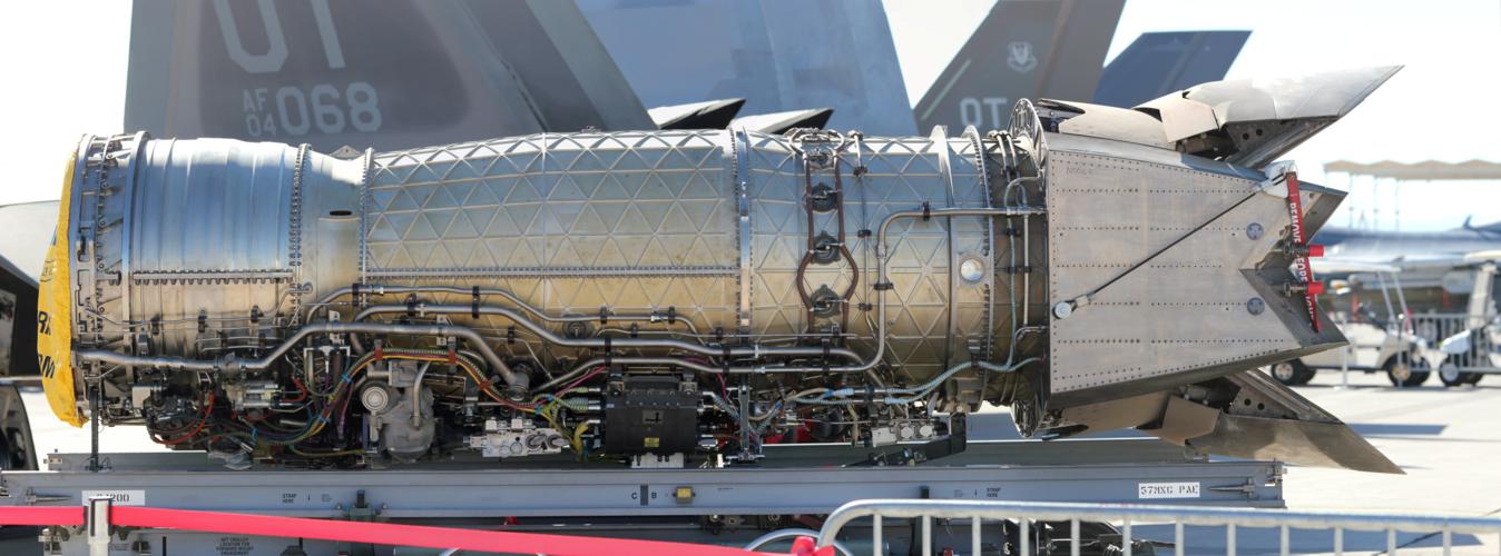

That drawing is not accurate, the F119 is smaller than the F135 but not by that much, and per publicly available USAF technical orders, the F119 is 196 inches (4,978 mm) in length with the rectangular nozzle flaps fully open, so the scaling is quite a bit off.
There were some F119 upgrade proposals in the 2000s when the F-22 program wasn't truncated, including some variations with round axisymmetric nozzles for the FB-22, but those didn't come into fruition. Most F119 upgrades have been smaller grade, consisting of durability improvements.
EDIT: This image is also a useful reference.
There has been a continuing F119 Component Improvement Program to improve the durability of individual parts to meet the specification engine and part life. There has been no physical engine changes to improve thrust performance.

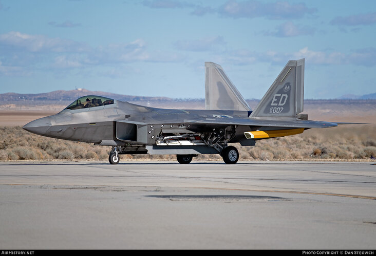

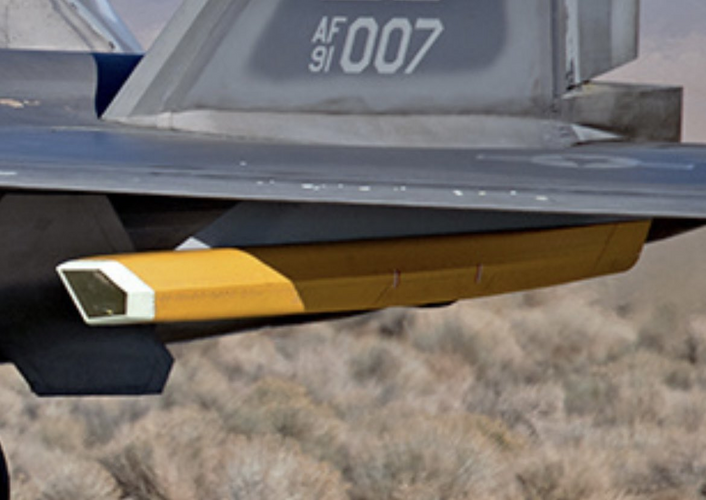

91-4007 from January this year.
"In a separate incident from 2021, an RTX employee used a company-issued laptop containing sensitive technical data while on a personal trip to Russia. Internal cybersecurity measures flagged the issue, but the location alert was ignored as a false positive.
The laptop contained technical data on the Lockheed Martin F-22 and F-35 stealth fighters, as well as the U-2. That employee had travelled to Russia on four prior occasions, bringing the laptop on at least one those earlier trips, according to the state department.
Another incident in 2019 saw an employee travel to Iran while carrying a company laptop containing technical data on the Northrop Grumman B-2 stealth bomber and F-22 fighter. In that case, cybersecurity protocols remotely froze access to the laptop’s hard drive."

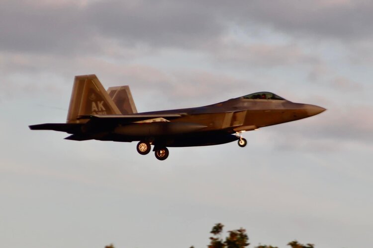

is it possible to make a new paint ? instead of this old used looking ?
Are you suggesting 'a fresh coat of paint', or an entirely different application of RAM in line with F-35 practices?
Genuine question - would the latter be feasible on the F-22?
