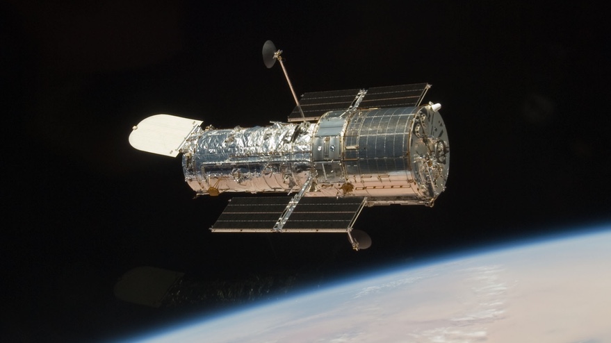

Isn't Hubble down to one working gyro? It seems unlikely to me it has enough life left in it to make a boost worth while.
Three (of six originals). It can work with just two, with some limitations.
But at least some of the thinking here is that they might be able to do a servicing mission either in conjunction with a reboost or separately. The gyros have been replaced once and possibly could be replaced again.
OTOH, Crew Dragon isn't exactly the perfect platform for a servicing mission, so a lot of development money might be needed.
i imagine having a docking mech on the third stage part and using it to connect whilst a dragon crew repairs it. and then discarding the third stage afterwards by dropping it into the atmosphere on the way down? its a possibility. but i would use a different platform. because even the Soyuz would work better. the dragon is just a bit small for the job. possible. but highly unlikely
I half wonder if trying the mission with Dream Chaser would be easier but would the crewed version even be available in the time frame required.
Would require quite a bit of additional hardware I suspect, possibly even something along the lines of an OTV or OMV.
It took the Space Shuttle to do the original Hubble servicing missions, you are right to be sceptical about SpaceX's Crew Dragon being used for the mission TomS. When I first saw the article I could not believe it myself.
Would the Dragon capsule have to be modified to dock with Hubble Flyaway? :confused:
Yes, Dragon doesn't have a docking adapter that fits Hubble.
Replacing the gyros would be difficult without a stable platform for the astronaut (Hubble repairs were usually done with an astronaut attached to the end of the robotic arm).
Thanks Hobbes, I also wonder how much such a docking adapter is going to cost to develop for just one mission to boost Hubble?
The adapter isn't that complicated (IIRC it's based on the grapple mechanism on the end of the Canadarm, so it's reasonably standard).
That is a lot better than I initially thought. Using technology that already exists is a lot better than designing and building new tech and quite possibly cheaper as well.
My memory was incorrect. Hubble has a docking adapter based on the NASA Docking System. This is generally used to dock manned spacecraft together. Hubble received the Soft-Capture Mechanism that's part of this system.
Dragon carries a common Berthing System docking adapter in its nose, so it can't use that. But the NDS is standard hardware, so putting an adapter in Dragon's trunk shouldn't be too difficult.
Anyway they’ll probably be using the thrusters in the nose to reboost Hubble.
