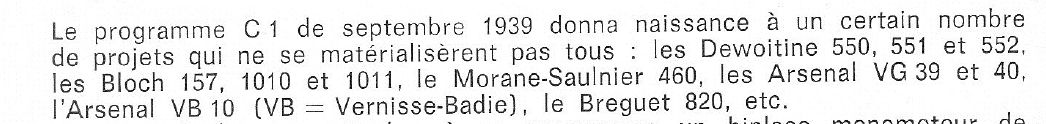

*** For the year 1939
-"C.1" single seat fighter; Bloch MB.157,MB.1010 & MB.1011,
Dewoitine (SNCAM) D.550,D.551 & D.552,Breguet Br.820,Arsenal
VG.39,VG.40 & VB.10,Morane-Saulnier MS.460 and Caudron C.910
D.550 was a racer, not a fighter.
VB.10? Where did you find this information? The older mention I found about the VB-10 experimental aircraft is in 1941.
Missing: VG.50, VG.60, VG.70, MB.156, C.900C1, R.30.

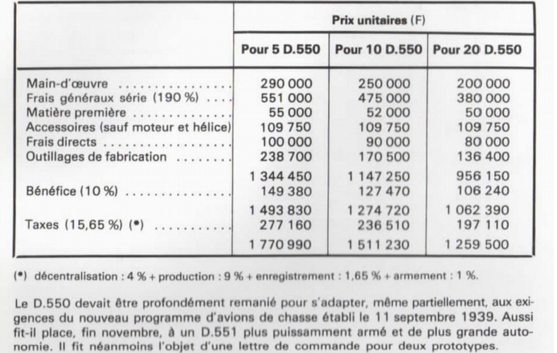

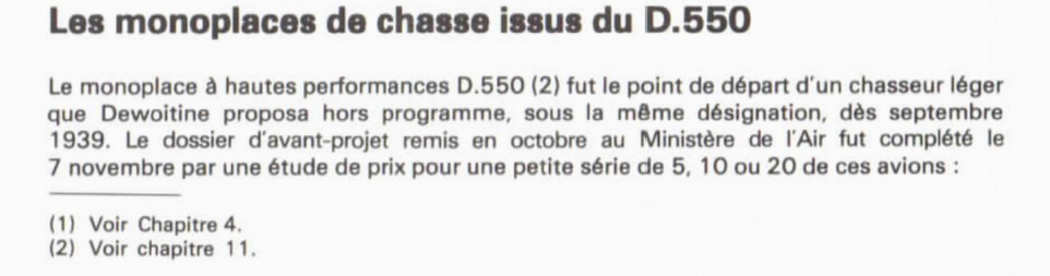

That's wrong,
D.550 : 1939 : light fighter, derivative of the D.550 (project),from Docavia
https://www.secretprojects.co.uk/threads/dewoitine.4652/
- Also from Docavia.
This is a little bit more complicated. In fact, there were discussions during months between the Air Ministry, the General Staff and Dewoitine about the definition of the fighter to be derived from D.550 racer. Some proposals are minimizing the adaptation, with just a very light armament. The alternative was the D.551 with increased wings and weight, and more armament. Finally, only the D.551 was selected. I attach an example of such discussions. Finally, there was no real project for D.550 fighter, just discussion about which definition must be ordered.
You can find more details about D.551 in issue n° 14 of "Les Ailes" magazine recently published: https://www.avions-bateaux.com/produit/magazines-les-ailes/5648
I only believe what Docavia said,here it's.
In this case, you agree that, as stated in Docavia, the D.550 fighter is out of program, so you must remove it from the list of competitors.
I only believe what Docavia saids.
Even if I agree that Danel and Cuny always did very good job, their interpretation on this topic cannot compete with original Air Ministry archives. Albert Caquot and Michel Détroyat had a better knowledge on the subject in 1938 than Raymond Danel in 1982.
Please never deny primary material just based on publication, even from good authors.

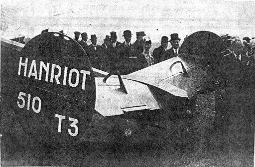

I disagree. As you can see attached, the prototype was officially presented as Hanriot 510.

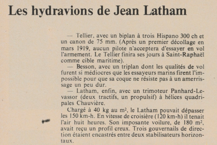

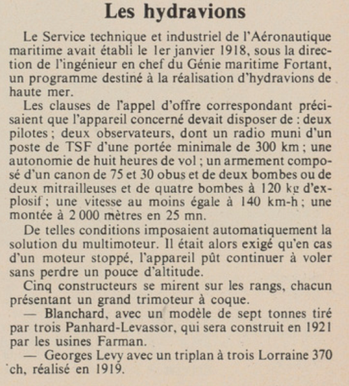

*** For 1921
- Recce bomber seaplane; Levassuer PL-3,Farman-Blanchard design and Dewoitine D.6
From Aviation magazine 1975,
I think that competition is the same of this one, am I right ?.

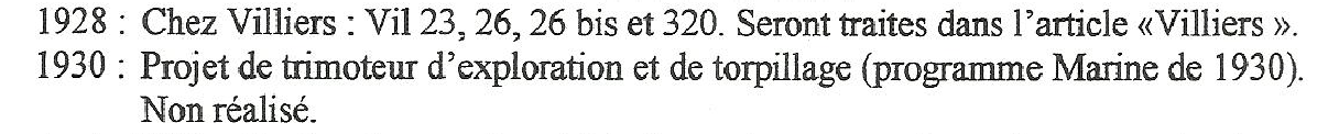

>>> *** For the year 1930
>>> -"TOR.2/3" two/three seat torpedo bomber seaplane; CAMS-60, Denhaut design and Farman F.210
Looking at the year 1930 and the torpedo bomber category, what source mentions a Denhaut design?
Do you have any other information on this specific subject?
(IMHO In 1930, concerning Denhaut, I rather envisage a project studied by him, but for Villiers...)
Thanks in advance.
Hi Fcl,
it's from TU magazine,and the aircraft was designed after collapse
of Villiers as in the magazine
Thanks you!
