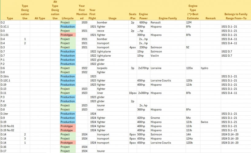

Hi all,
I search for a complete list of aircraft by the french aircraft builder Dewoitine.
If you have drawings of projects by Dewoitine please let me know. Thanks.

Yes, i have the book "Les avions Dewoitine". I promised the complete list in another topic. But i need a little more time :-[
Deltafan
May 8, 2006
1,273
963
Ahem... It's a little late... :-[
but it's gone : say me when the translation is not good :
Part one :

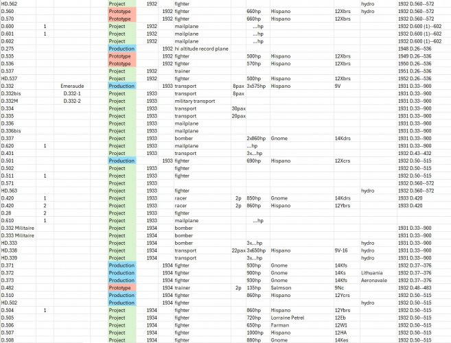

Part two :
D.30 : 1928 : transport, one engine
D.31 : 1929 : transport, three engines, derivative of the D.30
D.310 : foreseen new name of the D.31
D.32 : 1929 : fighter, derivative of the D.27 (project)
D.32 bis : 1929 : fighter, derivative of the D.32 (project)
D.33 : 1929 : for ditance record, one engine
D.33B : 1931 : bomber, derivative of the D.33
D.331 : 1931 : renamed D.33B
D.332 : 1932 : transport, three engines, derivative of the D.33
D.332 bis : 1932 : transport, three engines, derivative of the D.33 (project)
D.332-1 : renamed D.332 bis
D.332 M : 1933 : transport, three engines, derivative of the D.33 (project)
D.332-2 : renamed D.332 M
D.332 Militaire : 1933-34 : bomber, derivative of the D.332 (project)
HD.333 : 1934 : seaplane, bomber, derivative of the D.332 (project)
D.333 : 1934 : transport, derivative of the D.332
D.333 militaire : 1934 : bomber, derivative of the D.333 (project)
D.334 : 1933 : transport, derivative of the D.332 (project)
D.335 : 1933 : transport, derivative of the D.332 (unfinished)
D.336 : 1933 : postal for South Atlantic, three engines (project)
D.336 bis : 1933 : postal for South Atlantic, three engines (project)
D.337 : 1933 : bomber, two engines
HD.338 : 1934 : seaplane, transport for South Atlantic, three engines (project)
D.338 : 1934 : transport, derivative of the D.335
HD.339 : 1934 : seaplane, transport for South Atlantic, three engines (project)
D.339 : 1937 : military transport, three engines (project)
D.34 : 1929 : little transport, one engine (project)
D.340 : 1937 : transport, three engines, derivative of the D.620 (project)
D.341 : 1937 : transport, three engines (project)
D.342 : 1937 : transport, three engines, derivative of the D.620
D.35 : 1929 : little transport, one engine (project)
D.35 bis : 1929 : derivative of the D.35 (project)
D.350 : 1944 : transport, two engines (study for Mitsubishi)
D.36 : 1930 : little civilian plane (project)
D.36 bis : 1930 : little civilian plane (project)
D.37 : 1929 : light fighter (project)
D.37 : 1930 : fighter
D.370 : renamed (second) D.37
D.371 : 1932 : fighter
D.372 : 1934 : fighter
D.373 : 1934 : navy fighter
D.374 : 1935 : two seats navy fighter (project)
D.375 : 1935 : two seats navy recce (project)
D.376 : 1935 : navy fighter
D.38 : 1929 : fighter (project)
D.39 : unidentified
Deltafan
May 8, 2006
1,273
963
Part three :
D.40 : 1929 : racing trainer (project)
HD.40 : 1930 : seaplane, racing trainer, derivative of the D.40 (project)
D.41 : 1930 : racing trainer (project)
HD.41 : 1930 : seaplane, racing trainer, derivative of the D.41 (project)
HD.41 : 1930 : seaplane, racer
HD.410 : 1930 : renamed racer HD.41
HD.411 : 1931 : seaplane, racer (project)
HD.412 : 1931 : renamed racer HD.41
D.42 : unidentified
D.420 : 1933 : multi-seats fighting plane, two engines (unfinished prototype)
D.43 : 1930 : colonial plane, three engines
D.430 : renamed D.43
D.431 : 1933-34 : transport, three engines (project)
D.432 : 1936 : renamed D.430 with new engines
D.44 : 1930 : transport, four engines (project)
D.440 ? : 1931 ? : little civilian plane (project)
D.44 bis : 1930 : transport, four engines (project)
D.45 : 1930 : transport, four engines (project)
D.450 ? : 1931 ? : little civilian plane (project)
HD.46 : 1930 : seaplane, transport, four engines (project)
D.47 : 1930-31 : fighter (project)
D.47 bis : 1931 : fighter (project)
D.48 : 1930 : school
D.480 : renamed D.48
D.481 : 1930 : derivative of the D.480
D.482 : 1934 : D.480 and D.481 with new engine
D.483 : 1935 : experimental
D.49 : 1930 : transport, one engine (project)
D.49 : 1930-31 : fighter (project)
D.49 bis : 1931 : fighter (project)
Deltafan
May 8, 2006
1,273
963
Part four :
D.50 : 1930-31 : fighter (project)
D.50 : 1931 : fighter (project)
D.50 bis : 1931 : fighter (project)
D.500 : 1931 : fighter
HD.500 : 1932 : seaplane, fighter (project)
D.501 : 1932 : fighter, derivative of the D.500 (project)
D.501 : 1933 : fighter, derivative of the D.500
HD.502 : 1932 : seaplane, derivative of the HD.500 (project)
D.502 : 1933 : fighter, derivative of the D.500 (project)
D.503 : 1933 : fighter, derivative of the D.500 (prototype unfinished)
D.503 : 1933 : fighter, derivative of the D.500 (project)
D.503 : 1934-35 : fighter
HD.503 : 1933-34 : seaplane, fighter (project)
D.504 : 1933 : experimental, derivative of the D.503
D.504 : 1935 : experimental, derivative of the D.513 (project)
D.505 : 1934 : fighter, derivative of the D.500 (project)
D.506 : 1934 : fighter, derivative of the D.500 (project)
D.507 : 1935 : fighter, derivative of the D.500 (project for Argentina)
D.508 : 1935 : fighter, derivative of the D.500 (project for Argentina)
D.508 bis : 1935 : fighter, derivative of the D.500 (project for Argentina)
D.509 : 1935 : fighter, derivative of the D.500 (project for Argentina)
D.51 : 1930-31 : fighter (project)
D.510 : 1933 : fighter
D.511 : 1933 : fighter, derivative of the D.500 (project)
D.511 : 1934 : fighter, derivative of the D.510
D.512 : 1934 : fighter, derivative of the D.500 (project for Lithuania)
D.513 : 1935 : fighter
D.514 : 1935 : experimental, derivative of the D.513
D.515 : 1934 : fighter, derivative of the D.510 (project)
D.52 : 1930-31 : fighter (project)
D.520 : 1935 : light fighter (study)
D.520 : 1937 : fighter
D.520 DC : 1945 : two seats trainer
D.520 Z : 1941 : modified D.520 with HS 12 Z engine
D.521 : 1939 : derivative of the D.520 with Merlin engine
D.522 : 1940 : derivative of the D.520 with american engine Allison or HS special (project)
D.523 : 1940 : derivative of the D.520 with HS 12 Y 51 engine
D.524 : 1940 : derivative of the D.520 with HS 12 Z engine (prototype unfinished)
D.525 : 1940 : derivative of the D.520 with HS 12 Y 51 engine and special charger (project)
D.53 : 1931 : fighter, derivative of the D.27
D.530 : renamed D.53
D.530 : 1938 : racer, derivative of the D.520 (project)
D.531 : 1931 : fighter, derivative of the D.53
D.532 : 1931 : fighter, derivative of the D.53
D.533 : 1931 : fighter, derivative of the D.530 (project)
D.534 : 1931 : experimental
D.535 : 1931 : fighter, derivative of the D.530
D.536 : 1932 : fighter, derivative of the D.530 (prototype unfinished)
D.537 : 1932 : trainer, derivative of the D.530 (project)
HD.537 : 1932 : seaplane, fighter, derivative of the D.535 (project)
D.540 : 1932 : fighter (project)
D.550 : 1932 : fighter (project)
D.550 : 1938 : racer
D.550 : 1939 : light fighter, derivative of the D.550 (project)
D.551 : 1939 : fighter (12 unfinished)
D.552 : 1939 : fighter, derivative of the D.550 (2 unfinished)
D.553 : 1940 : fighter, derivative of the D.551 (project)
D.554 : 1940 : fighter, derivative of the D.551 (project)
D.555 : 1940 : recce (4 unfinished)
D.560 : 1931 : fighter
D.560 : 1940 : racer, derivative of the D.551 (2 unfinished)
D.561 : 1932 : fighter, derivative of the first D.560
HD.561 : 1932 : seaplane, derivative of the D.561 (project)
HD.562 : 1932 : seaplane, derivative of the D.561 (project)
HD.563 : 1933 : seaplane, derivative of the D.561 (project)
D.570 : 1931 ? : civilian plane (project)
D.570 : 1933 : fighter
D.570 : 1938 : two seats trainer for fighting (project)
D.571 : 1933 : experimental, derivative of the second D.570 (project)
HD.571 : 1934 : seaplane, derivative of the second D.570 (project)
D.572 : 1934 : derivative of the second D.570 (project)
D.58 : 1930 : for long distances, derivative of the D.33 (project)
D.580 : renamed D.58
D.580 : 1938 : two seats trainer for fighting (project)
D.59 : 1931 : bomber, one engine, derivative of the D.33 (project)
D.59 : 1932 : rapid transport, derivative of the D.33 (project)
D.590 : 1939 : racer (project)
Deltafan
May 8, 2006
1,273
963
Part five :
D.600 : 1932-33 : postal, one engine (project)
D.600 : 1937 : fighter, two engines (project)

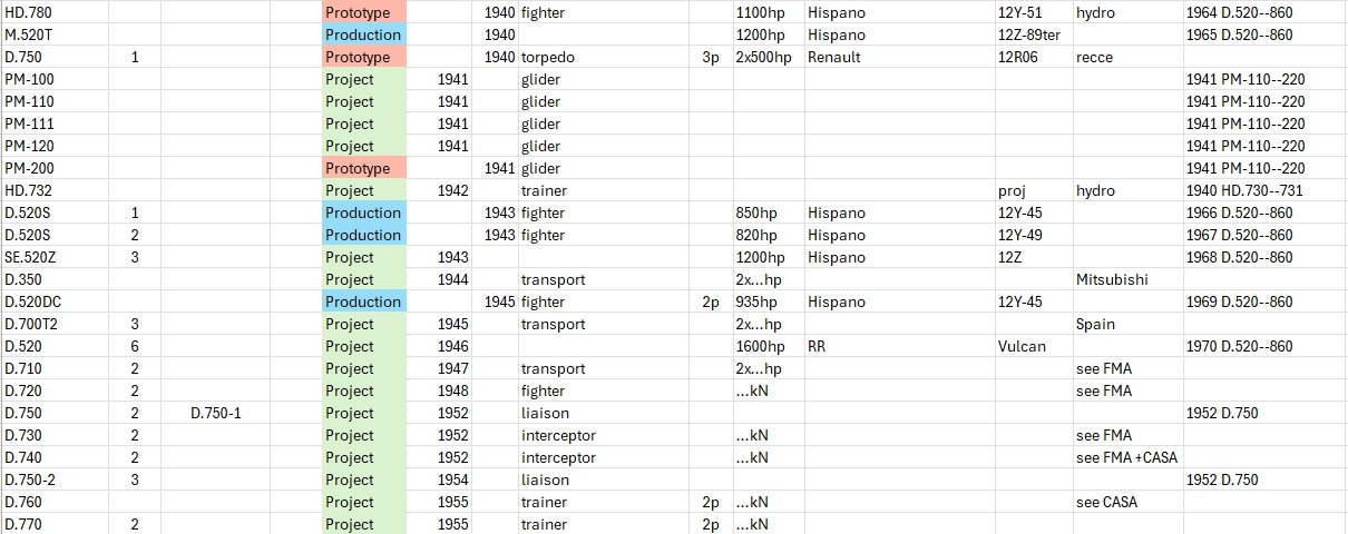

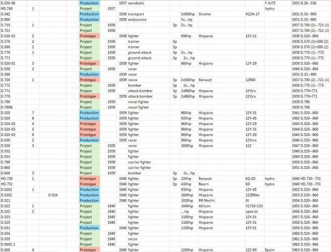

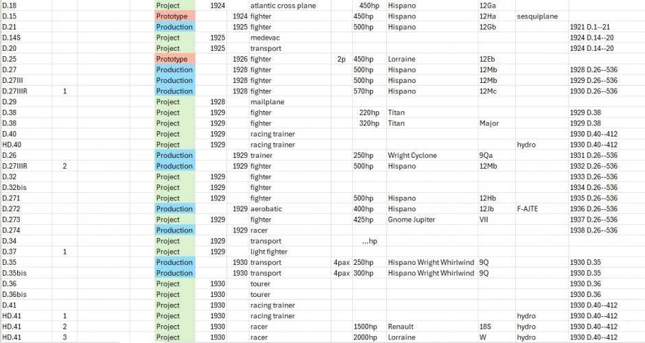

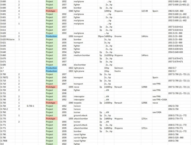

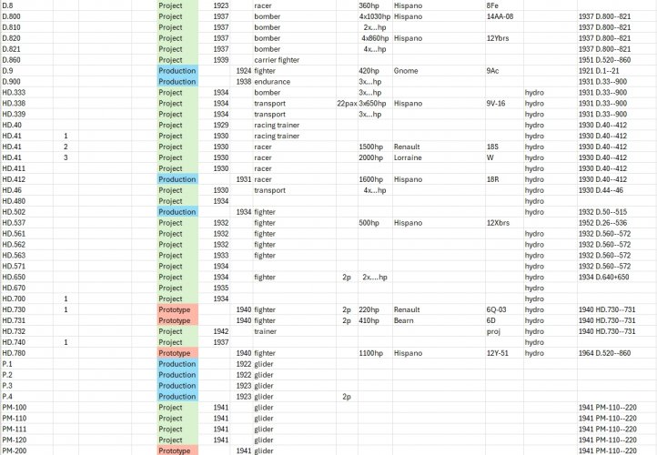

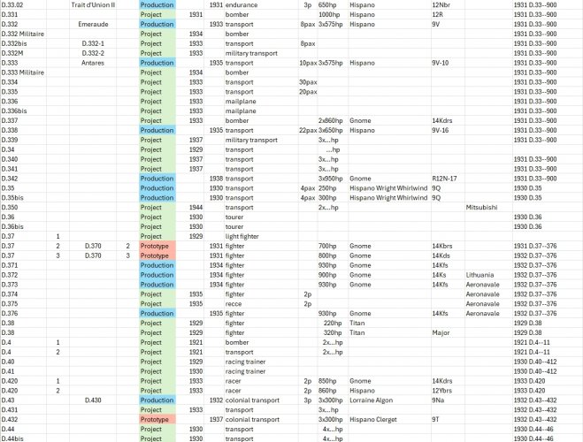

D.600 : 1939 : bomber, three seats, two engines (project)
D.600 : 1942 : fighter (project for Spain, mock-up)
D.601 : 1932-33 : postal, one engine (project)
D.601 : 1937 : fighter, two engines (project)
D.602 : 1932-33 : postal, one engine (project)
D.610 : 1933 : postal, one engine (project)
D.610 : 1937 : command (?), 3 seats, 2 engines (project)
D.611 : 1937 : command (?), 3 seats, 2 engines (project)
D.620 : 1933 : postal, one engine (project)
D.620 : 1934 : transport, three engines
D.620 Militaire : 1934 : bomber, derivative of the second D.620 (project)
D.621 : 1935 : derivative of the second D.620 (project)
D.630 : 1935 : fighter, two engines (project)
D.631 : 1935 : fighter, two engines (project)
D.640 : 1934 : fighter, 2 seats, two engines (project)
HD.650 ? : 1934 : fighter, derivative of the D.640 (project)
D.660 : 1935 : bomber, two engines (project)
HD.670 : 1935 : seaplane (project)
D.670 : 1937 : 3 seats, two engines (project)
D.671 : 1937 : 3 seats, two engines (project)
D.680 : 1936 : dive bomber, two engines (project)
HD.700 : 1934 : seaplane, to cross South Atlantic (project)
D.700 : 1937 : 3 seats, two engines (unfinished prototype)
D.700 : 1945-46 : Pulqui I : interceptor jet for Argentina
D.700-T2 : 1945 : transport, two engines (project studied in Spain)
D.710 : 1938 : 3 seats, two engines (project)
D.710 : 1947 : transport, two engines (project studied in Argentina)
D.720 : 1938 : 3 seats, two engines, derivative of the first D.700
D.720 : 1948 : interceptor jet (project studied in Argentina)
D.721 : 1938 : derivative of the first D.720 (unfinished prototype)
HD.730 : 1938 : seaplane, observation
D.730 : 1952 : interceptor jet (project studied in Spain and in Argentina)
HD.731 : 1938 : seaplane, derivative of the HD.730
HD.732 : 1942 : seaplane, trainer (project)
HD.740 : 1938 : seaplane, school (project)
D.740 : 1952 : interceptor jet (project studied in Spain and in Argentina)
D.750 : 1938 : seaplane, navy observation
D.750 : 1952 : liaison, one engine
D.750-1 : renamed second D.750
D.750-2 : 1954 : derivative of the D.750-1
D.760 : 1955 : trainer jet, 2 seats (project studied in Spain)
D.770 : 1938 : ground attack, three seats, 2 engines
D.770 : 1955 : trainer jet, 1-2 seats (project)
D.771 : 1938 : derivative of the ground attack D.770
D.772 : 1939 : light bomber, 3 seats, derivative of the ground attack D.770 (unfinished prototype)
HD.780 : 1938 : seaplane, fighter (2 unfinished)
D.790 : 1939 : navy fighter (project)
D.790B : 1939 : derivative of the D.790 (2 unfinished)
D.800 : 1937 : heavy bombler, 4 engines (unfinished prototype)
D.810 : 1937 : bomber, 2 engines (project)
D.820 : 1937 : bomber, 4 engines (project)
D.821 : 1937 : derivative of the D.820 (project)
D.860 : 1939 : navy fighter, derivative of the D.520 (project)
D.900 : 1937 : for long distances records, three engines (project)
The end, for now
