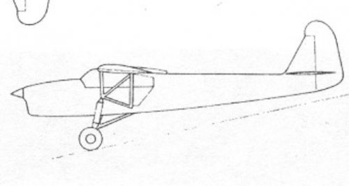

The Gourdou G-90 was two seat high wing cabin STOL
monoplane,it was a copy of Germany Fieseler Fi.156
and intended for liaison duties,and powered by one
120 hp inverted-V Renault engine.The Levasseur and
Caudron submitted a proposals to this competition.

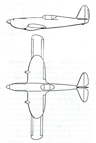

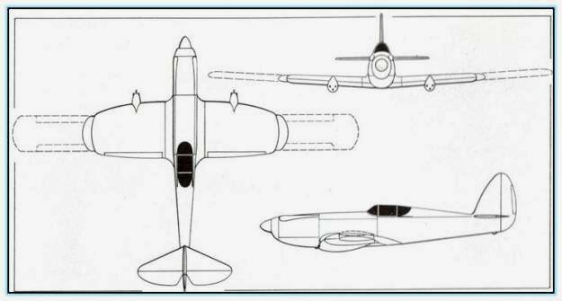

[quote author=Andrewjs2007]Does anyone have any dimensions for the Gourdou G.11 C-1 project (I have the Air Pictorial article but no wingspan, length etc.)?[/quote]
Hi Andrewjs and Jemiba.
Air International march 1975 :
Ingenieur G bruner teamed with aircraft designer Ch Gourdou to study
this fighter project based on Makonine concept.
They found that it was impatical for such a small plane and
abandonned it.
Span : 6.76/11.40 meters
Lenght : 9.78 meters
Max speed 680 km/h at 7.000 m
Max Range : 2.000km at 240 km/h with fully extended wings
Nothing more
Bye

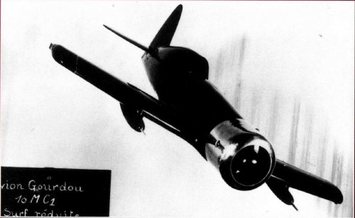

from Le FANA No 365,the Gourdou G.10 C.1 fighter project Models.

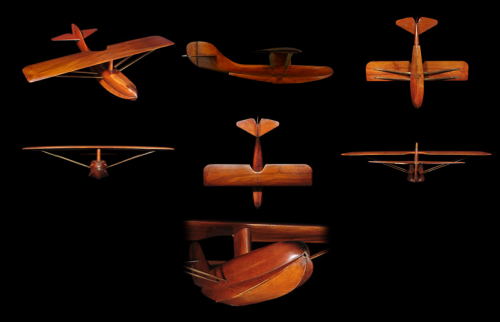

and I hope to get Loire-Gourdou-Lesuerre LGL-610B and LGL-611 unknown projects.
Maybe that was the same Project ?.

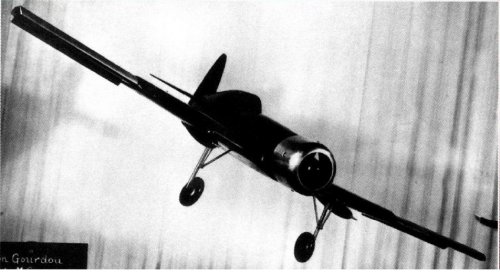

http://www.maquettes-de-soufflerie.com/Maquette_de_soufflerie_projet_Gourdou_leseurre.html

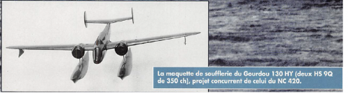

Le Fana 317,
here is a Gourdou G.130 Project.

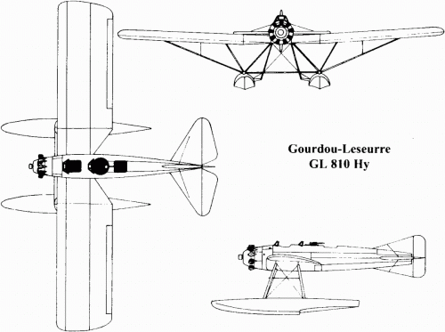

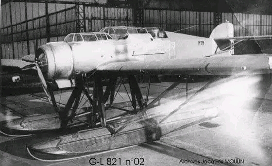

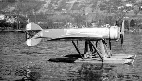

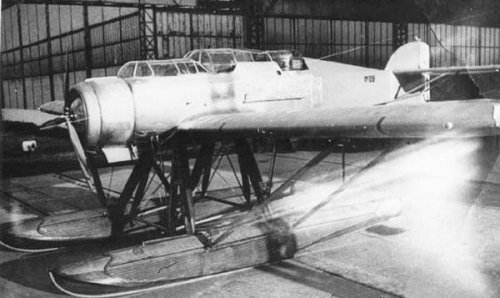

Hi! GL-810, GL-820 and GL-821.
https://aero-nation.weebly.com/gourdou-lessure.html
Developing the scheme GL.810 engineers Gourdou Leseurre have prepared two more advanced modifications.
The first was the float reconnaissance seaplane GL.820Hy, the design of which was practically unchanged.
The second modification - Gourdou Leseurre GL.821HY , appeared three years later, was equipped with a Gnome-Rhone 9Kfr engine (750 hp) and had the best engine hooding.
The first prototype GL.821.01 entered the tests on January 28, 1936. Unlike other "relatives" it was made as an easy torpedo carrier. The Navy did not call for interest.
The second prototype GL-821HY 02, with a fully glazed cockpit, began to fly from October 5, 1937, but even then it was clear that the fleet needed a more modern aircraft.
Modifying the design of 820 did not make much sense, since it completely exhausted its resource.
Both variants remained only at the stage of experimental machines.
The same fate befell their main competitor - the float reconnaissance Levasseur PL.200.
Although he surpassed the serial planes of Gourdou Leseurre, he had no decisive advantages and was also not accepted for serial production.

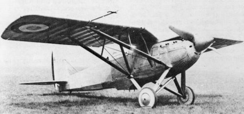

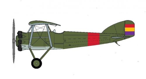

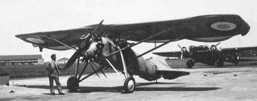

Hi! GL-482.
http://military.sakura.ne.jp/world/w_gl432.htm
"Gourdou-leseurre GL-432 carrier bomber
Gourdou-leseurre GL-432 carrier bomber (Designed by French Aviation technician Charles Edouard Pierre Gourdou and Jean Adolf Leseurre) was an aircraft that has developed from the GL-30 series. The GL-30 was a single-seat fighter that evolved from a racing aircraft, but the GL-430, which was completed in 1931, was designed to be a-single seat bomber. (therefore, the prototype aircraft was called as GL-430. 01B1 (B1 is a symbol representing a single –seat) bomber).
GL-430, which had a parasol type high wing, strengthened the prop that supporting the wing on the fuselage, but other parts were similar to GL-32, which is the main production type of the GL-30 series. GL-430 had duralumin steel pipe construction covered with fabric, it was possible to dive bombing with a 50kg bomb under the fuselage.
GL-430 prototype aircraft that had landing hook, strengthen the structure of the rear fuselage, a long-term test operation was carried out by the French Navy.
In 1935, the French navy ordered four GL-432BP1 (BP1 represents a single-seat dive bomber) which became a pre-production aircraft.
The GL-432 was more strengthened than the prototype aircraft, and the bladder was installed to float the aircraft at the time of crash landing on water for offshore operation. The GL-432 amount of the bomb was larger than the prototype aircraft and can be equipped with a 225 kg bomb for the Navy.
From 1936, French Navy conducted operation test using GL-432, but the Second World War broke out before it started mass production, so it ended without leaving the prototype.
Also GL-482 single seat fighter and GL-531 carrier bomber were product experimentally, but these aircraft have also been planned to discard France surrender.
These aircraft were terminated due to French surrender."

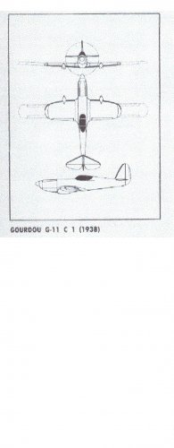

A slightly different image (from posts #6 and #8) of the 1937 Gourdou G.11 C1 project, with better quality:
