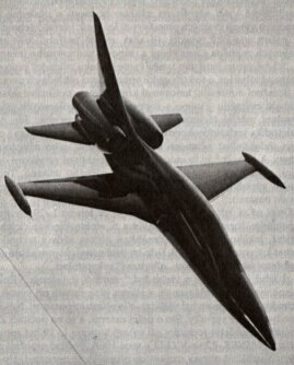

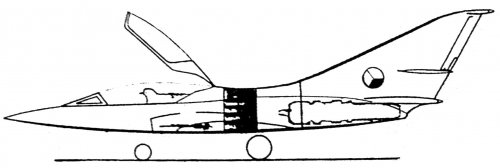

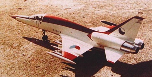

Aero B-34 - attack aircraft proposed in 1958 as Il-10 replacement. It was powered by one RD-9 engine without afterburner rated at 29 kN. Weapons consisted of two 23 mm canons NR-23, unguided bombs or unusual solutions like 80 unguided rockets (55mm LR-55) in two rounded receptacles around engine!

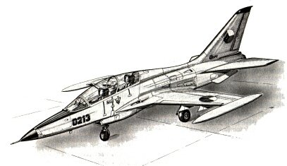

Aero A-159B Sokol - supersonic attack fighter from 1967, powered by two engines rated at 19,6 kN.

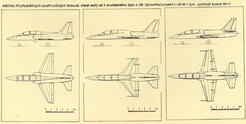

and here some L-39 projects,the last is look like General Dynamics
F-16.
http://l-39.cz/L-39_historie.html

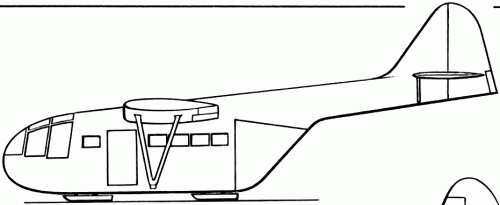

the Aero Ae.53 was a glider transport aircraft,but never completed and
stopped building in 1951.
Source; Air Enthusiast magazine of 1972.

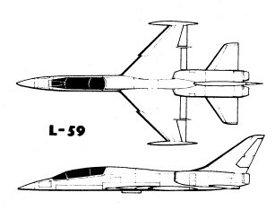

here is the early designs to Aero L-59 and L-159 aircraft;
http://www.randalf.cz/sw/other/sokol.php

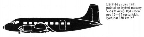

Some more unbuilt Aero postwar projects:

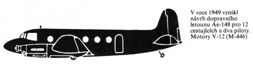

Ae-148 (1949) - passenger aircraft, 2+12 seats, two Walter V-12 (M-446) engines (550/700 hp each).

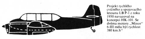

LB P-1 (1950) - 2-seat high-speed trainer and courier aircraft based on Hodek HK-101 prototype. Two Walter Minor 6-III engines (160 hp each). Maximum speed 380 km/h.
LB P-16 (1951) - passenger aircraft (15 to 17 seats): four 320-hp Walter M-436 (V-6) engines, 350 km/h speed.

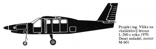

L-260 (1970) - 10-seat multi-purpose aircraft designed by eng. Jan Vlček, with 700-hp Walter M-601 turboprop engine. (This project was the second one under L-260 designation; the first one designed in 1959-60 was upgraded L-60 Brigadýr with Praga M-208D engine).
Source: V.Němeček. Československa letadla (II) 1945-1984. - Praha, Naše vojsko, 1984. - P.75-84.

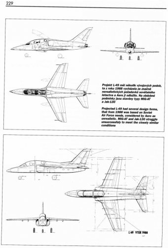

and my dear Matej,do you have a drawing to Aero L-49 ?.
Many thanks Stephane and Hesham!
Dear Matej, can you give us the original source of B-34 project info? It's a bit strange that there's no mention about such a project in Němeček's bible. Well, not all the unbuilt projects are mentioned there, but also the designation looks unusual - it seems to be already military designation, not Aero's.
redstar72: Němeček did a great work, but he did not have all the info/was not allowed to publish everything. Info and drawings are directly from manufacturer. B-34 was too ambitious project with totally unrealistic time schedule, based on the fight concept from second world war. So it was kind of fiasco, that Communist idiots did not want to see. B-34 was a preliminary manufacturer's designation that should suggest, that this plane was proposed to replace aging B-33 (licence built Il-10).
hesham: Yes, I have.
Okay, this is a rare book that you will probably not get in touch with, so one page will be fair enough.
Aero - obrazová historie leteckého výrobce by Pavel Kučera, ISBN 8090251633 9788090251632
It has also nice cutways of L-39M Mach Trenér, L-159/A-159 Sokol, L-29 with MiG-17 wings and other crazy stuff.

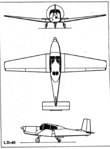

we spoke before about XLD-40 Mir,and here is its drawing.
What I've found about the development of the LD-40, later L-40 Sokol, is,
that the XLD-40 was the prototype with a V-tail. So, as the caption says,
the drawing shows the production LD-40 . ;)

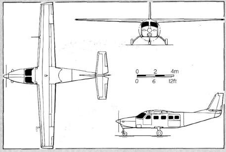

My dear Redstar72,
here is a different drawing to Aero L-260 aircraft project,from Flieger Revue 1/1978,I can't judge,where
that contrast came from.
hesham said:
My dear Redstar72,
Hi Hesham!
Excuse me that I didn't answered before - I saw your message only now.
As I mentioned, the L-260 from 1970 (a picture of which I posted) was the second project under this designation. Probably your picture represents the first one, developed from L-60 Brigadýr.

Amusing how so many of those proposed jets resemble Northrup T-38 trainer and F-5 Freedom Fighter.
Similarly, L-260 looks an awful lot like a Cessna 208 Caravan ..... which dominates its market sector and has only been challenged by Quest Kodiak.
Too bad they did not build that low-wing light transport. It could have filled a gap in the market between the slow (almost STOL) Caravan and Pilatus' much faster APC-12 executive transport.

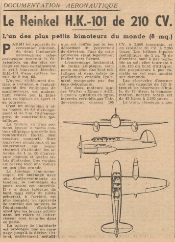

Here is the Hodek HK.101,which became Aero LB P-1.
Ailes 4/1947.
Ah, Hesham? I think you may have mistyped 'Heinkel' in your last post.

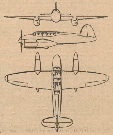

the Aero Ae.51 was alternative design to Czech competition of late 1940s,for Artillery observation and recce
aircraft,which Ae.50 won it,powered by six-cylinder Minor engine,and some improvements,remained a Project
only.

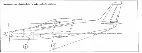

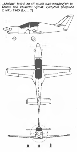

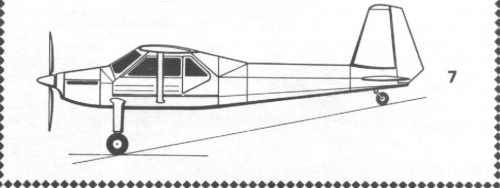

From L + K 6/1970,

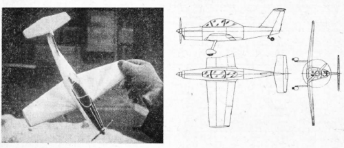

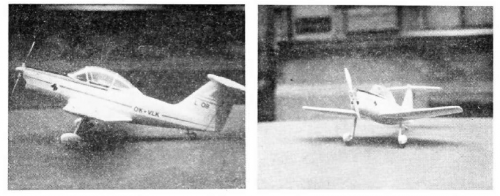

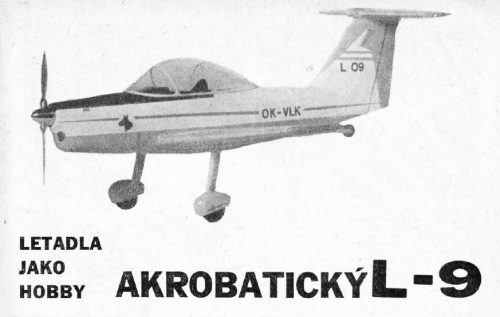

I found this strange Project for Aero,called L-9,as a single seat low-wing cantilever acrobatic monoplane,with
T-tail and powered by one either of M-137 or V-503A,I used google translate,am I right,and was it a real Project ?.

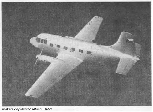

From L+K 21/1984,

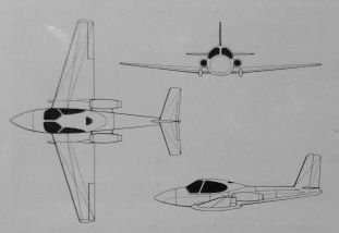

here is a Project for Aero called Ae-58, as twin engined low-wing light transport monoplane.

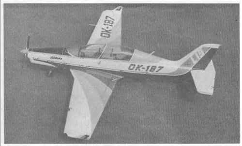

From L+K 13/1985 and L+K 20/1984,

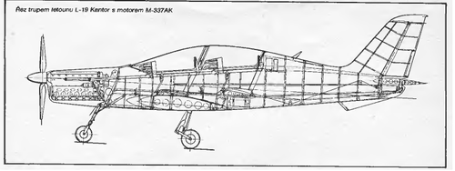

as I spoke before about L-9,there was also L-19,maybe it was from Aero/VZLU ?.

Actually this project was designed for the Zenit 84 contest, organised by the SSM, or Union of Socialist Youth. Design group, probably mostly students or recent graduates, was led by the son the designer of L-39, J. Vlček. They won the gold medal, and aftert it went trough some modifications (apparently later it had T-tail), it was offered to production to Aero concern, but they preffered to open production of Ae.270 Ibis.

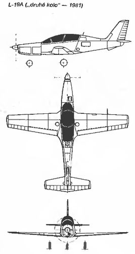

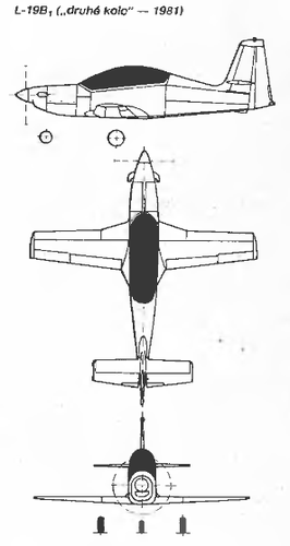

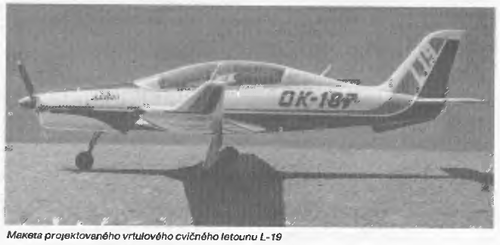

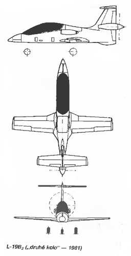

From L+K 12/1988,
here is a L-19 Project with its variants and developments,please note the pusher engined and jet engined versions..
