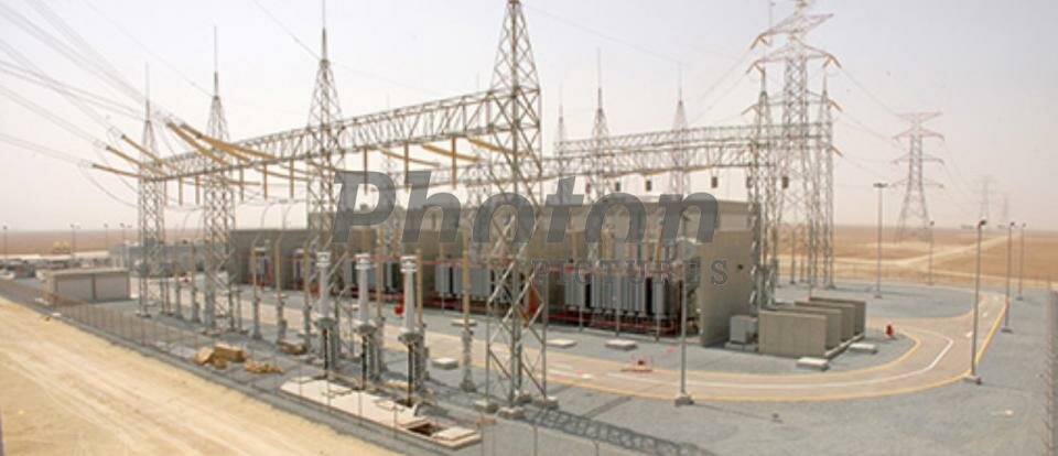

Great assessment. One point not mentioned is many of these schemes offer a 5 minute energy reserve. I’m still puzzling at what this means in the real world. It really doesn’t allow for diversion range, maybe 5km max, and is a major problem for the operator if it lands off the recharging grid. So practical operations will require a high density of landing pads each equipped with tens of Mega Watts, ( Giga Watts if a hub) capacity charging;- just look at electrical grid emerging from a power station to get a feel for the size of such electrical sub stations …. Remember this is in addition to the power demand that’s already installed to power the area.
This is mind bogglingly massive and Uber expensive infrastructure, especially if introduced into existing urban areas. and paid for by who ? It’s in that ridiculously low ticket price, right?
