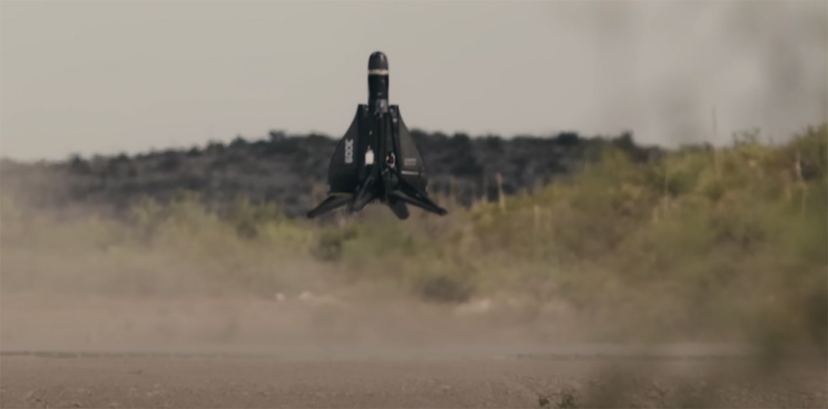

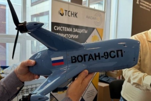

1. Tail sitter EVTOL with gun. (manpack-able) Leveraging electric aircraft's extremely low operating and production costs, VTOL capability and agility while maximizing speed and efficiency. It is hard to imagine another long range projectile or vehicle having significantly lower costs that can defeat such a vehicle.

In general, I think we're going to see EVTOL fighter drones as a thing. Probably ~10lbs payload, just big enough to carry a pair of MP7s or P90s; and their sensor is a wide FOV EO eyeball, maybe even comparable to the F35 DAS. Their targets are FPVs and ATGM-sized loitering munitions. Probably have 1-3 of these per squad of infantry. The wide FOV EO also helps with infantry scouting and situational awareness, but these are intended to be working Air Superiority. The grunts would have smaller drones for recon.
