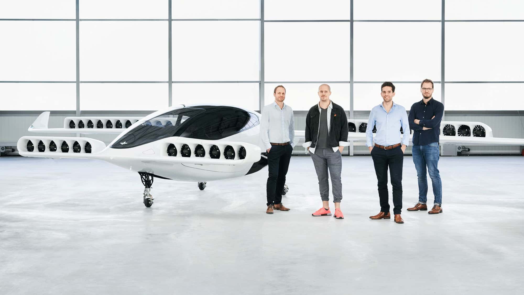

It appears that Joby is the only eVTOL developed so far that has the proven range and noise profile to be a moderate success. In certain markets like California and New York this aircraft could sell well. Joby recently broke a record flying 150 miles on a single charge. Aviation Week once did a profile on the company where Joby claimed that their secret to getting long range is to aggressively focus on getting the weight of the vehicle as low as possible. The problem that I see are companies like Lilium that are expecting battery tech to improve by the time their models get certified. That is a huge red flag. It tells me that they know their aircraft are unable to meet performance targets and they are crossing their fingers that the battery chemistry issue gets drastically improved soon, which many experts have said is unrealistic.
https://evtol.com/news/joby-evtol-aircraft-surpasses-150-miles-flight-test/
https://www.aerokurier.de/elektroflug/lilium-jet-dossier/

For the record, lots of people in the industry think that Joby's 150 mile trip was achieved without pax onboard (obviously) but also the equivalent mass was replaced with a battery in the cabin.
Still very impressive, Joby has done a great job and is at least showing video footage of a fully transitioned vehicle in flight while others flaunt pretty renderings.
