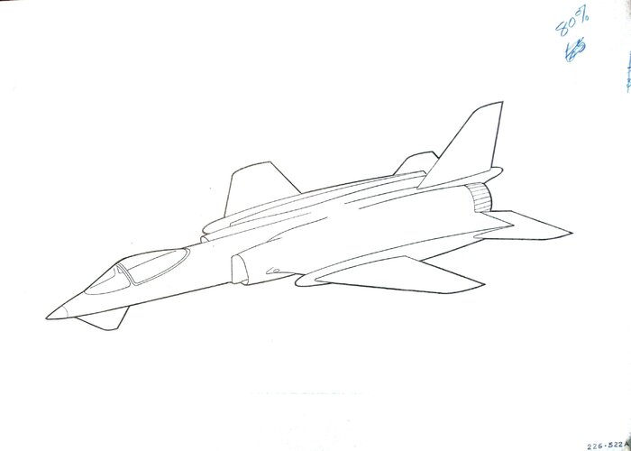

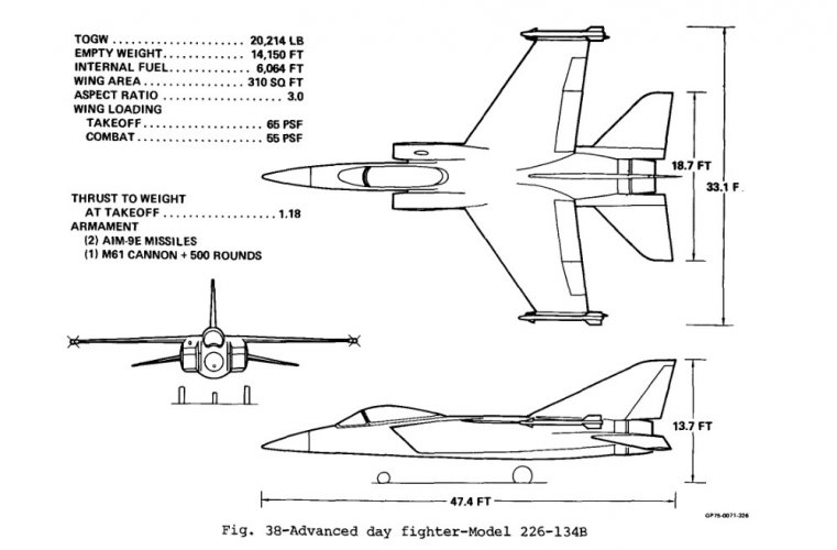

So, as has happened before, I think we are mixing our designation /drawing systems up. Things don't seem to be sequential.
Model 226 is 1968 USAF Advanced Manned Interceptor according to the Project List. First two of our 226 designs match this designation but none of the rest do.
Seems to be a conventional Model 263 VFAX design similar to this:
xd4c-101861-feb-1-73-jpg.82457

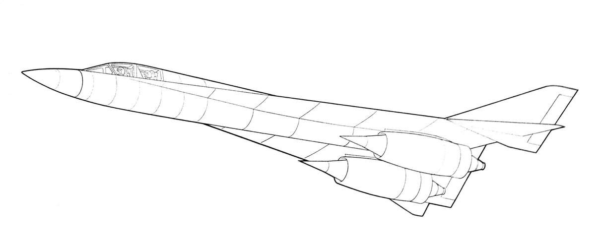

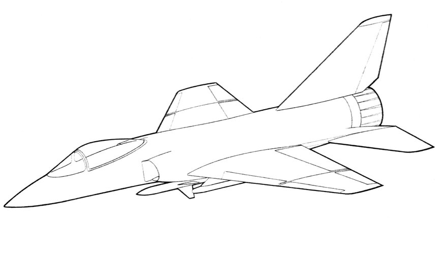

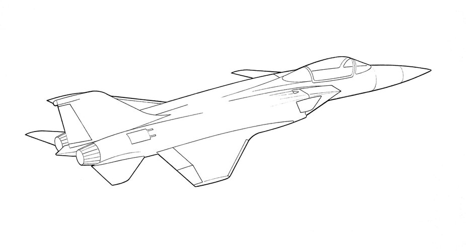

Nos. 6, 24, 26, and 33 all have Vought SAMI-style nozzles, so probably aimed at a similar role. No. 31 has smaller versions of the SAMI nozzles, but I’d question of the power would be enough for the high-mach SAMI job.

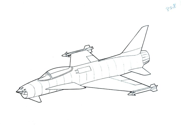

No. 27 is almost definitely for a Quail-type role.
Almost certainly the same article discussed in this thread - they're most likely GE14/16 wrap-around turboramjet used in the 'advanced interceptors'' mentioned in same thread (but in pairs in that case)
The really wide range of designs associated with the same initial three digits start to sound like the first number is more like a design team or office code than a specific requirement. Just a guess, though.
It's certainly not unusual for companies to have a 'project' which exists primarily as a framework to bill the customer for other, smaller projects which wouldn't warrant their own contract.
It's possible that 226 is one such thing; perhaps a contract to carry out concept studies. Given that Quiet Attack was an ONR project, they'd be my initial guess for the Project 226 customer.

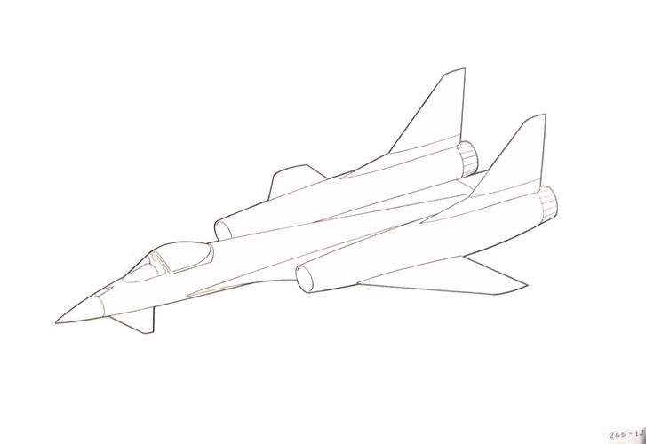

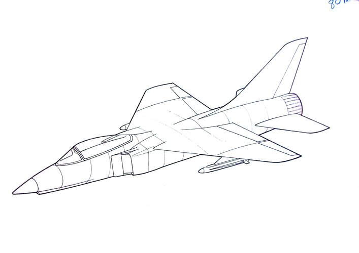

Could "fat" A-4 (No.3) be equipped with two turbofan engines with high bypass ratio?
Just a guess, because I couldn't imagine why A-4 need such type of engines...

Well then in No. 31 we could have at least the airframe designers positing a sub-scale version of that turboramjet.
I think you’re right - the aft fuselage shaping suggests one engine on the port, logic suggests another to starboard.
However, I have to say - the intakes are massive! Are they for a non-standard engine? VTOL? STOL? Or is the payload substantial?

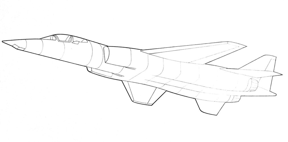

The odd structure that runs from the top of the intakes, behind and parallel to the inner wing, and skirts the cockpit bulge before running all the way to the rear ‘flaps’ is intriguing.
It’s reminiscent of a variable-incidence wing setup, but with the engine intakes included in the structure it would suggest that the whole structure - including the engines - move.
I was going to write “tilt” above, instead of “move” - but given the peculiarities of this design, translation instead of, or mixed with tilting cannot be ruled out.
