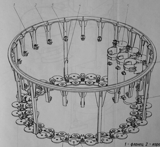

The T-95 and T-14 are equipped with an active protection system and the design of the "carousel" differs from the classic one. I believe it will not be easy to cause significant damage to the "combat squad".

What is wrong with T95 and T14 design? Compare to M1 or Leclerc tank, where ammunition is stored in turret, a penetration of ammunition in T95/T14 will burn the whole fighting compartment, includes the gun, sensors... which are the most expensive components of the vehicle.
The first and foremost priority for armored vehicle is protection of the crew. That's where your armor budget allocated the most. T-95 and later T-14 achieved the "next level" by completely separating the crew from the munitions.
Sensors etc are replaceable element.
While bustle storage makes it very easy to implement blowout panels, a central carousel ala AZ/MZ would be well protected by the thick hull armour in all arcs. The bustle extension also increases turret length, and that sort of constraint is sometimes undesirable.
Design is about managing tradeoffs.

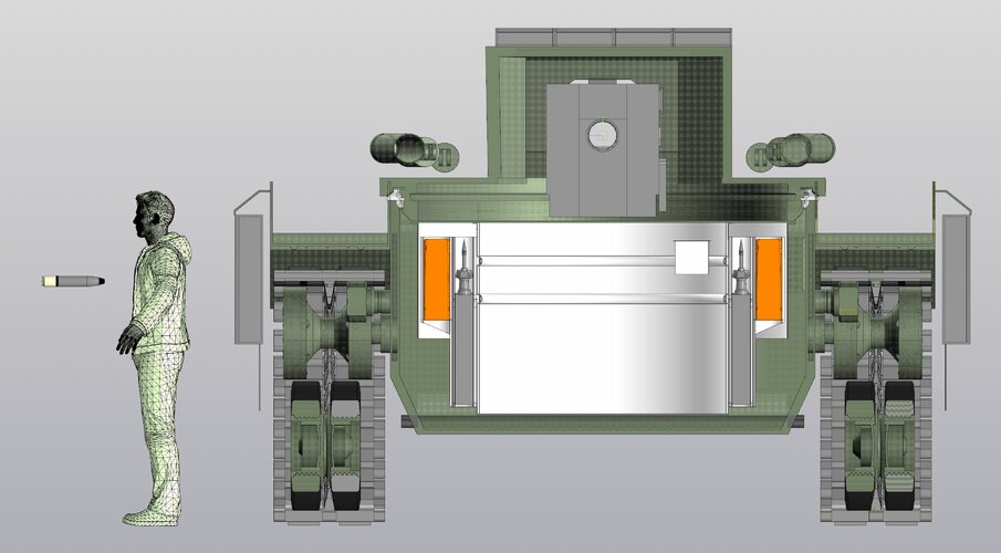

The figure shows the arrival of a 57-mm projectile
First of all, how do you fill inert gas? There is a hole from the barrel inside out with diameter of 125mm. That not consider tradition Russian tanks have a port to eject stud of used round. Gas will leak through barrel or that port
OK, assume somehow you can keep the gas inside compartment, or refill it with like nitrogen, which is cheap every where. The problem is ammunition doesnt need oxygen to explode. This is chemistry. In both propellant and explosive, the energy is stored in the energy material itself. So, even if you store the round under water, if there is heat, shock or anything initiate, the material will burn and explode. You can think it as both the oxidizer and fuel are stored in the explosive itself. The trick to prevent ammunition burning is not inert gas. The British even stores the round in water but that is no help either. The trick is insensitive ammo, but even with them, there is still a chance to burnt.
And, of course you can try to armor the side with 150mm or 200mm steel to protect against autocanon, its possible, but still, there is a fundamental weakness of T14/95 style compartment when ammo is burnt, it will damage the most expensive components of the tanks.
