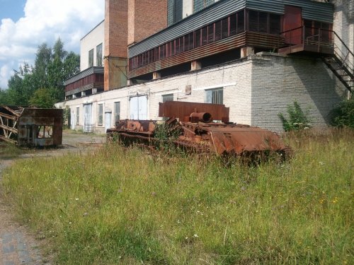

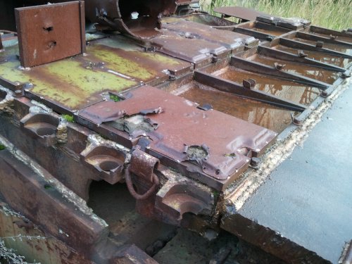

Photo taken from the Bulgarian forum, according to the author obtained from Kharkov.
Link: http://forum.boinaslava.net/showthread.php?13811-%E2%FA%E7%EC%EE%E6%ED%EE-%EB%E8-%E5-%F2%EE%E2%E0/page3

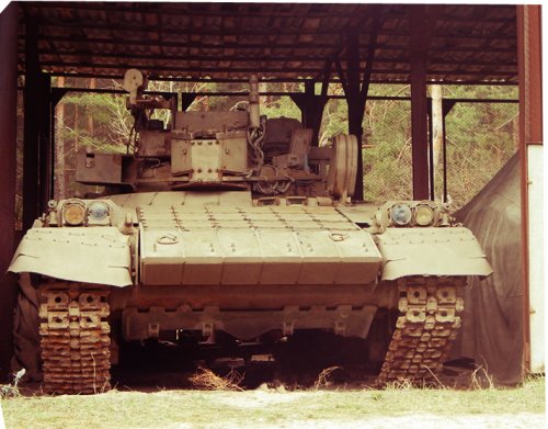

Object 477 'Molot' also known as "Boxer" or FST-2.
Design work of the Object 477 next generation MBT with an unmanned turret began in 1981. Draft design was completed in 1984, technical design in 1985, and the first prototype (mock-up) was constructed in 1987. The vehicles were handed over to Russia, where trials continued through the 1990s. The Argus sight combines LLTV and imaging infrared channels, and a radar system is located on top of the turret. The crew is seated in the hull of the tank. The 152 mm gun with an autoloader can reach a rate of fire of 14 shots per minute. The basic loading module contains 10 rounds, and it can be supplemented by two 12 round modules. The Object 477 represents what was known as FST-2 in the West during the late 1980s/early 1990s.

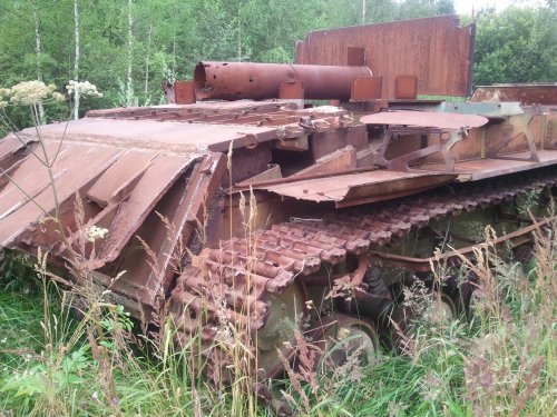

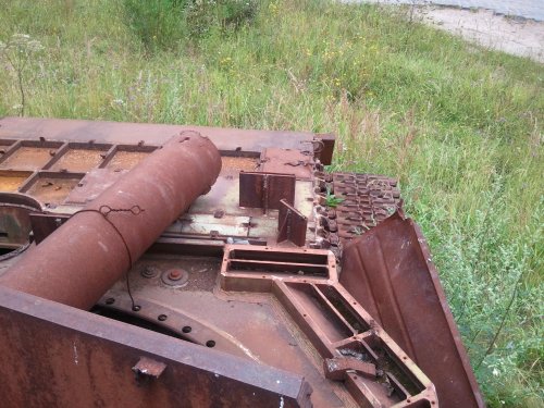

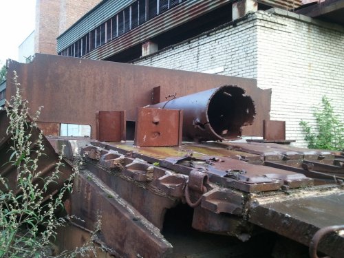

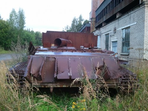

Wow, such poor condition. Hopefully someone restores it. A very interesting prototype tank. (BTW, my first post after 1 year on this forum lol, I was afraid I was not of relevance).

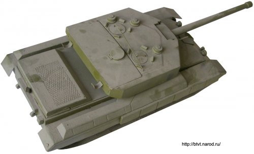

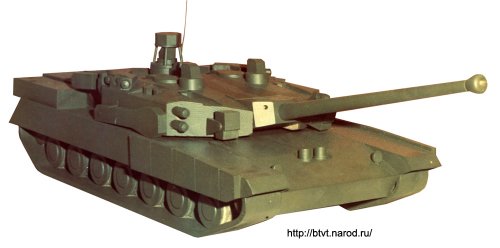

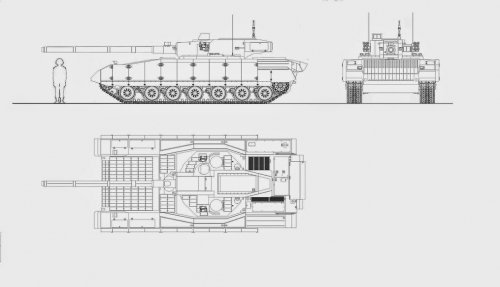

Perhaps the model of the tank "Molot"
http://btvt.narod.ru/raznoe/110/110_2014.htm

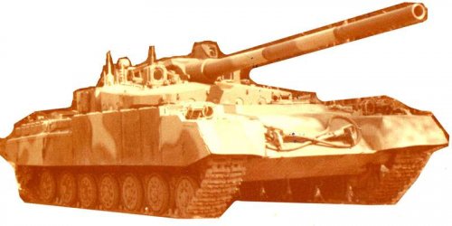

It is not 477 Molot, it is his precursor 490 Buntar (1985 year).

I don't think so. This is supposed to be Buntar (possibly 490A design):
(Posted earlier in thread by youROKer under 'Unknown Kharkov MBT'. Identification via the STURGEONS HOUSE forum.)

No, it is 490 Buntar. It is not Molot (read specialists from Kharkov design bureau Organic from Otvaga forum).
The second wooden model is one of reseach design.

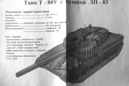

T-80U with a new tank turret with 152 mm gun:

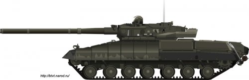

FInally..from Harkonnen a.k.a A Tarasenko.
http://btvt.narod.ru/3/molot.htm
Better descriptions and images.

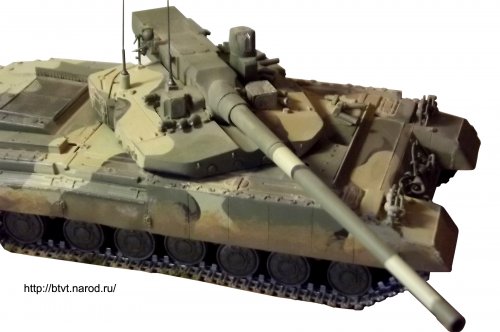

Article translated:
Tanks "Rebel", "boxer", "Hammer"
© A. Tarasenko. BTVT.narod.ru

The product is 490 and 490A "Rebel"

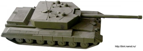

Initially viewed as a promising arrangement of two options: a crew of two people - a product "490" placed in a low-profile turret and a crew of three people - a driver is on the left, the commander of the low-profile turret gunner in the left of the gun - the product "490A."
The product is "490"
The product "4 90 ". Scale model
Option promising tank crew 2 people EA Morozova alleged use of hydro-pneumatic suspension. In addition to solving the basic problem - increasing average speeds due to the improvement in ride it allows you to control clearance of the tank, which increases its permeability, and survivability in combat. In addition, controlled hydropneumatic suspension by changing the trim of the machine increases the corners pointing guns in the vertical plane.
The crew consisted of two people, located in the tower. Traffic control was assumed by means of television stereoscopic television system installed in the bow of the hull.

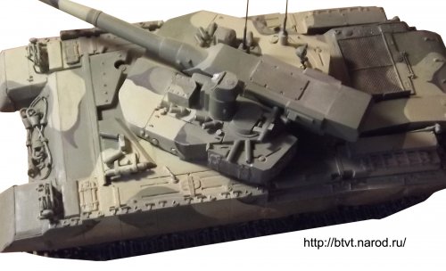

The product "490A" (Rebel)
The product "490A" (Rebel) .
See . Photo threaded layout model - For the 110th anniversary of the birth of Alexander Alexandrovich Morozov )

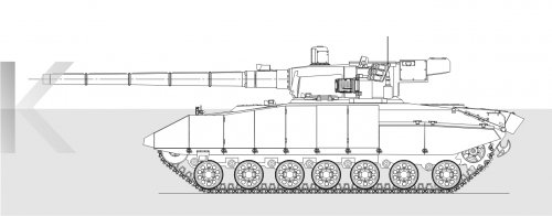

The product "490A" Rebel
The product "490A"
The product "4 90 A "variant VR Kovalyuha
In addition to the main armament tank is equipped with two coaxial machine gun caliber 7.62 and remotely controlled 12.7 mmmachine gun. Commander for surveillance and fire control duplication had panaromichesky sight, gunner day sight placed on the left side of the tower, thermal sight was located on the right side of the gun, the image on the screen gunner transferred remotely. Review of the crew provided with fiber-optic devices, placed around the perimeter of the tower.
Ammunition was placed in isolation on the right side of the crew compartment of the tank. The tank was characterized by a high level of reservation, with a minimum of weakened zones. Reservations sides and roof of the tower - the combined. In 1983 the layout was made ​​a life-size tank for developing the layout and placement of equipment. In 1984, a prototype tank began to pass the test.
29.1.83. There was a wooden mock Kovalyuhom on machines with external gun, gunner and commander sitting next. He sat inside and felt that the option arrangement, apparently out.

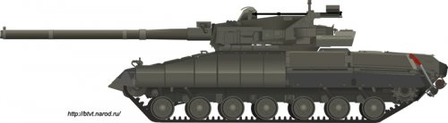

In 1985, it approved a new layout of the tank with 152 mmgun. The driver of a tank located on the left, to the right of the fuel tank was located engineered partitioned. The commander and gunner were placed in the body of the tank under the tower and had direct eye contact with each other. The design of automatic loader had a loop at the rear of the crew compartment, replenishment of ammunition is isolated from the compartment located between the motor and gear and crew compartment.
We had the opportunity gunner manual override guidance weapons and turret. Multichannel gunner's sight imagined visual, thermal imaging, television channel, guided weapons and guided laser rangefinder and automatic tracking system. There was an auxiliary hinge sight. Workplace commander was equipped with panaramicheskim sight. In the center of the crew compartment housed TIUS remote control, access to which was the commander and gunner.
Left BTS 152 mm caliber in comparison with the BTS 125 mm caliber
Left BPS separate loading gauge 152 mm versus BTS caliber 125 mm
Throughout the period of discount on future tanks have been constant problems and delays associated with the development and supply of components, primarily related to the lag of the USSR in the field of thermal imaging and computers. In 1986, CDB CMH offered to install on the tank, as a temporary solution developed for the production of tanks thermal sight "Agave-2", the offer CB refused. In 1987, the first prototype was assembled tank without sighting system and automatic loader. In 1988 reliable operation of the automatic loader in the tank to achieve still failed, despite the fact that the machine was working at the stand in the tank with him there were problems. Despite this show of high management (Defense Minister Yazov, ministers Defense Ministry, Ministry of Radio Industry, Mintyazhmasha, Minmasha, Ivanovo, Shabanov, Galkin, Bazhenov, Gerasimov, Zakharov, representatives of the Central Committee of the CPSU), the first sample of the tank was successful - the machine showed a surprisingly high rate (63 km / h). I fired, as well.
The tank's armament consisted of 152 mm 2A73 gun, coaxial machine gun caliber 7.62 (In the original version 2 machine guns), anti-aircraft machine guns 12.7 mm. Subsequently installed automatic gun caliber 23 and later30 mm. The tank was equipped with a device for automatic metering of thermal bend of the barrel in the planes HV and GBV.

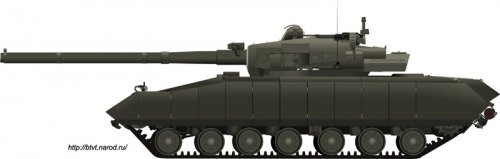

The tank looked very impressive in comparison with the mass-produced cars. Since the height of the line of fire from the product "477" was2088 mm, The T-64 - 1630 mm. The length of the tank with the gun forward was10650 mm, The T-64 - 9225 mm. The height of the roof of the tower -2434 mm, The T-64 2170 mm.

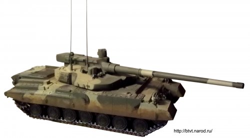

The product is "477" (Boxer). An early version
The layout of the fuel, ammunition and crew products "477"

To increase the firepower to destroy ground and air targets tank was in addition to the main armament automatic gun. Guidance and Stabilization gun vertically independent, horizontally - along with the tower. It changed accommodation coaxial machine gun, crew accommodation inspection devices and so on. Use152 mm the imposition of a gun, on the one hand, reduced the profile of the tower and reduce the reserved space on the other, it eventually had to close from outside influences armored jacket and she became poluvynesennoy received outside the reservation.
Having layout with external gun in the world tank manufacturing has never been done, developers are faced with a very serious problem. At first, she was placed on the roof of the tower in a small box. The first sample was made showed that the tank to be operated with a gun is impossible. Marked gun not protected not only from the shells, but also of everything that gets in the tank - water, mud, twigs, stones. In addition, when loading offers access to the inside of the machine and everything fell into bed falls inside. The problem, apparently, and simple, but it could not solve. As a result, over the fact that the gun booked and appeared on the tower casing, which increased the weight of the machine and overlaps the field of view of the impact of the complex. This is especially touched panorama, had significantly increased its periskopichnost.
Adoption of technical solutions on the tank allow to achieve a significant lead over the current generation of machines. At the same time, chasing the maximum specifications of firepower and protection, thus surpassing even the requirements Genzakazchika had to sacrifice the weight of the machine, which has reached a critical point and forced to do some nodes from titanium. Thus titanium produces equipment for the entrenchment, cover containers dynamic protection units and a number of other elements. All technical problems were encountered and solved gradually they left, but it took time, sometimes very significant. Design and development testing continued in the 89-90 year, in 1992, planned state tests of an experimental batch of machines. Even before the completion of the GOP customer demanded manufacturing of an experimental batch of 50 machines. But in the end the tank was brought in a very bad time of the collapse of the USSR, when the priority was the survival of enterprises, rather than expensive long-term development.
Hammer 477 product tank Hammer Tank deposited in the UPI
(Photo: Internet)
Produced more than 10 samples. lay the groundwork for the manufacture of pre-production party. The tanks are stored on the test base KMDB (RLE). Also, a few samples are in the territory of the Russian Federation. It is likely that the demonstration in the Russian tanks "Armata" renewed interest in the future tanks KMDB both the country's developer, as a variant of a joint project with foreign customers.
The development in the post-Soviet period (Note)
477 tank with a new automatic loader on the basis of sets of running gear ed. "434"
Option tank 477, has received a new automatic loader on the basis of sets of running gear ed. "434" release1993.
Changed as armor protection of the tower, and the frontal part of the hull sides, set protection branch caterpillar front. Protection modules turret and hull are made of titanium.
In the tank there were two "highlights" - poluvynesennaya 152 mm and gun control system. What was included in the prospective tank , at the time , had no analogues in any tank in the world. Much has not been implemented to this day. Starting from the impact of the complex with all kinds of control channels and ending with onboard computing system, satellite navigation, SAR, state identification system, motion control systems and tank fire by radio. Also conducted testing of MSA with the television channel with the automatic capture and target tracking and laser channel CO 2 for targeting missiles with semi-active homing and radar detection and capture targets. Experimental samples of radar checked on the tank (RFCs "Arguzin" Institute of Signal). The results were initially disappointing, the underlying surface distort the signal , and even a moving target is difficult to be detected on the ground.

The development of the tank 477, received after the collapse of the Soviet Union in Ukraine marking note continued. There were manufactured prototypes of the tank on the basis of sets of running gear ed. "434" and "219". Work on the new tank were before the 2000s, together with the Russian Federation.
Prospective tank developed with the involvement of enterprises of the former USSR. So 2A73 cannon and ammunition for it developed and manufactured in Russia, so the implementation of the project within the framework of lack of funding Armed Forces on the territory of Ukraine at the moment, without the involvement of external sources is difficult, although attempts to establish152 mmgun Kiev CB-A and implemented. A number of realized for ed. 477 and its variants of elements, including TIUS have been introduced in the tank "Hold."
Produced two sample elements based suspension ed. 434 and 219
Alternatives
As part of the new tank, there are two directions, one of which (VR Kovalyuh) provided for the establishment of the tank on the basis of traditional technologies in tank.
Other (AV Bershov) provided for the establishment of the tank with electromechanical transmission and electromagnetic cannon. Mechanical transmission branch was designed AA Sakun (KMDB. Morozov), electrical branch (electric unit) - VI Trofimenko MEI Moscow.
"Highlight" of the tank was the electric unit, which allowed "almost instantly" switch from motor mode into generator mode, transforming the kinetic energy into electrical energy and the tank, creating a short-term double engine power to make a shot. The cooling system developed for electrical installation Kiev Institute of Thermal Technology. By the end of 1990, the technical project was completed EMT. As a manufacturer has been selected Moscow plant "Bolshevik." The collapse of the Soviet Union (August1991.) Put a final "cross" on the draft of the tank with EMT.

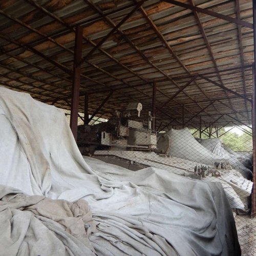

Memories of one embodiment of a test tank (1998-2000.)
... GABTU, GKOT Academy BTV, industrial research institutes and other key players from all over the USSR ... just developed the concept of the Hammer. Yes, the idea was Kharkov, but taking into account the implementation of GABTU, GKOT Academy BTV, industrial research institutes and other key stakeholders. So it is not necessary to show all of himself in the role of Ivan, not mindful of kinship. This whiff " dermokratizmom " .
I was last in the KMDB in December 2000. During the period 1998-2000 gg I once sat in the car, guided weapons. In December 2000 Hammer slelat few dozen shots. It was a living machine, I did feel.
... Moving away 200 meters from the metro station, you find yourself in a world that is completely separated from our reality. Here, everything is subject to the same strict rhythm - to issue "on the mountain" another sample of the armored vehicles.
Wide communicating evidence of numerous working personnel of the enterprise. Vigilant watchman for a long time to collate your "face" on the pass of the original. Finding no special differences, supportive nod permits to follow the entrance of the plant.
If you know where to go, it is not very long for straying factory lanes, you finally can get closer to one of the internal structures, commonly called "experimental assembly." Again another "VOHR" vigilantly watching the so-called "inner passage", looking at it the right stamp, allowing you to go to the shop.
And here you are in the holy of holies KMDB - in the shop pilot assembly. Since the tank without arms - it's just "peacefully tractor plowing the land", the first pass in the mining sector of the device, which features a tank on the tractor. It is called the "MZ" - ie, loading mechanism.
Load in the real dimensions of the tank roll bar opens all the stuffing "peacefully plowing tractor." We climb the stairs to the level of his body and try to dip into the driver's hatch, located on the axis of the machine. It is not strange, but it is in its place, you can witness and feel the force of arms firepower. Triplex, pedals, controls - all normal. For those who saw the tank "is not in the picture", will be a new presence on the sides of the workplace of the driver a couple of "revolving" drums is clearly not in the caliber 7.62 mm. On the entire length of the driver's compartment stretches the main boeukladki (BU) of the tank. Smart systems are distinguished, when and where was the owner of this type of ammunition. From the shoulder "fur-water" to the spinning reels - no more150 mm. Modestly but with taste - in the tank is not too much space. These "revolver" is the main tank ammunition. A reasonable question - "Where is all this deetsya"?

PaulMM (Overscan) said:
Object 477 Bokser / Molot images. Finally, its the FST-2 :) According to the article the name change came after a security leak.
is there any more descript on img 015 ie engine vs ammo vs crew etc. ?

Avimimus said:
It'd also be interesting to find out the tonnage of 'Rebel'.
According to the quotes by author of the article at Russian forums: Buntar under 60 tons, Boxer/Molot 52-55 tons, Nota 61-62 tons.

LVisingr said:
is there open crew escape space out the rear of the tank next the engine compartment vice img015 above?

jsport said:
LVisingr said:
No, there is ammunition storage.

LVisingr said:
jsport said:
LVisingr said:
thank you
