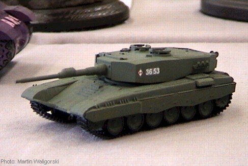

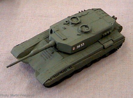

A Swedish modeler named Björn Bäcklund ( https://baecklund.eu/scalemodels/ex72/modern.html ) created this 1:72 scale model of a hybrid Polish main battle tank combining the hull of a T-72 with the turret of a Leopard 2.
T-72 Hull with Leopard 2 Turret (1).jpg T-72 Hull with Leopard 2 Turret (2).jpg
Bäcklund created the model back when Poland had recently joined NATO in 1999. As explained by Bäcklund, Poland faced the challenge of conforming to NATO standards while possessing a large Cold War era stock of Soviet military equipment such as the T-72. Bäcklund claimed that one option that was considered was to rebuild the T-72s with old Leopard 2 turrets. He also claimed that he had seen a sketch of the T-72 with the Leopard 2 turret. Ultimately, Poland decided to acquire 128 Leopard 2A4 tanks from German army stocks in 2002 and ordered a further 119 ex-German Leopard 2s in 2013.

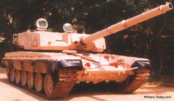

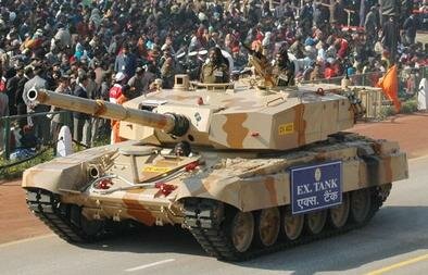

The closest real-life equivalent could be India’s MBT-EX / Tank Ex / Karna prototype main battle tank designed by Defence Research and Development Organisation or DRDO.
The MBT-EX / Tank Ex / Karna MBT combined the hull of the imported T-72 with the turret and 120-mm rifled tank gun of the domestic Arjun MBT. It underwent six months of trials, but was subsequently rejected by the Indian Army. A total of eight prototypes were built.

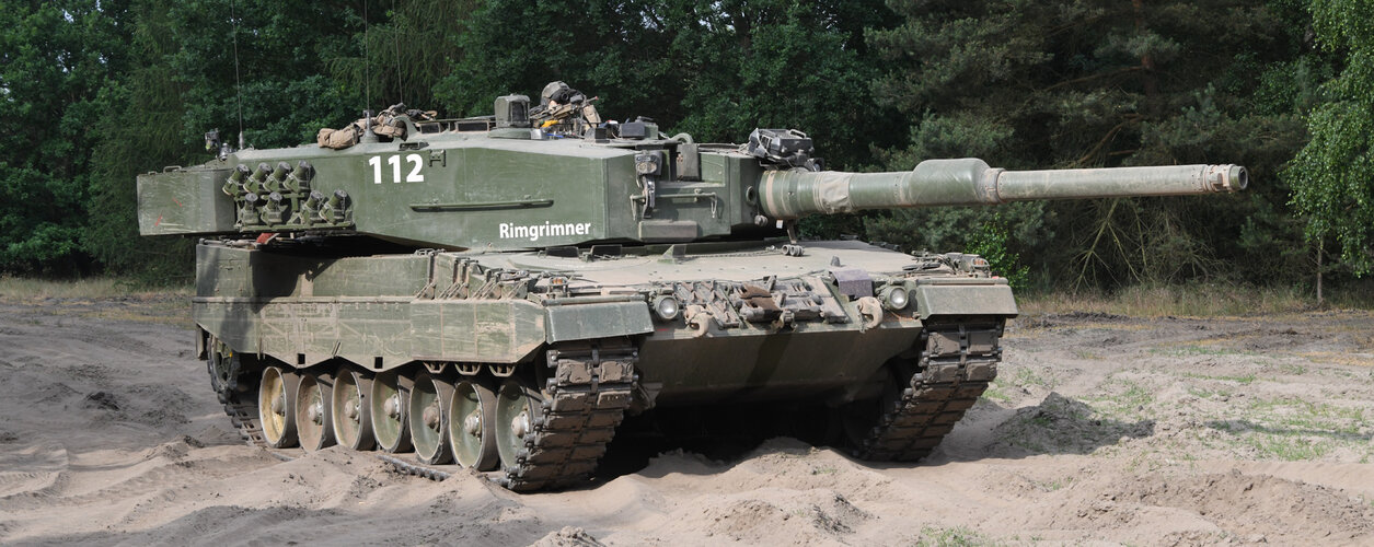

Interestingly, the Arjun MBT shares a similar layout to the Leopard 2.

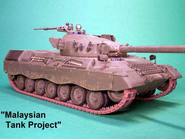

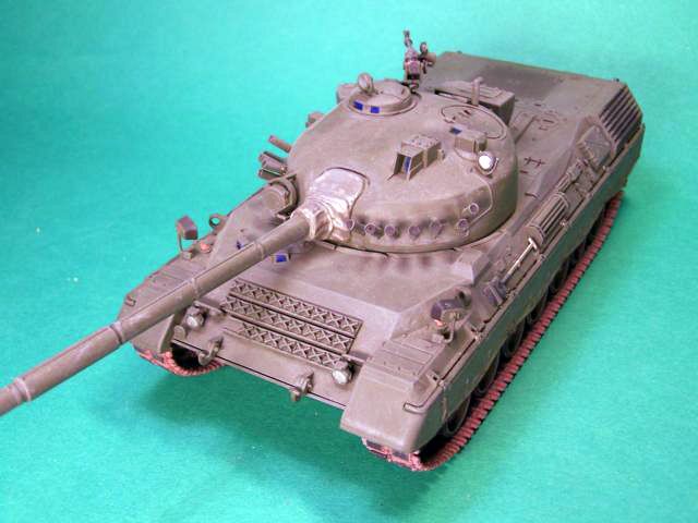

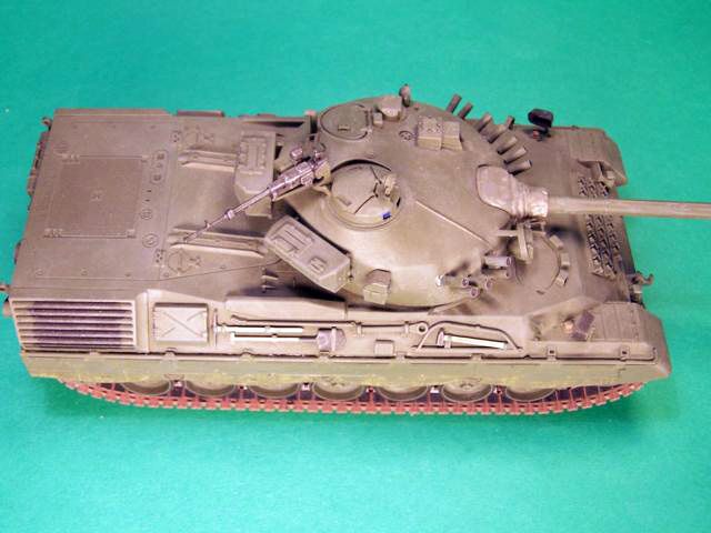

It was actually a Leopard 1 hull with a T-72 hull looked at in Malaysia that I was thinking about. Which makes more sense as it is an increase in firepower.
I think you mean Leopard 1 hull with T-72 turret:

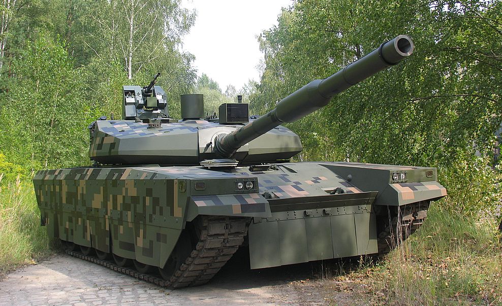

Something along the lines of this was the Polish Bumar PT-16 which essentially an upgraded version of the PT-91/T-72 hull fitted with a new welded turret, which is armed with a 120 mm smoothbore gun:
That article makes vague reference to a bustle-mounted, auto-loader.
We wonder how closely the Polish PT-16 resembles the bustle-mounted auto-loader on the Ukrainian T-84M Orlot conversion.
Do either the Polish or Ukrainian conversions include blast-proof doors ala. M1 Abrams?

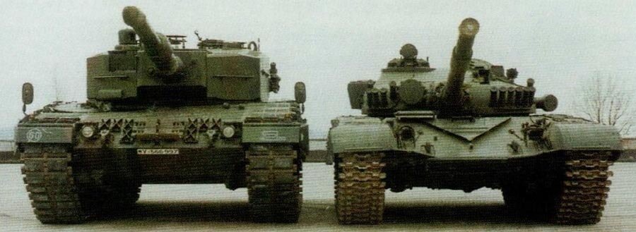

... is it actually possible to fit the Leopard 2's turret onto the T-72's hull? ...
I don't see why not. The T-72 has a larger turret ring diameter would dictate a spacer of some kind. Compared to the Leopard 2, a T-72 hull may be slightly shallower (with almost half of that depth taken up by the now-redundant ammunition carousel).
The resulting hybrid would be a bit taller and heavier than the original T-72. On the upside, increased gun depression would make the hybrid better-suited to hull defilade positions. On the downside, top speed performance would probably suffer and you end up with a lot of turret for a relatively small vehicle.

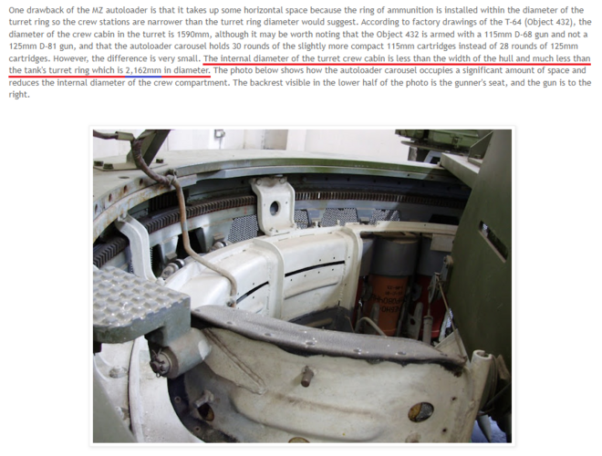

I'm getting conflicting figures on the true dimensions of the T-72's turret ring diameter. Some online sources such as Tankograd (https://thesovietarmourblog.blogspot.com/2015/05/t-72-soviet-progeny.html) state that the T-72's turret ring diameter is 1934mm, while other sources such as Garupan History on Facebook ( View: https://hi-in.facebook.com/NeedRaifuWaifu/posts/582609057005943/
) claim that it's actually 2162mm. Why are there so many discrepancies on the actual turret ring diameter of the T-72?
Probably the difference between clear space inside the turret, and the depth of the bearing surface. 200mm or 4 inches, split in 2, so 100mm on each side of the circle, all the way round.
... Why are there so many discrepancies on the actual turret ring diameter of the T-72?
That 1,934 mm measures the internal diameter opening Other measurements are for external diameter (2,275 mm), bearing race (2,116 mm), etc. Why is there no standardized method of measuring turret rings? No clue ...
There is no standardized anything for military hardware, it's the same way nobody actually states sprocket hp for tanks when it makes a lot more sense than the gross hp value.
Well the engineers will be wanting the 2 mechanical faces to match up. The human factors guys will be interested in the free space to work with. The transport guys will want the outer dimensions, to make sure it will fit through a railway tunnel.......
