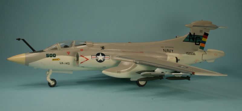

USN decides to buy The Blackburn Buccaneer....
bobtdwarf
3 January 2020
590
1,029
Have read that some MDAP money went into the program and that the USN had expressed "a mild interest" in the type. So lets just amp that up to buying it. This will probably kill the A-6 program, though it may have been far enough long that some prototypes may have been built.. not sure about the timelines of both aircraft off the top of my head at the moment.
It would be a decent way of enhancing the alliance, propping up the British economy a wee bit and it might even spur some innovation domestically by mixing things up a little.
So what is this bird going to look like? How do we think it will fair in Vietnam?
