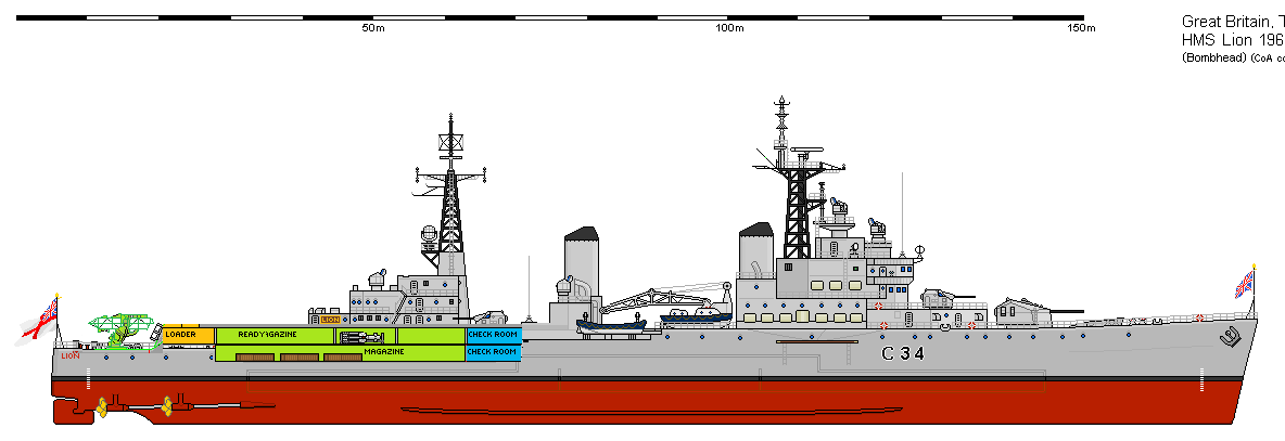

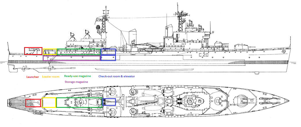

Well, it depend heavily on how exactly it would be arranged. The "County"-class "long lane" type magazine arrangement was essentially dictated by two specific demands:
* That missiles could be moved and loaded manually, in case of electrical failure - therefore the horizontal arrangement with the missiles stored one after another in line
* That there would not be single point of massive detonation in case of ship being hit - therefore the very long magazine, where explosion of one missile would not cause cascade explosions
The result was a "long lane" magazine:
Now, in case of Tiger-class:
I suppose, that if we arrange the magazine system a bit differently - if we put long-storage magazine under the ready-use magazine, with two-tier check room serving also as elevator room for moving missiles from one tier to another - we could just squeeze the whole arrangement inside the superstructure, between launcher on ship's stern and rear funnel. It wouldn't be the best solution, of course, but it would be as close to existing design for County as possible.
Alternatively, a Gridle Ness-type multi-tier magazine could be used; it would trade length for height.
Dilandu
From the profile diagrams I have of the internal layout of Tiger, it appears that your lower blue check room will encroach on the after boiler room and the funnel uptakes.
While the boilers in the forward boiler room were placed side by side, that in the after boiler room were were in line on the ship's centreline. The boiler room itself extends all the way up quarterdeck level and the after bulkhead is around the aerial you have between the aft funnel & the 3" gunhouse.
Thank you for the data! The magazine for Tiger must be made shorter, then. Something like such:

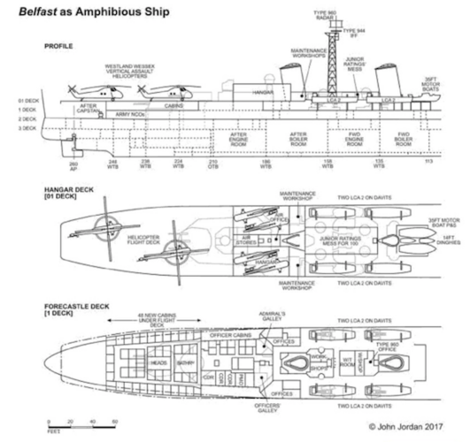

However in late 1961 there was a proposal to convert Belfast as an amphibious transport & landing ship. This would have involved
1. removal of X & Y turrets and as much of the after superstructure as could be undertaken in a 6 month conversion period.
2. Creation of a flight deck 160ft long with 2 spots for Wessex sized helicopters.
3. 2 hangars replacing the after superstructure, 40mm guns etc (2 required due to angle of after funnel splitting the area) these would accomodate 4 Wessex.
4. space under the flight deck used for troop accomodation (requirement was for 2 companies c260 personnel)
5. replacement of the 4" guns with 4 LCA. in davits.

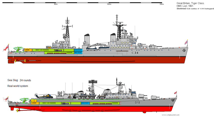

So I decided to experiment with "minimal" reconstruction; the rear 6-inch DP turret got removed (thus freeing about 160 tons of upper weight) and a "County"-like Seaslug system is fitted inside rear superstructure and deck below it.
* The whole missile system setup basically adopted from "County"-class as much as possible
* The major difference is, that storage magazine is placed below the ready-use magazine, with communication through elevator in check-out room (and maybe auxilary elevator in loader room - for redundance)
* The ready-use magazine is "two-lane" type, with missiles stored in line, behind each other
* The check-out room is squeezed between rear 3-inch mounts, which probably would made possible only one missile being checked in time (on the other hand, we have level below, so it stand to reason that two missiles actually could be readied)
* The total missile ammo supply could probably be increased about 50-100% in compairson with "County"-class (i.e. 36-to-48 missiles, with 12 in ready use magazine and the rest in storage magazine)
* Two Type 901 radars are installed on rear superstructure (albeit I think that Royal Navy actually favored two-ends radar arrangement, so one radar may be set on forward superstructure)
* All three 3-inch mounts are retained

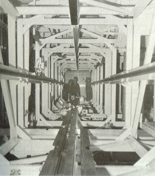

No contradiction in my view. I think there might be some misunderstanding about how the ammunition for these guns was delivered from magazine to breech. Unlike the twin 6" Mk.26 it was not directly from magazine to breech. This description is from the Navweaps site with my emphasis.
"There are two endless chain hoists on the non-rotating structure which each supply 25 rounds per minute. Each hoist feeds two ready-ammunition hoppers that rotate with the guns. The ammunition is loaded by hand into four hoppers and from these are passed automatically to continuously rotating feed rings, hoists and conveyors up to the loading tray where it is pushed into the breech by means of a spring rammer."
http://navweaps.com/Weapons/WNBR_3-70_mk6.php
Note the location of the hoist relative to the hoppers in the diagram.
So it is a three stage process.
1. Hoist from magazine to under deck handling room / gun bay
2. Transfer by hand from hoist to hoppers within the gun bay.
3. Automatic transfer from hoppers to another set of hoists and conveyers that transfer the the ammunition from the gun bay to the gun breech.
So there is in fact no need for the turret and guns to be positioned directly above the magazines IF you are prepared to accept some horizontal movement of ammunition within step 2. But that necessitates the hoist from magazine emerging outwith the gun bay itself. Looking at the post war cruiser designs on p296-297 of Friedman, angled hoists from 3in magazine to emerge in the gun bays would not work as they would intrude on the machinery spaces.

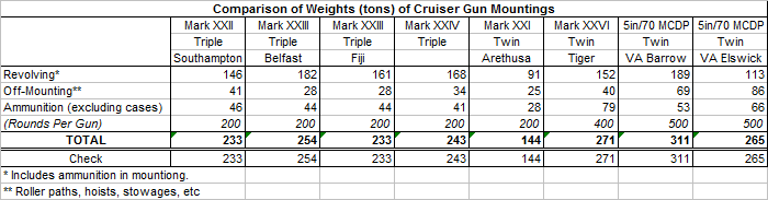

The Tiger class made use of the existing magazine arrangements from the Fiji class. Q1 was fed from that part of the ship occupied by the earlier magazine for B turret. Q2 & Q3 utilised the earlier 4in magazine that was located between the after boiler room and after engine room. In all cases there were two hoists that ran from magazine to the gun bay directly under each turret.
Having to transfer the ammunition horizontally of course complicates things but is similar to what happened with the Towns. With them Groups 1 & 2 placed the 4in magazine aft of the after engine room meaning ammunition needed transferred forward to all the 4in mounts. In the Belfasts the 4in magazine was, as discussed earlier, forward of the forward boiler room raising the need for horizontal transfer aft to all mounts. So manual handling like this was not unknown to the RN.
In essence this manual stage is the same as used by the USN for its twin 5in/38 mounts.

From Page 64 of my copy of "The Postwar Naval Revolution" by Norman Friedman.
I can't get into the Naval Weapons website.
Does anyone have the weights for the twin 3in Mk 6 mounting?​
