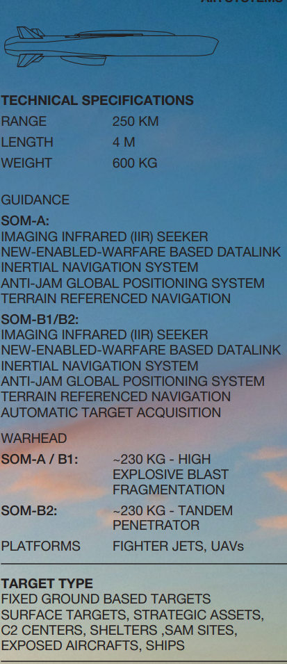

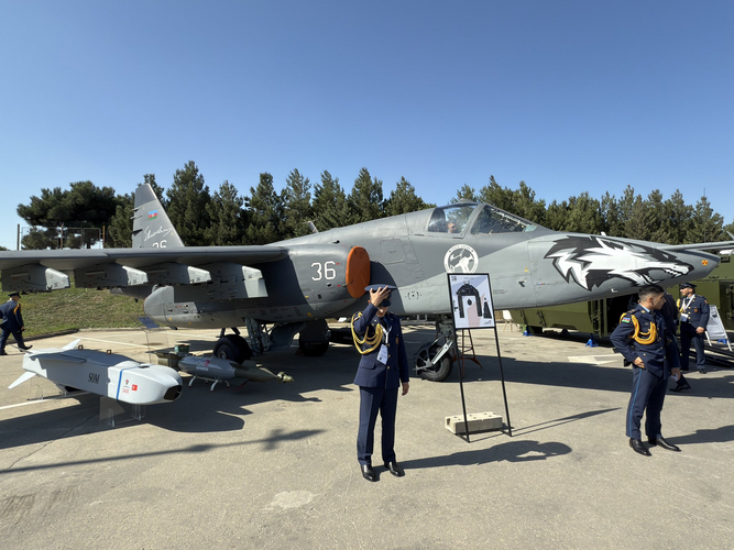

Azerbaijans SU-25M underwent weapons systems modernisation in Turkey, seen in the image below carrying KGK-82 wing assisted glide bombs
A more comprehensive modernisation then I first thought it would be. SOM SAHIN (HAWK), a new variant of the SOM cruise missile developed specifically for Azerbaijan ?
Apparently so.A more comprehensive modernisation then I first thought it would be. SOM SAHIN (HAWK), a new variant of the SOM cruise missile developed specifically for Azerbaijan ?

Please, can you provide a link to the source? Thank you."A successful SOM-B1 launch was carried out from an Azerbaijani Su-25 aircraft using Aircraft Independent Launch System (UBAS) developed by TÜBİTAK SAGE."
Tubitak Annual Report 2024 - Page 112Please, can you provide a link to the source? Thank you.
