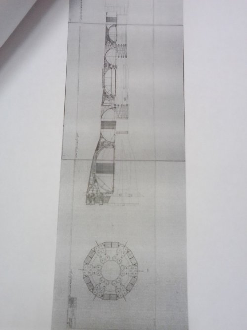

it seems they study to use N1 hardware like tanks, but with new engines, after Cancelation of N1 program

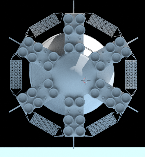

Based on the new graphics released, I have tried to make a quick 3d model of the N1M. A few details are speculative (notably, the greebles on the fairing are simply based on the flown N1), but it should be reasonably accurate to the drawings. When the launchpad graphic disagreed with the detailed drawing I preferred to follow the latter, being more detailed; however, the fairing shape was taken from the former. 1764954460811.png
Some notes on each stage:
Blok A:
- the most obvious feature is certainly the 6, massive engine blocks, each housing 6 NK-15 engines. They are entirely structural, not tanks; the propellant is stored in the tanks at the center of the stage, which are the same spheres on N1's Blok A stretched with some cylindrical sections. These engine blocks instead house the propellant lines and presumably the hardware related to the fins and grid fins.
- the roll control engines appear to have been moved below the vehicle, between the inner and middle pair of engines. They are 12, versus 6 on the N1; note that these graphics are from May 1969, just before the second flight, which means before the extensive upgrade received after they were not able to control the vehicle on the third flight.
- the grid fins are 6, large, and attached laterally to each of the engine block. This very unique arrangement means they can't control roll, which is perhaps why a fin made an appearance on each engine block?
Blok B:
- The oxidizer tank is the same sphere as N1's Blok B stretched with some cylindrical sections. The propellant tank, however, is a wholly new lenticular structure that make sthe stage essentially cylindrical.
Blok M:
- Replacing Blok V, it's a hydrogen oxygen stage with a hanging LOX tank. A curious stage, but not much to say that can't be seen at first glance.
Fairing:
- No escape tower (see the launchpad graphic posted earlier)? Was it, perhaps, meant to fly an LKM (1969 version) dual-launch mission with N1 carrying the lander with the crew, and N1M carrying the injection stage? Anatoly Zak mentions it in reference to L3M at least, but I do not have access to the subscriber section of russianspaceweb
