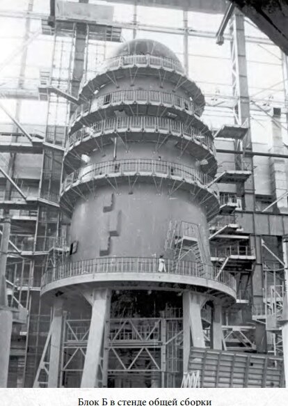

That must have been something to see them tip THAT beast to vertical.
