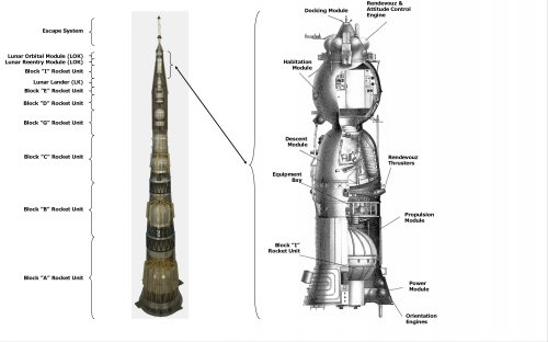

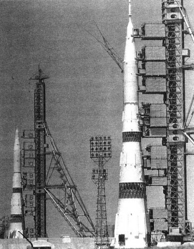

I have read conflicting information concerning the Soviet N1 rocket. Some sources say that the 30 engine design of the first stage was fatally flawed and the complex piping was damaged during rail transport to Baikonur. But then another source says that Nikolai Kuznetsov continued to work to perfect the engine design and the revised engine was known as the NK-33, replacing the NK-15, in the first stage and the NK-43 replaced the NK-15V in the second stage. The rocked with the updated engines was known as the N1F.
If the Soviet Union's lunar program was in the hands of someone with more charisma and political astuteness than Vasily Mishin and Soviet industry was behind the N1, could the N1 have been made to work and cosmonauts could have actually walked on the moon? Or was the design fatally flawed from a technical perspective and if the Soviets were going to the moon they would require a different launch vehicle? Such as Chelomei's UR-700 or Glushko's Vulkan?
I understand that development of the N1 was officially abandoned in 1976. For the sake of this discussion, can we ignore the whose first to the moon rationale for a manned landing on the moon and the political squabbles that derailed the project. My question is more could the rocket have been made to work technically.

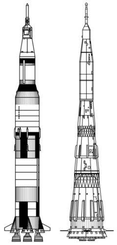

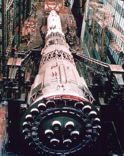

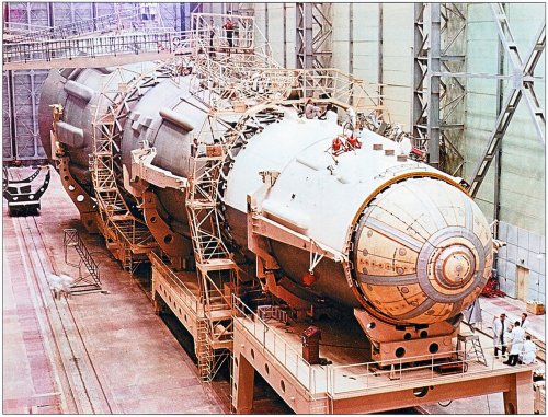

As I recall each of the 4 failures were due to different causes. That suggests poor quality control more than anything.

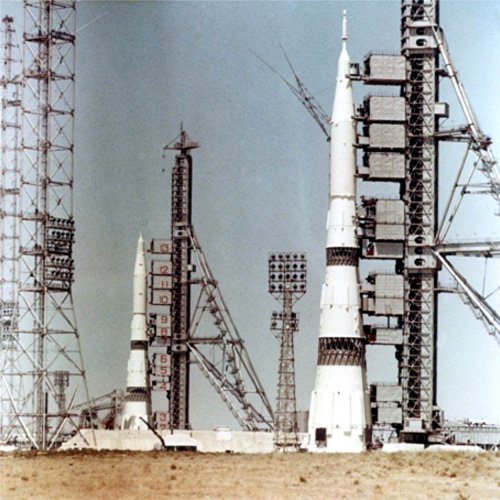

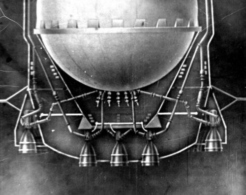

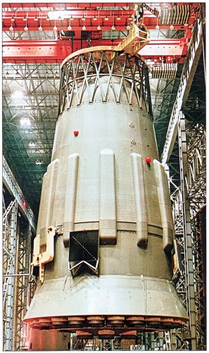

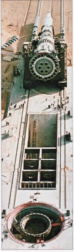

Some nice photos of the rocket
