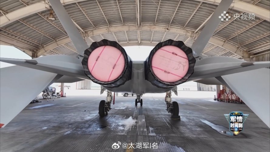

Btw 127 kN seems quite a lot for an engine of this size.
Given the F414 EPE is nearly two decades old it's probably not impossible.Considering that we have only the most basic notion of what "this size" actually is, not necessarily. I mean, fundamentally we only know that it's supposed to be in the same general ball park of the EJ200, F414 and RD-33 and their enhanced derivatives. That's a 10+% spread in dry weight already - going from 120 to 127kN is a mere 6% step.
Taking the 810mm fan diameter of the F414 as the basis and assuming the Chinese engine runs on the same cycle, getting to 127kN from 120 requires a size increase of less than one inch...

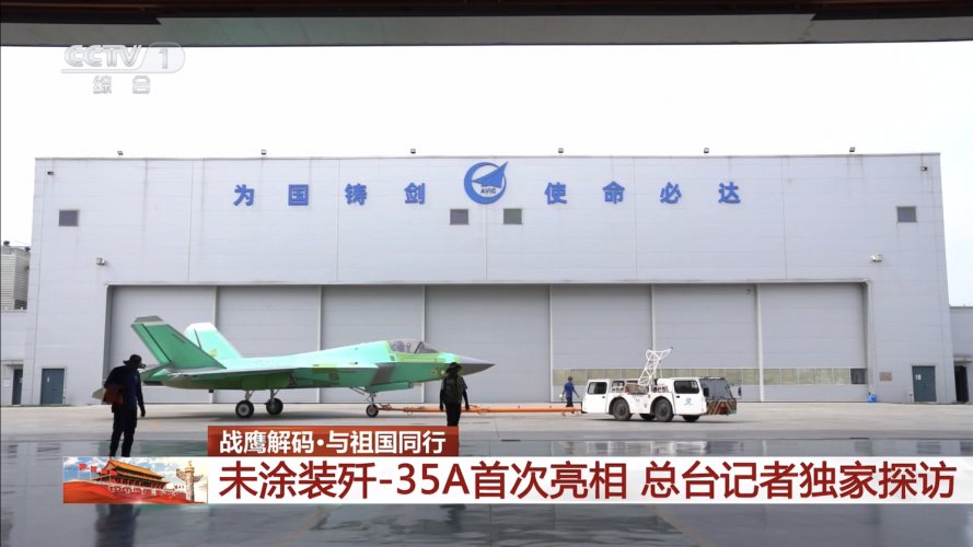

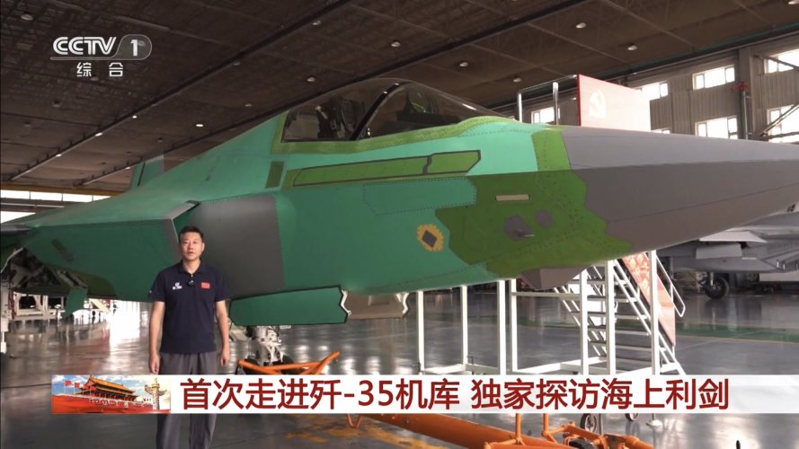

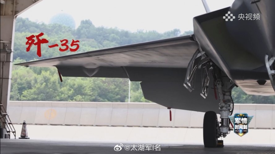

I don't think Sferrin tried to put some backhanded implications as much as just pointing out that an F-35 operating with obvious GSEs has a ladder too. Unless someone can infer from a basic front view that a slide out ladder is any proof that a bird is the specific carrier variant.

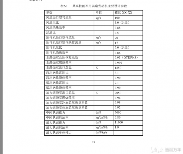

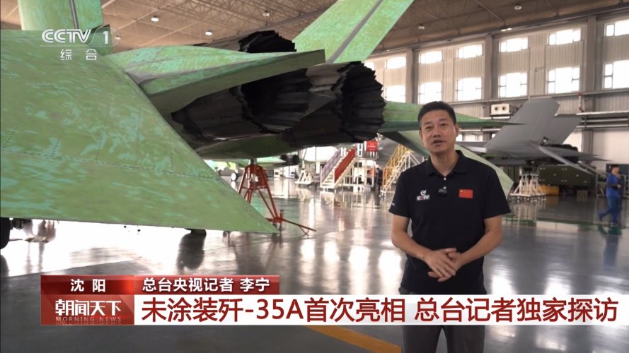

I see WS-15 being designed to fit in the same size envelope as WS-10 and AL-31. Do you have any info on the bypass ratio of WS-15. Is it 0.5ish like most fighter engines, or is it much lower like F119, which is a supercruise optimized engine?Could it be that the inconsistent semantics caused by AI translation made me seem to be overstating things? However, I believe it won't be long before China draws close to the first echelon in terms of engine technology.

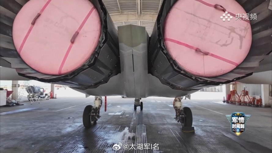

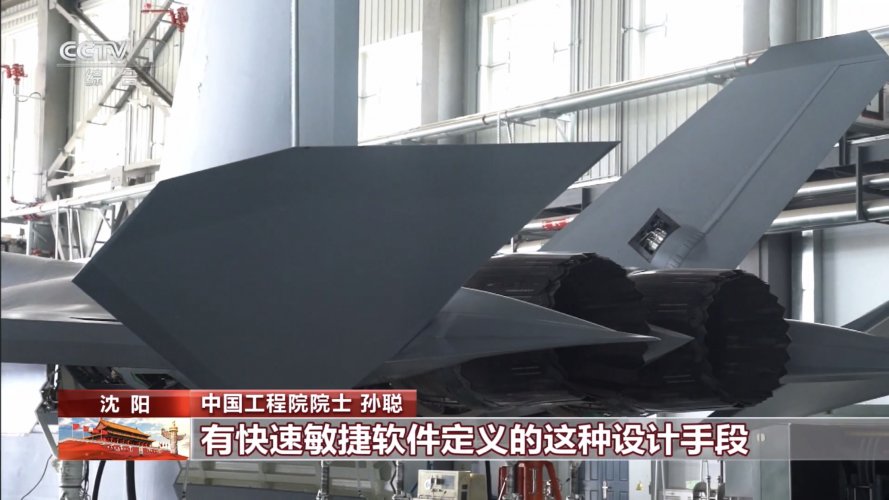

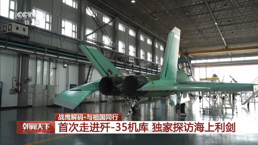

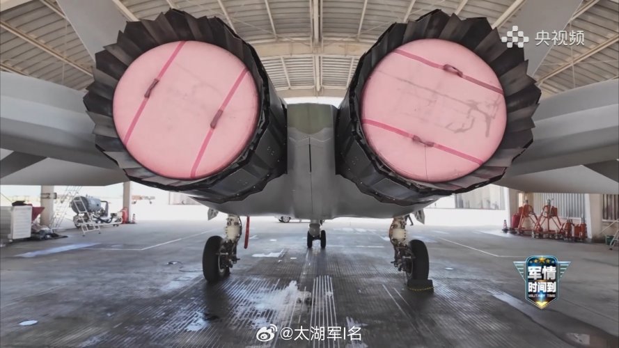

Because WS-21 is still based on the RD-33, WS-19 is a new design with triple layered nozzleIt's interesting how "RD-33ish" the nozzle remains, mechanically speaking. Elegant design though, so why wouldn't you?
But this looks much more realistic.Possible hint towards WS-19 engine? Not confirmed of course. But sea level thrust seems lower than alleged before.
