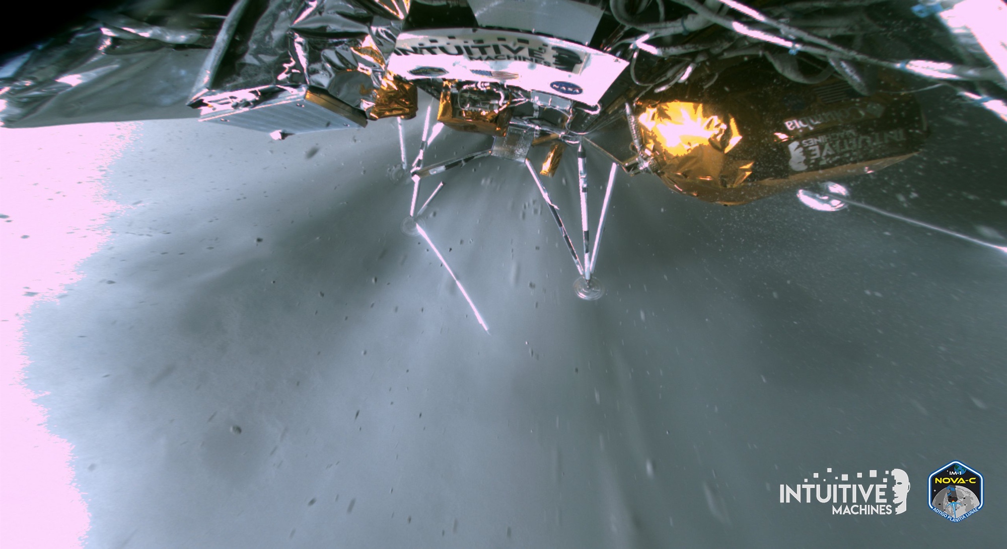

https://spacenews.com/intuitive-machines-making-upgrades-to-second-lunar-lander/
Altemus (Steve Altemus, CEO of Intuitive Machines) added that the company plans to submit a proposal to NASA for industry studies for a revised Mars Sample Return program that could bring back samples cached by the Perseverance rover faster and less expensively than the agency’s own baseline plan. “Intuitive Machines has engaged the agency and intends to provide a solution set based on a technology architecture we have been developing for lunar material return,” he said, without elaborating.
