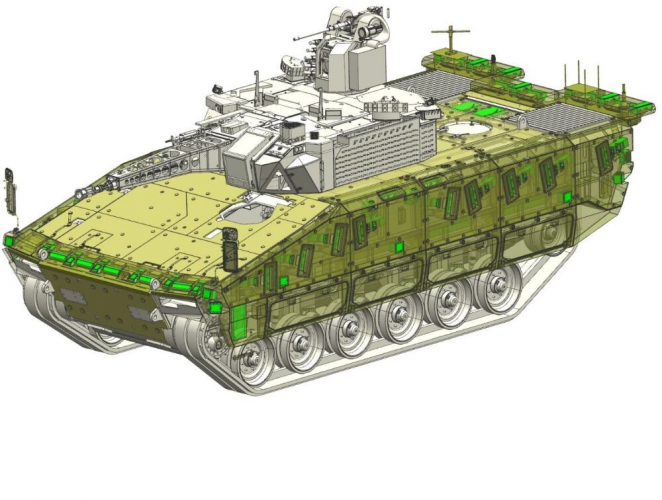

"One special advantage of StrikeShield is the extremely small electromagnetic signature of the low-power radar sensors. This decreases the risk of detection of the radars – and the vehicle – by hostile electronic intelligence (ELINT) assets. According to Rheinmetall, some currently deployed APS radars can be detected from a distance of 21.5 km, while StrikeShield’s low emissions limit the detection range down to roughly 350 m (at -60 dBm sensitivity) for tactical level ELINT assets, or 6 km (at -95 dBm sensitivity) for more powerful strategic-level ELINT assets."
You forget that EMCON is a serious measure and its the easiest way to find APS equiped tanks. Which is why an LWS would be needed to slave Trophy too it. But you really also want the acustic system for launch of others but an LWS is already an hugh improvement.
For that the radar needs to be on and you don't only car for the arrow but also the archer.
If a LoS ATGM is fired at you, your radars need to be on.
1. StrikeShield is not installed on Leopards so what point are you trying to make?
2. Another special advantage of SS is the massive amount of sensors.
This config here, according to Janes, has 15 radars and 35 EO sensors.
Basic principle of radars which I'm certain you're aware of, is the relationship between number of antennas or antenna elements, and strength of transmitted and received signal.
Could they be simply testing with 1 radar transmitting for every 4 receiving? Possible. Also possible they just reduce transmission power until they spot something. Or an EO sensor is used to "wake up" the radars.
You're still going to need to turn the power back up to get a clearer picture and more accurate fire solution, since you can't risk false positives. Of course you can just ignore that scenario because then you don't care about force detection anymore.
But you can use the same trick on a more traditional 4-5 radar setup. Nothing prevents you from doing that.

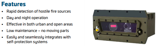

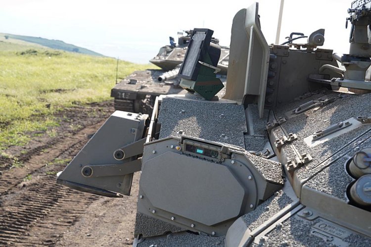

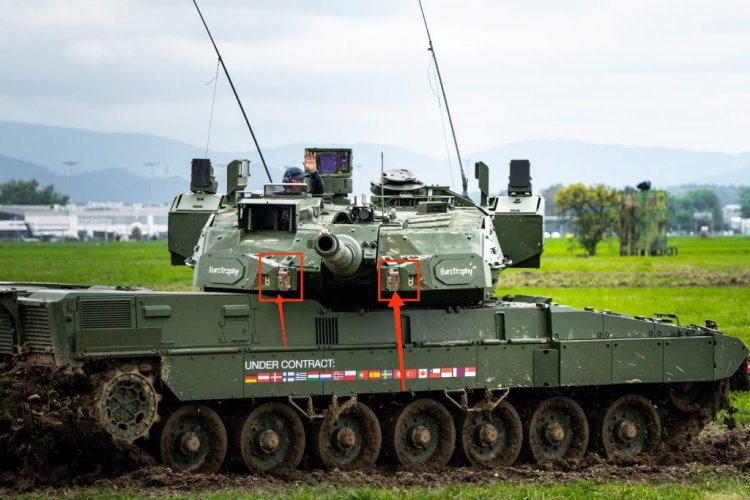

This is an EL/M-2133 radar panel with an ELO-5220 "Othello" hostile fire detector. Entered service around 2020.
And coincidentally, in 2023 EuroTrophy brought this config to Europe

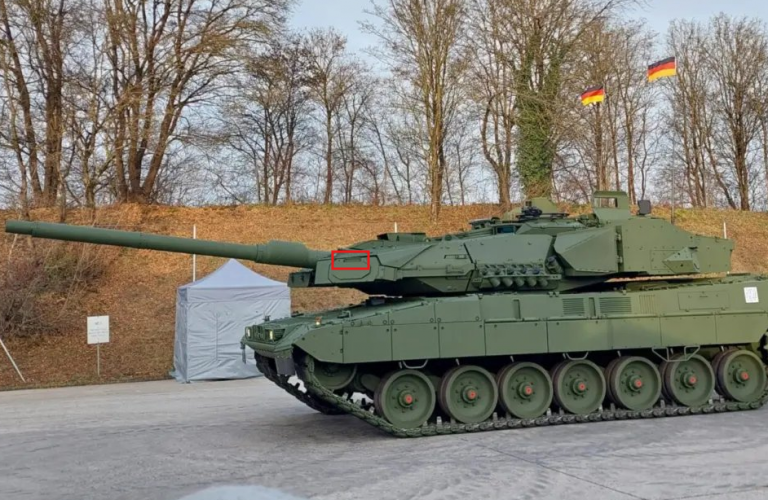

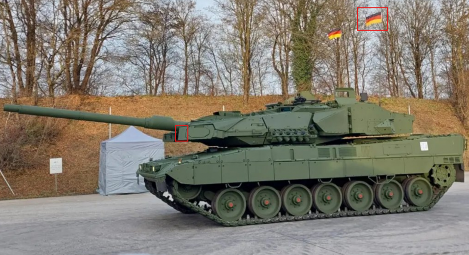

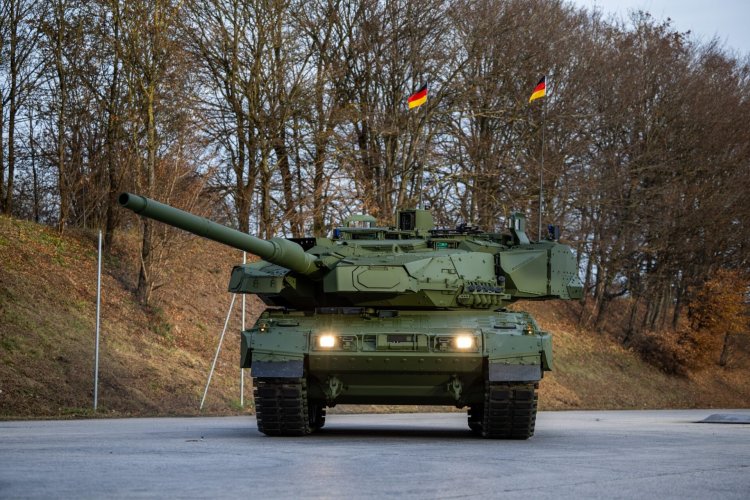

Thats only the housing. As you can see here there as green as the rest and not the black the sensor has. Its likely because this is the new standard housing design...
Don't know if it's an optical illusion or whatever but it shows intent. Wouldn't put it there if they didn't want it. And we know the housing was designed per customer because the German variant doesn't have the LWS housing which the Norwegian one does.
I would disagree with that.
yeah they put it there because the LWS need to go somewhere and where would it be better than in a space thats already designed for an LWS.....
It has the housing it just doesn't have the LWS sensor and its specific mounting system because an other sensor may not use the same. Again why would they only install LWS later when its the same?

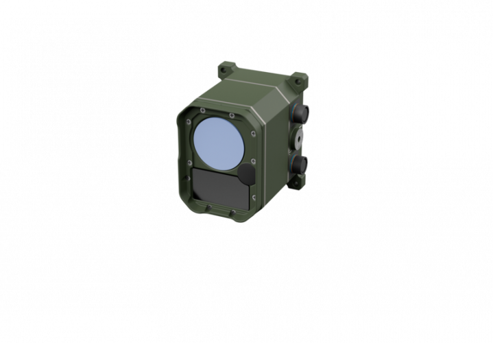

And Norway is getting 2 LWS types, with one mysteriously identically matching the ELO-5220?

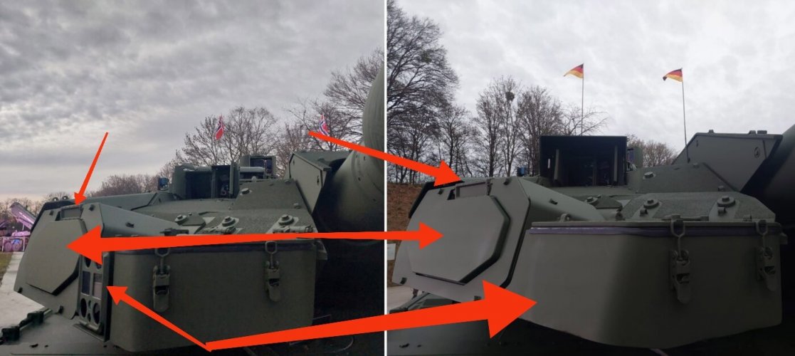

Norwegian Leopard, showing an LWS mount/sensor beside the EL/M-2133 radar and ELO-5220 HFD.
German Leopard, showing no mounting point or sensor beside the EL/M-2133 radar and ELO-5220 HFD.
So instead of using the LWS housing like on the Norwegian Leopard, they built the exact housing designed for the Othello HFD, and want to put an LWS of unspecified design there, with coincidentally matching form factor, while blocking the installation of the Othello?
Is that what you're saying?
Im saying that the housing which contains the EL/M-2133 Radar, Elbit LWS and Othello are the same for the norwegian and german tank.
Why? Because its cheaper and it allows each user too choose there own loadout. Now MUSS (2.0) if choosen will be fitted there where the LWS of elbit sits because they "Look" the same size and this space is there on the german Leopard 2A8. Afterall its dead volume if its not filled with a different sensor. A MUSS Sensor Head is in a similiar size factor and form.
No its not. Norway has 1 LWS that of Elbit and the the space for an ELO-5520 HFD which as far as i (we) can tell isn't there because from every angle its green not black which indicates it.
Again the space is there just no fitting for the Elbit LWS sensor. Even the Leopard 2A8 Prototyp had there the LWS because nowhere else is space for it.
The reason for the Bundeswehr to go after MUSS is the same reason you didn't like them having Boxer and CAVS. Logistics...
I think a lot of the wording is vague so we're misinterpreting each other.
The Trophy system in the configuration chosen by Germany appears to match the "Silent Mode" advertized by EuroTrophy, with the Othello sensor. So we're good on the matter of signature management.
The Othello is a HFD, so it can be argued as redundant with an LWS. Still, we see both installed on several types of MBTs.
Installing MUSS is a possibility. I think it's odd that even a placeholder was not installed.
You assume thats the reason but maybe just maybe this is the new standard configuration.....
Again as far as we can see there is space for Othello but it doesn't look Like any is installed because this should be visible but very angle only show that there is space no system.
Thats why it still takes time because its likely that exactly this is still in development.

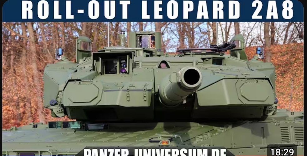

It is possible the EL/M-2133 and ELO-5220 combo is the standard production version for EuroTrophy so why would they specify it as an add-on?
If the Othello is baked into the algorithm then going without it ends product support.
Then where is it??? Because in this head on View im not seeing it. What is possible (and likely) is that the Leopard 2 Trophy mounting can take all sensors if an consumer wants it but germany didn't buy it.
(Source:
View: https://youtu.be/Z3fz1C758Oc?si=1b_N08U_ZtDuX5AR
(Source:

Is this tank configured for delivery to the BW?
If it is, then that's a good question. If it isn't, then it's hardly an issue.
Years after entering service, I see Eitans still either without APS (Iron Fist) or with empty APS mounts. Reason unknown. But the intent is to fit them all.
We don't know if they intend to tour that Leopard to customers.
Some of the Leopard customers are not approved for access to that system.
I think there's more logic in assuming BW wants to align their Trophy variant to the production standard of the last several years. And it doesn't conflict with a MUSS 2 buy since the Othello isn't a LWS and the two system types are often co-fitted.
Yes
All Leopard 2A8 and L2AX will have APS.
I doubt 2A7A1 will get an refit tho...

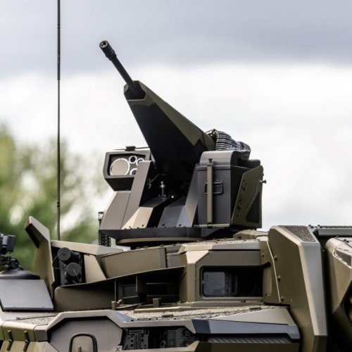

Its just redundant. MUSS 2.0 at its current level can do all that what Othello would do and (based on the configuration) even more. It would complement Trophy really well but also look quite funny
Oh, and drones? They don’t even get close. It sees them, tracks them, and blasts them mid-air like clay pigeons.
It's such a confidently stupid statement, it hurts on a physical level.
However aside from the terrible video which doesn't show the actual L2A8 for most of the time, I noticed that that Leopard 2A8 that was recently rolled out was lacking the remote controlled weapons station. Something that would actually be useful against drones.

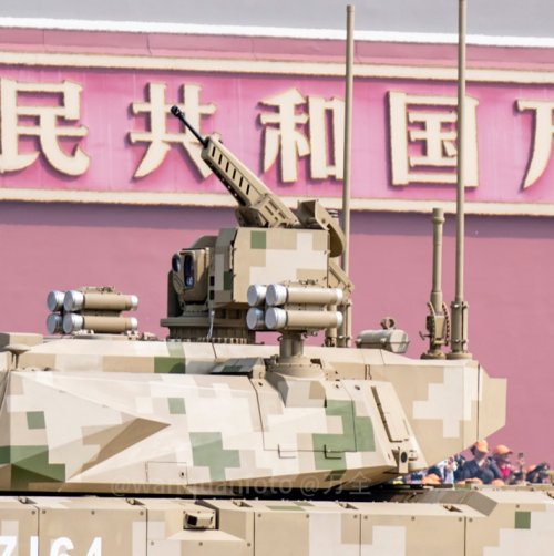

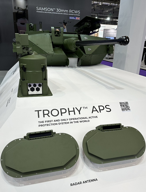

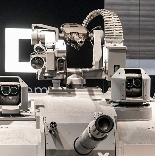

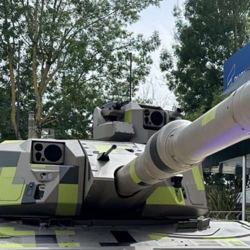

A large caliber (.50 cal up to 30mm) remotely operated weapons station with proximity fused rounds like shown on many technology demonstrators and mock ups over the most recent years is something that shouldn't be absent from any tank rolling out these days. Preferably optically guided or through radar. Such a system is a theoretically viable countermeasure against drones, even engaging them before the hard kill measures of the APS have to step in, and seems to be absent from the example above.
For comparison we have;
Leopard 2 A-RC 3.0:
Panther-U:
EMBT:
Abrams X:
ZTZ-100:
Leopard 2 A-RC 3.0:
Panther-U:
EMBT:
Abrams X:
ZTZ-100:
