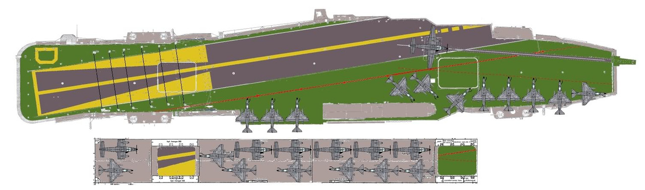

Too bad. I'd like a viable scenario with high performance not V/STOL aircraft usable from light carriers.
Indeed, how would a larger Veinticinco de Mayo have served Argentina in 1982...aumining no change elswhere.

Potentially. Back in the day I’d drawn up a Centaur with Mirages (the swing wing Mirage G) and compared it with a Colossus with Skyhawks.
The result was the Centaur looked marginally better but still could only operate ~18 fighters once you leave enough space for some AEW/ASW aircraft/helos.

Could P.1154s been based and flown on, say, HMS Hermes ? How many could it carry ?
