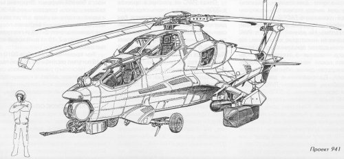

Kamov project 941, designed for Chine in 1995 and futher known as Z-10.

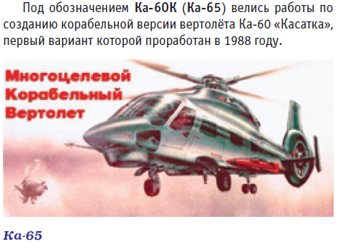

The Kamov Ka-60k is called Ka-65 ?.

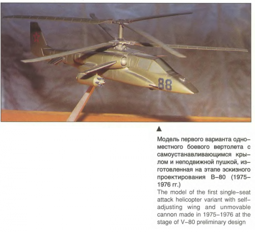

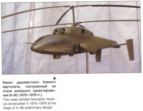

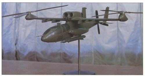

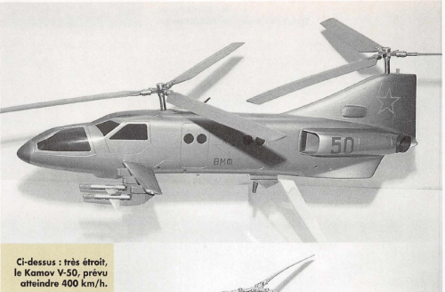

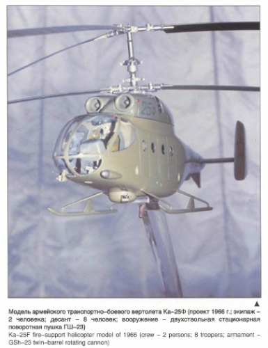

May 26, 2006
27,354
4,158

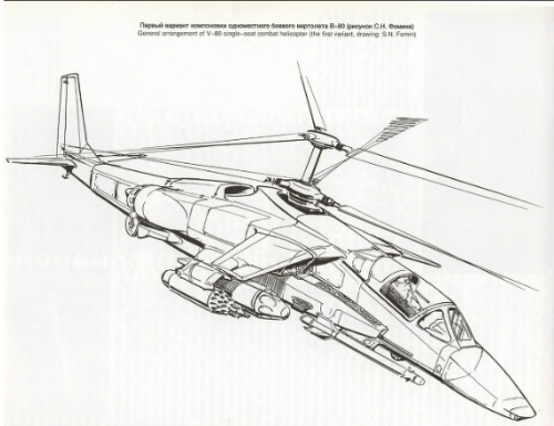

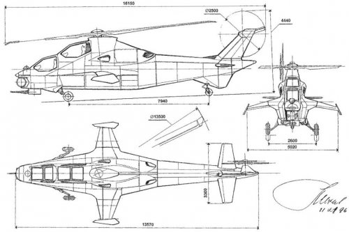

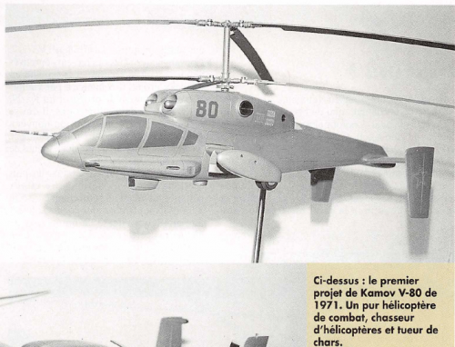

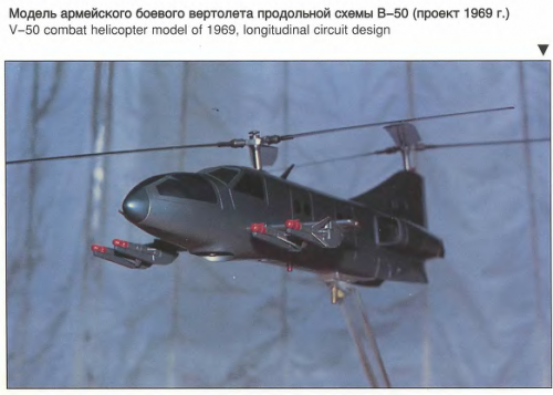

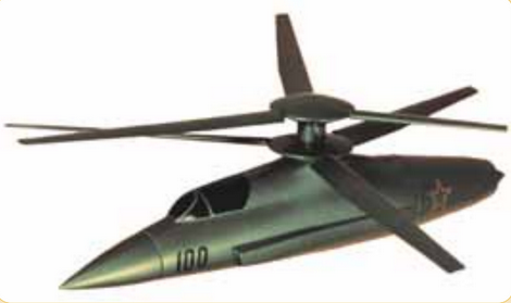

From a Russian book about Ka-50.

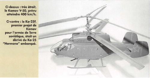

Maveric
Fight for yor Right!
Jan 14, 2007
1,988
352
Picture 1 shows a model of Ka.25F
Picture 2 the V.50, 3 & 4 the V.100,
and 5,6 and 7 the V.80.
May 26, 2006
27,354
4,158
Thanks.

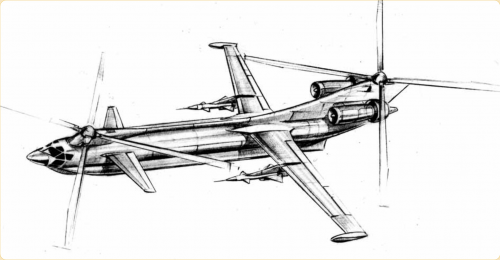

mil said:
deep modernization of the V-80 helicopter in the high-speed helicopter attack plane of new generation.The high-speed helicopter attack plane according to ABC scheme
with an operated jet nozzle (the project of 1989)
I think this is the same project.

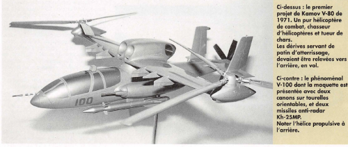

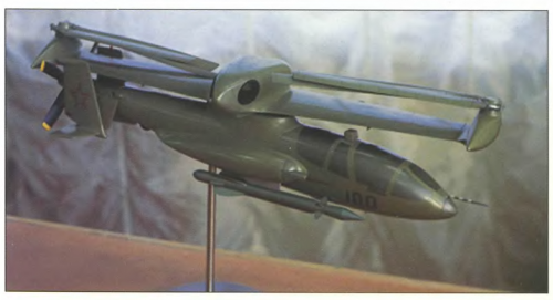

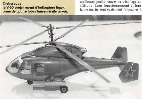

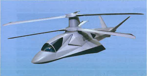

From Le Fana 301.

jsport
what do you know about surfing Major? you're from-
Jul 27, 2011
2,357
404
WOW amazing. Thank you for posting Hesham.

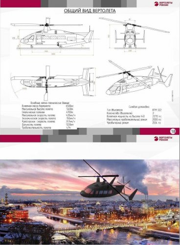

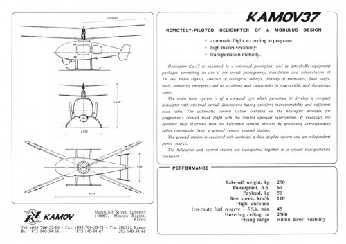

offer from Kamov 2019
I remember seeing it as an MAI graduate project back in 2017. It's like Sikorsky nominating an AIAA graduates competition entry for Colliers or Laurels. So don't take it too serious.
