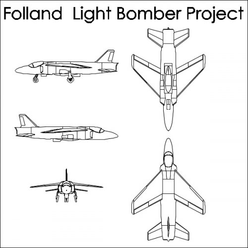

In "Sabre Slayer and Red Arrow" a bomber version is shown, not really a derivative,
but a development along the same lines as the Gant, which would have been a true
successor to the DH. Mosquito.
I've estimated lenght as about 13,3m and span about 9,4m,
Just a guess, of course ...
@ TsrJoe :
Difficult, as in "Sabre Slayer and red Arrow" there was just a perspective drawing.
But I'll look up again, at least, what my estimations were ...

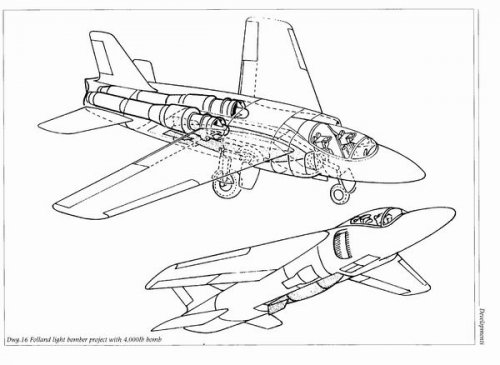

Hmm, looking at those illustrations, I'd be tempted to suggest that the aircraft could be modeled using a 1/48 Gnat kit and a couple 1/72 ones to get the right tailpipes. It'd be an attractive little thing for your shelf.
elmayerle said:
I'm inclined to say that's just how Folland engineered this proposal. It really looks like a scaled up Gnat with a pair of Orpheus-sized engines.
Jemiba, do you have any more details?
No, sorry ! IIRC this project was just mentioned in quite a short notice, without further
details. I used the engines and the 4000lb bomb as basis for my estimations .
But I'll ask boxkite, to have another look into this book ...

It lasted a little bit longer to find my copy of „Folland Gnat – Sabre-Slayer and Red Arrow“ – sorry. I’ve checked the half page regarding the Light Bomber Project – unfortunately it’s one of the few projects WITHOUT mentioning the dimensions.
On page 109 is written: “This was foreseen as a successor to the Canberra bomber, a brochure being raised in June 1957 with the G.A drawing SK.1785 that indicated a light bomber based on the Gnat formula, but basically a Gnat ‘scaled-up’ in the ratio of 1.5 to 1.0. … Power was intended to be two Bristol Orpheus engines, either Or.11 or Or.12 …”
Considering that the ratio of 1.5 to 1.0 fits a 1/48 scale basis for a 1/72 scale kit, my initial estimate appears to be fairly close.

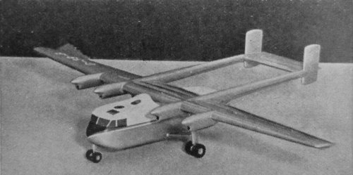

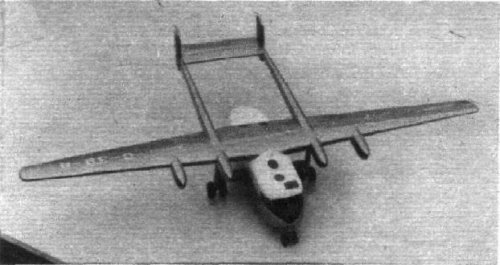

The link says "Folland light transport project" and why a LIGHT plane would have 4 engines (turboprops?). Either the journalists made a mistake or else the engines were very small (BAe 146 like?), for STOL performance blowing the whole wing or something, no?
To me those engines don't look like turboprops, as they don't seem to have a circular cross
section, as turboprops usually have. I would assume the engines could have been something
like DH Gipsys Queens, as in the DH Heron.

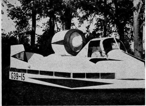

From the "Helicopter and VTO World" magazine, January/February 1961 issue, probably not regarded as an aircraft
by everybody, but it left the ground and had an aircraft registration: The Ground Effect Research Machine, short GERM,
powered by two 700 cc Royal Enfield motor cycle engines and shown publicly for the first time dring November 1960.

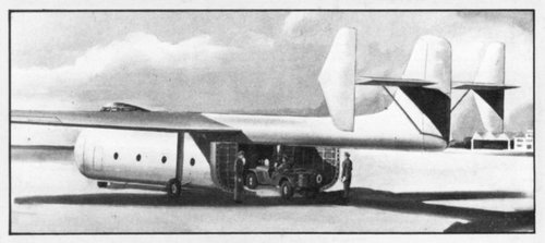

The Utility Freighter Aircraft
Span 87' 6"
Length 57' 6"
Height 18' 3"
All-up weight 17,000lbs
Typical loads could be 32 passengers, 37f ft3 freight, 2 Land Rovers or 16 paratroops

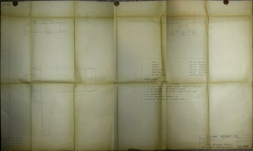

I have the drawing of the Utility Freight Aircraft, I won them on ebay this evening. Wait a few days and I will post them here
OK Schneiderman,I will wait.
A quick photo of the drawing. Sorry about the poor quality
That's my lucky day,thank you very much Schneiderman.
Jemiba said:
... the engines could have been something like DH Gipsys Queens, as in the DH Heron.
So Jens was exactly right back in Dec 2007. SK.1551 reads "Gipsy Queen 30 engines" ... just as used in the DH Heron :D

From The Aeroplane
The Utility Freighter was designed to meet a specification issued by Caspair, a charter airline operating in Kenya, and hence was it was a simple aircraft optimised for overseas operations. Engine installation was identical to that on the D.H. Heron to minimise costs. The brochure includes detailed weight, performance and cost data but there is no mention of a Fo project number.

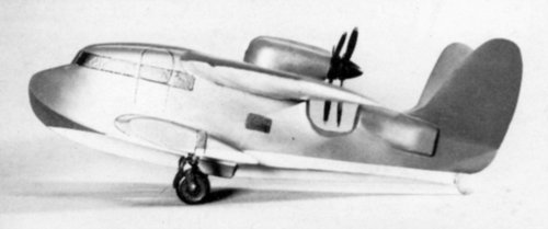

I probably always get the same question, I hope no one resents it. Are there technical data for these projects?
There's probably data sitting in the BAe Systems archive but not much published. The amphibian was for ASR and powered by a RR Griffon driving contraprops. The Fo131 glider was an all wood version of the Fo128, 98' span, 74' 6" long
Incidentally, it apparently was built and tested at Folland Aircraft Limited's Hamble Works.
