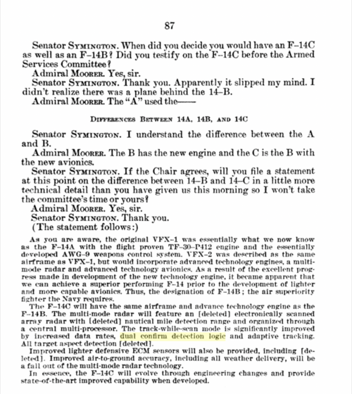

Does anyone have further insight into the F-14C's proposed radar (phased array?), and what the term"dual confirm detection logic" refers to?
https://www.google.com/books/editio...+detection+logic"&pg=PA87&printsec=frontcoverView attachment 679684
While I can't say for certain, I know that the AWG-9 had a problem when in track-while-scan mode. Namely that there was a delay of, I think, 2 or 3 seconds when updating the RIO's display. This could cause it to look like targets that were being tracked were turning in on you even when they weren't. The fact that this "dual confirm logic" is mentioned while discussing the TWS mode of the AWG-9 would seem to indicate that it was related to radar operation in that mode.
Electronically scanned array? So it’s a PESA? Maybe it’s the electronically agile radar they developed for the FB-111? Or something like it.
Noise is a variable, which can become a problem when dealing with long-range return signals (Inverse square law).
The easiest most straight forward method to deal with noise is to set a threshold for the signal return.
We want the radar to show a return when there is a real target, and not when there isn't. We want to set a threshold high enough to avoid a false positive from noise.
But we also do not want a weak return from a real target to get missed because we set the threshold too high and noise+return was lower than the threshold.
Because signal noise is a variable, this is going to result in a probability of detection regardless of how well we set this up. If we increase the threshold, we decrease the probability of a false alarm, but increase the probability of missing a valid target. It is going to be a trade off.
Detection logic is simply how you tell the radar to determine whether it has a target (valid return pulse). Example: "If Signal is greater than Threshold display target. If Signal is lower than Threshold ignore signal".
I'm not familiar with "dual confirm" in this context, but it seems pretty straightforward. They have added a new process or variable to the logic. Or there are now two methods of logic and they both need to agree.
If we know the probability of a false alarm for our threshold, for example, we can look at how many false alarms we would expect in a given period of time and compare it to what we have experienced. "If number of returns over threshold in period of Time is greater than probability of false alarm over period of time, treat as real target."
What the particulars are in this case, I do not know.

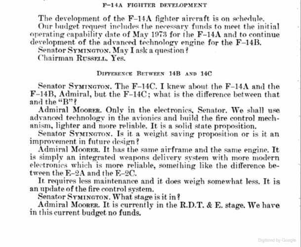

As the F-14C has floated up again, I've just had a flash of the obvious.
It's extensively reported that the F-14C would have had all-weather attack capability comparable to the A-6. But, when that upgrade was on the table, the A-6 was a lot less capable - TRAM and laser-guided bombs didn't come along until 1979; Harpoon not until the 1980s.
While the F-14C might well have had comparable capability to the A-6 with gravity bombs and unguided rockets, and was probably a platform for the AGM-53 Condor, I doubt very much it would have the same capability as the later A-6E with TRAM.

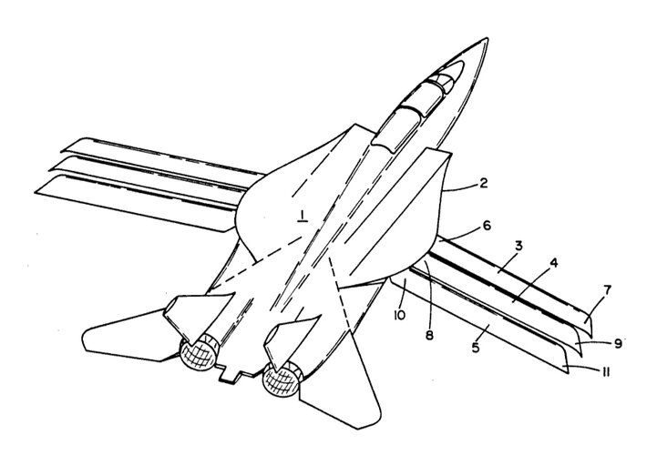

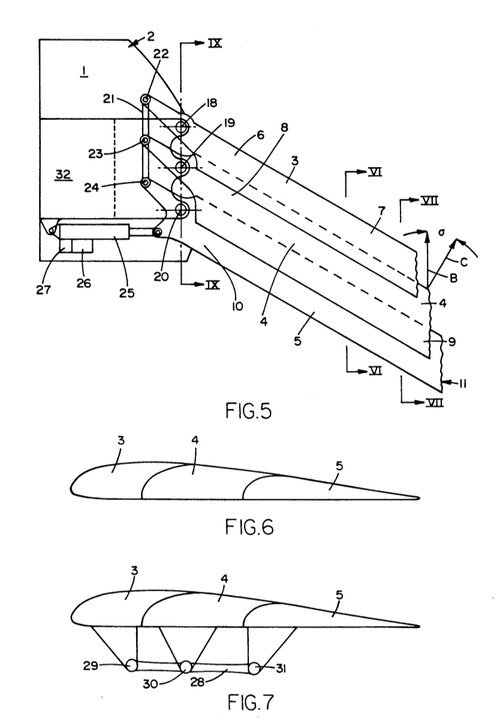

And for those who thought the Tomcat was an hydraulic nightmare with its variable swept wings, what about... three sets of those?
Grumman studies, patent dated 92, but drawings dated 94...
https://patents.google.com/patent/US5312070
Still just one hydraulic jackscrew (or piston, or electrical even, as the patent doesn't specify. "A motion imparting device ...comprises a motor of any suitable known type, such as, for example, an electric or hydraulic motor.")
More mechanical bits there, for sure, considering the variable camber aspect.
Further reinforcing the point that an idea doesn't have to be good to get a patent. It just has to be novel and not obviously impossible.
So true.

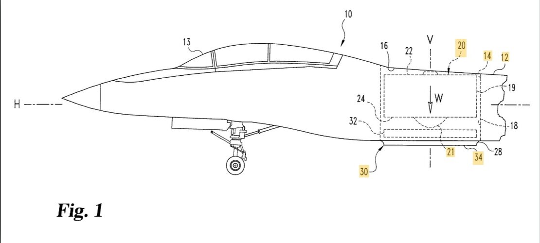

This one isn't bad either, but not from Grumman and the Tomcat front fuselage most probably for illustration purpose only.
https://patents.google.com/patent/US6382559B1/en
That finally answers my question about whether the C was an enhanced B with attack capability or an attack aircraft lacking Phoenix. It's still a fleet air defense aircraft with Phoenix, it just has a radar that can handle attack modes as well so it can do both attack and fighter roles. Which also explains why the Navy wanted it to replace the A-7 since a carrier could then carry more F-14s for FAD while still retaining attack capability. The A-6s would still be around for their mission.
