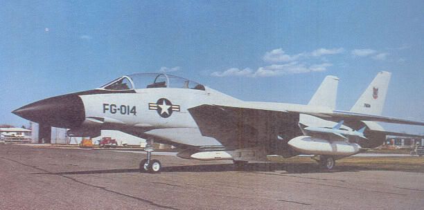

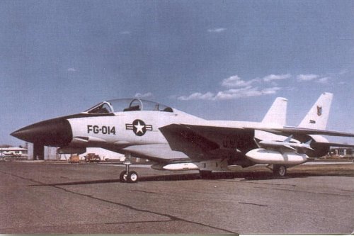

Here's a photo of the F-14 mockup:
Regards,
Greg

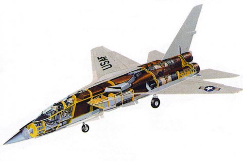

I think the F-106E/F was slightly before IMI. It was proposed in '68 where IMI wasn't until '71 or so. For the Vigilante (NR-349) the 3 J79s would have put out much more power than a pair of F100s especially at high speed and altitude. However there WAS a version of the Vigilante kicked around with a pair of J58s. Sombody here posted a couple of excellent pictures of the NR-349 on the Key Publishing forum (ironically I even suggested they might want to post them here :) ) I think it might have been Martje? Anyway here they are. . . As far as it being a Foxbat equivalent none of these were designed for high heat so Mach 2.8 would have been iffy. The F-12B and F-108 would have easily been up to the task though.
I planed to use it in new three engined figters thread together with my latest finding - 3 engined F-106, but OK, why not here :)

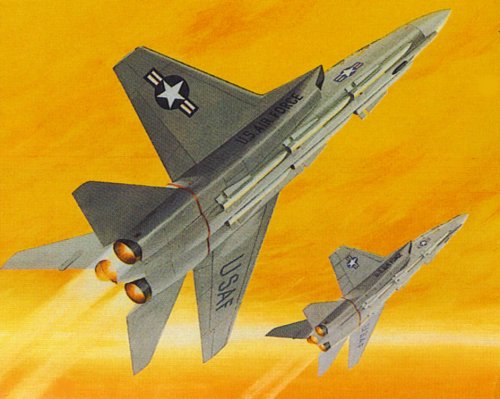

Here's a color one:
[image removed - Overscan]

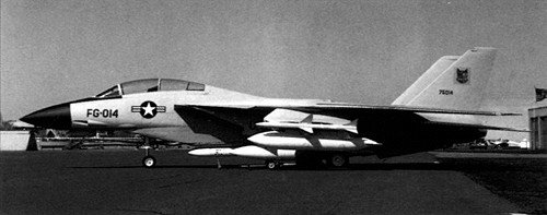

I thought you might also be interested to know that there was even a patch developed for the F-14 proposal:

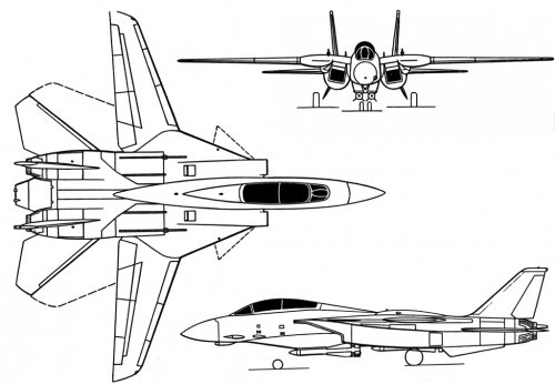

F-14 (ADC) IMI 3 view
  • Air Enthusiast February 1973
Planned to use GAU-7/A 25 mm caseless cannon + F100 turbofans
Clean weight: 54,000lb (24,494kg)
Maximum weight: 70,000lb (31,751kg) external fuel and weapons
Span: 62 ft 10 in (19.15m) 37 ft 7 in (11.45m)
Length: 62 ft 0 in (18.9m)
Height: 16ft (4.88m)
Thanks 'Overscan'
The info on the F-14 (ADC) & 3-view drawing is what I am looking for.
Any chance of finding out more about the article it came from in the Air Enthusiast Feb 1973 ????

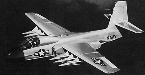

The Missileer was not that bizarre a concept (a pic is attached), but it was only viable, given the large number of available carriers the USN had at its disposal in the late '50s and early '60s, because the only thing it could do was loiter for a long time and throw missiles at incoming bombers. It could not perform the fighter mission (F-4s and F-8s were to do that). Interestingly, the Missileer mission was what McNamara's F-111B was supposed to perform, which he decided could be performed by the same design that would do USAF's low level supersonic strike mission.

While spectacular the F-12B wasn’t really a practical proposition for a day-to-day air defence role.
While, say, a tailored F-14 might have suited the real-role better the US ended up doing relatively OK given the actually relatively limited threat of Russian bombers to the continental US until the emergence of Bear-H’s and Blackjacks much later in late 70’s and the 80’s.
some clarification
The F-12 was Long range mach 3 interceptor with 3 missile on board and no Gun.
The propose alternative was F-111 with 9 missile (with Nuclear option) and a Gun.
And with Long range i mean around 2140 km or 1330 miles.
But the F-111 debacle let paradox situation that US NAVY went for the F-14
While USAF change there specification and went for F-15
Also CIA wrong estimation about Mig-25, capability play a litte role in this case
some clarification
Any details on the F-111 with nine missiles? The F-111B would have carried 6 Phoenix. What was this other F-111 to carry?
As strictly an interceptor, an F-111 with 6 Phoenix, the AWG-9 and a pair of 30k TF30s might not have been too shabby.
The F-12B was intended to intercept long range supersonic air launched missiles as much as it was supersonic bombers. Full deployment of the 216 operational F-12s was planned for FY73, the Soviets first flew a Tu-95K-22 in October 1975. USAF ADC's timing may have been ahead of the threat but not by much.
