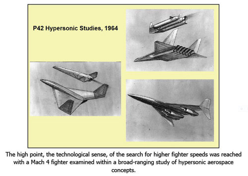

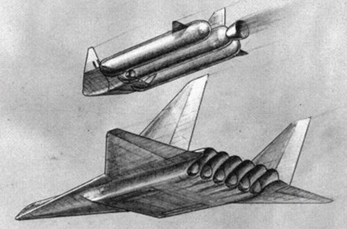

Its EE's military successor concept for after the P.42 flights building on the hypersonic knowledge gained.
I forget the number and the magazine source right now and will get back to you when I dig it out to refresh my memory. Orriginal source is in the picture.
Viewed as a fighter for RAF and RN use.
AAM's where supposed to be submerged on the upper inner wing surface apparently.

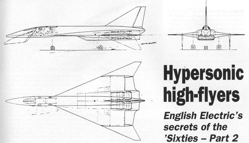

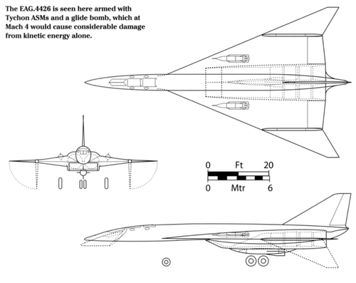

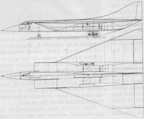

Three view drawing comes from:
'Air Pictorial ' May 1999
Article :Hypersonic high-flyers. English Electric Secrets of the Sixties-part II
by Chris Gibson.
Correct, but missed the number which was EAG44___something.
from the article, i believe it to be the EAG 4427, but the picture is not captioned as such, and the article also mentions the EAG 4426, which was to be larger, TSR2 as opposed to Lightning sized and which was similar,but differed in detail.

My apologies for a bit of a bump here, but it didn't seem worth creating an entirely new thread purely to question a few bits of viability. Considering the amount of fuel which might have been carried by the EAG.4427, would it have had a combat-radius sufficient for it to actually serve sufficiently within the strike-role without excessive buddy-tanking from another aircraft?
It's just a point of curiosity that hit me reading through Tony Butler's section upon them.

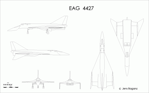

Ah, yes, remember the Air Pictorial article, too, although it was outshone by Tony book later, of course !

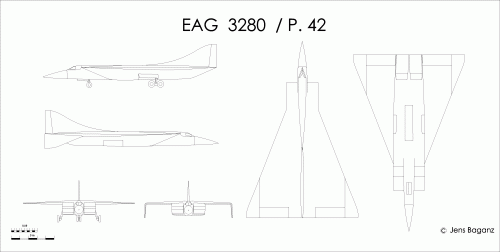

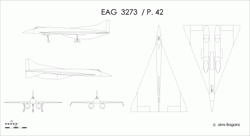

(Just used the article as basis and added the underside view)

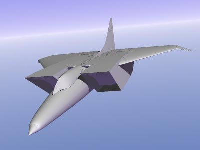

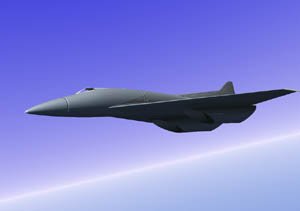

Jens, were the first and third project meant to be stealthy? They sure seem to evade forum posting... Completely blank pictures!
Looks like the EAG 3273 and the EAG 4427 were stealth designs... ;)
Just saw Skyblazer beat me to the punch!
Martin
Stealth designs indeed, visible only to the believers in stealth, just like the fairy tale "The Emperor's
New Clothes" !
Sorry, have attached the drawings again, they should be visible now. :-\

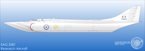

What is the objective of this design?(EAG.3280)

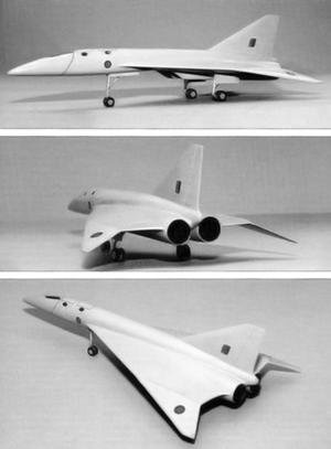

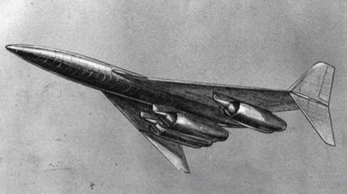

Some Russian site shows us naval strike version. Please check yourself.

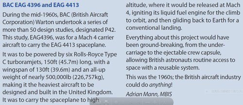

Hi! EAG.4396/4413 three stage to orbit system.

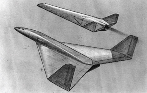

Hi! EAG.4416.

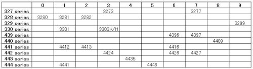

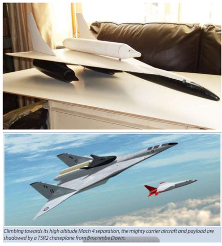

Hi! 4435?

Naval strike version. Please take care for folding nose.

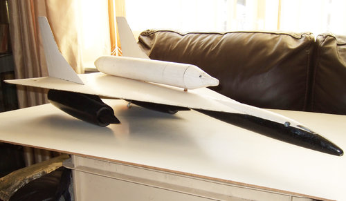

This model looks like follwing picture.
Maybe smaller space ship was located top of the booster and disappeared now?
