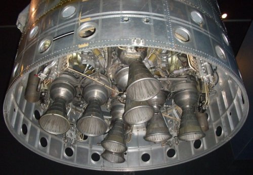

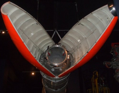

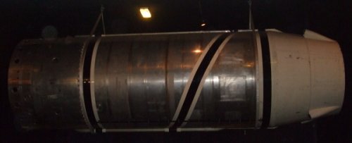

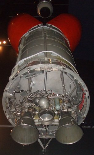

Whiling away my time in London on Sunday waiting for my evening 50th Anniversary Radiophonic Workshop concert I decided to visit the Science Museum in Kensington...

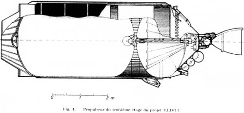

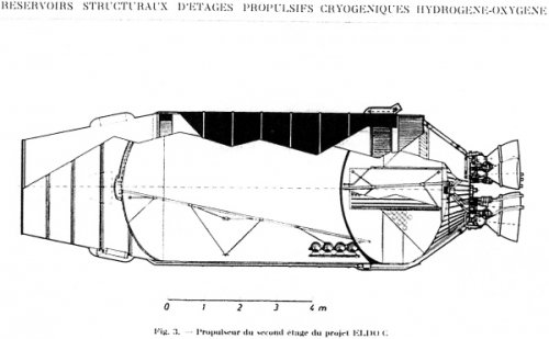

ELDO-C
is another name for ELDO-B2 (with 2 stage LOX/LH2 )
up to 7000 kg in low orbit

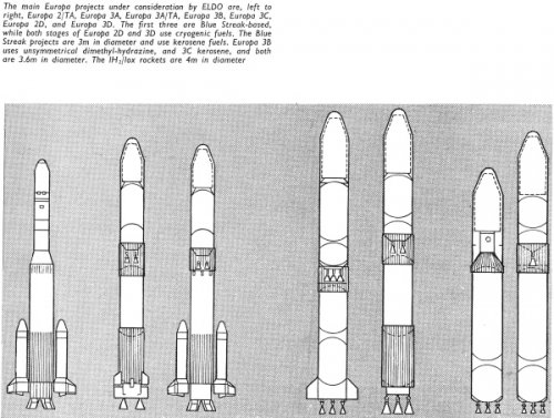

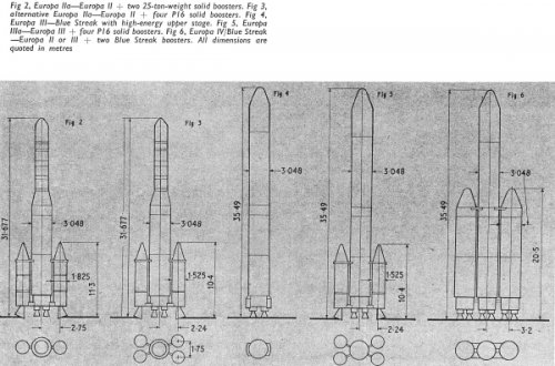

Europa IV
had to planed 3-4 years after Europa III (around 1978)
for payloads of 2 tons into GEO
another new find
it seem that the french VULCAIN proposal from LRBA was also EUROPA-1 alternative

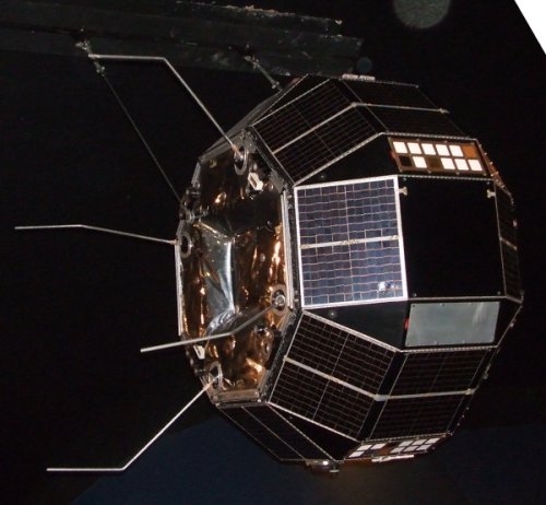

I have a question on Fotos:
how big is the X-3 Prospero Satellite ?
Prospero size?! Titchy...
thanks for picture, is that wat i looking for
Prospero is still in orbit and it transmitt data on 137.560 MHz !
Not bad for some thing was build from leftover parts

question had we here http://www.secretprojects.co.uk/forum/index.php/topic,2906.0.html
not with normal Blue Streak
The B S was build like ICBM Atlas, Tanks made out 0,48 mm thin metal Sheets.
the central stage has to be reinforced
ticker metall sheet or Kerosene tank structure Stringer (or stiffener) are extended to top of stage
as Boosters for a central core? could work !

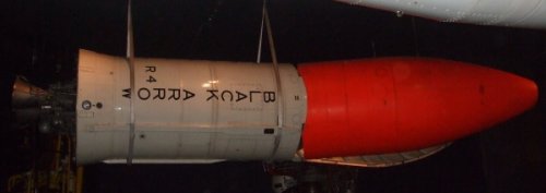

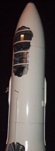

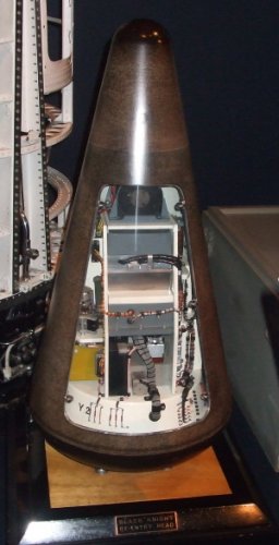

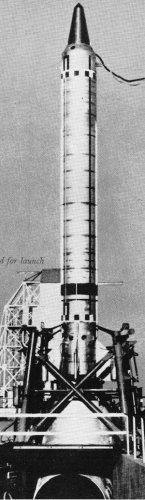

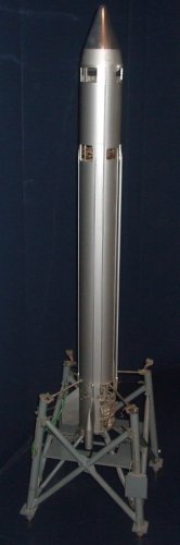

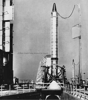

May I use your Pictures of Black Knight at the Science Museum to illustrate a talk, please?
Sure you can - but don't you mean Black Arrow ;)
This is Black Knight (well a model anyway) and its re-entry body.
Hi Barry,
Whooops, yes you are right, Black Arrow. Many thanks!

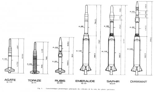

that french "Pierres précieuses" program (or gemstones in English)
its goal was to development and construction of missiles and there guidance system
for French nuclear strike force and launch of satellite.
Solid fueled rocket
Agathe: development of measuring equipment on board and on ground
Topaze: development & test guidance system
Rubis: development & test (with Agathe ) of stage separation
Liquid fueled rocket
Émeraude: test for reentry Warheads for Nuclear weapon
Saphir: development & test of stage separation - (Émeraude and Topaze)
(most Émeraude & Saphir launches were warhead test)
Diamant: launch rocket - Émeraude, Topaze, Rubis
Cora: better know as Coralie, second stage of Europa 1&2 was also a "Pierres précieuses"
note on Émeraude
in original French proposal for join venture British space Program
was to use Émeraude as second stage on Blue Streak
the Technology used on Émeraude origin from Véronique sounding rocket
Véronique (VERnon et electrONIQUE) aka Project 4213
is the only rocket from the project 4211 aka Super-V2
France got after WW2 parts of 30 V-2 and thirty German engineers
and try to rebuild them for own V-2 rockets
http://www.astronautix.com/lvs/superv2.htm
but project 4211 was cancelled in 1948 and
the team concentrated on development of the one-tenth scale Project 4213 / Veronique
so ironically Véronique and "Pierres précieuses" got also German origins
Doc Air Espace No 98 Mai 1966.
ELDO C
interesting a new version
the first stage is 4 engine Blue Streak
that pop up back 1970 as EUROPA-IIIC
you got more info about this rocket ?
;D
I copied the whole article but as it is in French I cannot read it.
;D
wat i can read very good ;D
and by Magic here Translation
the Original Article is from M.J. Ménard
chef of space study service at Center for cryogenic study of Society l'Air liquide
after general explanation over Hydrogene and oxygen fuel
he come to ELDO-A
if they replace second and third stage
with Lox/Lh2 of same mass, payload increase from 1t to 3 tons
for the ELDO-C
third stage H5 with 2 or 2,3 meter ø and fuel mass of 5 Tons
Ménard describes the thermal problem of stage structures
from 150 °Kelvin to 2500 °Kelvin and about the isolation of stage fuel tanks
also he describe the alloy for tanks
were he wonders about use of Aluminum AU4SG in Saturn II and S-IV stage
because its bad weld properties
in France AU4SG is labeled Aluminium-copper (série 2000)
Ménard proposed the use of Aluminium-Zink (sèrie 7000) or
Aluminium-magesium (série 5000) because they have better weld properties
he consider alloy AG4MC too poor in mechanical stress
and alloy AZ5G as promiss for future use
and warns about the use of Titan for LOX tank because it will form titanoxyde.
the next pages Ménard talks about Isolation of the tanks
he describe the technology used in Saturn Rocket and proposed also advance system
like gas barriers between the Tankhull shells
special thanks to Barrington Bond for providing the data ;D

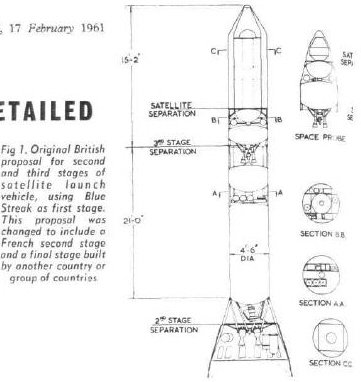

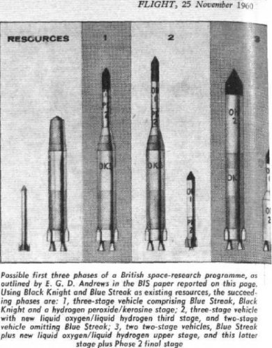

http://www.flightglobal.com/pdfarchive/view/1961/1961%20-%200202.html?search=blue%20streak
Hi Barry,
Interesting proposal, a friend had the third stage engines from this or the alternative 3rd stage Black Arrow as a door stop in his garage. But a vague recollection that they have now been passed on to a collection? The point is that it seems that the technology existed for a UK SLV civil programme and could have been in place by about 1962 and at less cost than the redundancies?
Hi Barry,
Sorry pardon, it was the alternative Black Arrow engine and only a model. Should have checked first
