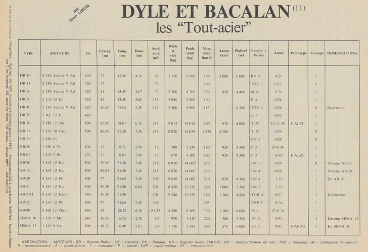

Société Dyle et Bacalan - 1924-1929
In 1924, shipbuilders Société de Travaux Dyle et Bacalan of Bordeaux established an aeronautical division to design and build aircraft of all-metal construction. This shipbuilding firm went bankrupt in 1928 and was bought by the Ateliers et Chantiers Maritimes du Sud-Ouest to form the Ateliers et Chantiers Maritimes du Sud-Ouest et de Bacalan Réunis. Aircraft design and construction was then taken over by the Société Aérien Bordelaise (SAB).
Note that 'DB' designations were initially carried over into 1930 by the newly-formed SAB.
Dyle et Bacalan 'DB' Aircraft Designations
DB 1 - (Project) 1924 twin-engined; lifting-body bomber
- DB 1 : Braced high wings; fixed undercarriage
- DB 1 : 2 x (??) hp (??) engines;* span; 18.00 m
-- * Unclear if annular-radial V12s or radial engines?
DB 2 - (Project) 192? twin-engined; lifting-body a/c
- DB 2 : Led to DB 20; no details (??); see reply #3

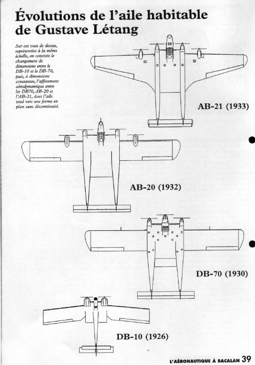

DB 10 - 1926 twin-engined, heavy night bomber prototype
- DB 10 : High-wing monoplane; lifting body centre section
- DB 10 : 2 x 480 hp Gnome-Rhône 9A Jupiter; span 25.00 m
- DB 10H: (Project) Hydro; twinfloat-seaplane derivative
- DB 10 Bn4: Armée de l'Air desig.; Bomber, nuit, 4-place
-- https://www.secretprojects.co.uk/threads/dyle-bacalan-société-aérienne-bordelaise-sab-projects.4843/#post-41171
- DB 11 : (Project) Inline-engined DB 10 development
- DB 11 : Revised wing planform with no sweep-back
-- https://www.secretprojects.co.uk/threads/dyle-bacalan-société-aérienne-bordelaise-sab-projects.4843/#post-119934
DB 20 - 1929 twin-engined; 4-seat; armoured attack a/c; x 1
- DB 20 : All-metal monoplane; lifting body centre-section
- DB 20 : 2 x 420 hp Gnome-Rhône Jupiter 9Ad; span 21.00 m
- DB 20 : Once fitted, armour plating diminished performance
DB 30 - 1928 twin-engined; 4-seat; monoplane recce a/c; x 1
- DB 30 : All-metal constr.; lifting body centre-section
- DB 30 : 2 x 450 hp Lorraine 12Eb Courlis W12s; span 28.00 m
DB 40 - (Project) 1928 twin-engined torpedo-bomber floatplane
- DB 40 : Airframe derived from the DB 30 reconnaissance aircraft
- DB 40 : 2 x 420 hp Gnome-Rhône Jupiter 9A; span 27.60 m
- DB 40 : Cantilevered high-wings with 'lifting-body'; twin floats
DB 50 - (Project) 193? single-engined observation sesquiplane
- DB 50 : To an A3 requirement to replace Breguet Bre XIX/19
- DB 50 : 1 x 480 hp Renault 12 Kd V12 engine; span (??) m
DB 60 - (??) no details; poss. a development of DB 30
- DB 60: see reply #3
DB 70 - 1929 trimotor; braced-monoplane; 3+28 airliner; x 1
- DB 70 : All-metal constr.; lifting body centre-body/cabin
- DB 70 : 3 x 600 hp HS 12Lbr V12s engines; span 37.00 m
- DB 70 : 3 x crew; 28 x diurnal pax, 24 x 'sleeper' pax

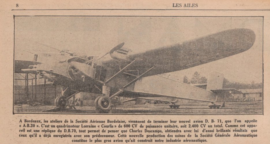

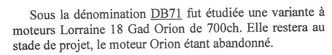

- DB 71 : DB 70 airliner derivative;* poss. re-engined (??)
- DB 71 : 3 x 700 hp Lorraine 18Gad Orion; span (??) m
-- DB 71 design heavily influenced military SAB AB 20 (qv)
-- * NB: Contemporary confusion with AB 15 bomber design
- DB 72 - DB 74: (??) hypothetical designations
- DB 75 : (Project) For BN.4 programme; redesig. DB 90
DB 80 - 1930 all-metal; high-wing monoplane; mailplane x 2
- DB 80 : Corrogated constr.; cantilever wing; cabin a/c; x 1
- DB 80 : 1 x 100 hp Hispano-Suiza 6P 6-cyl.; span 12.00 m
- DB 81 : Mailplane; 1 x 120 hp Lorraine 5Pc ('120CV') radial
DB 90 - (Project) 1930 twin-boomed; 4-seat; night bomber
- DB 90 : Redesignated DB 75 variant of DB 70 airliner
- DB 90 : 3 x (??) hp (??) engines; span 37.00 m (??)*
-- * Assuming span is unchanged from DB 70 airliner

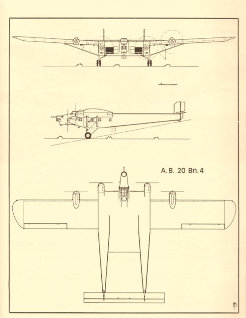

AB 20 - 1932 4-engined; twin-boomed; heavy bomber; x 1
- AB 20 : Initially, a redesignation & continuation of AB 15
- AB 20 : (As planned) DB 70-related trimotor bomber
- AB 20 : (As built) Bombardier nose position; as required
- AB 20 : 4 x 493 hp Lorraine 12Fb Courlis; span 37.00 m

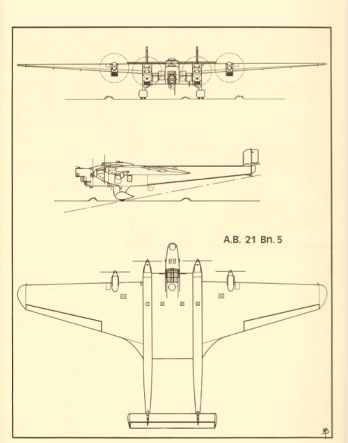

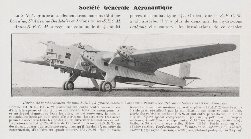

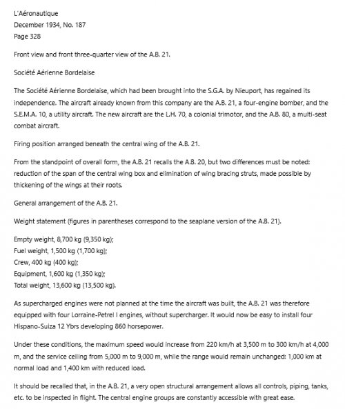

- AB 21 : Structually refined AB 20 with cantilevered wings
- AB 21 : 4 x 493 hp Lorraine 12Ha Pétrel; span 36.70 m
- AB.21H: (Project) 1934 torpedo/recce bomber floatplane
- AB 22: Prototype AB 20 revised from bomber to attack role
- AB 22: 1934; fitted w/ sideways-fire 75 mm gun; 5 x crew
-- AB 22 abandoned; gun firing resulted in wing skin damage
