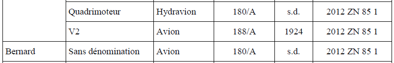

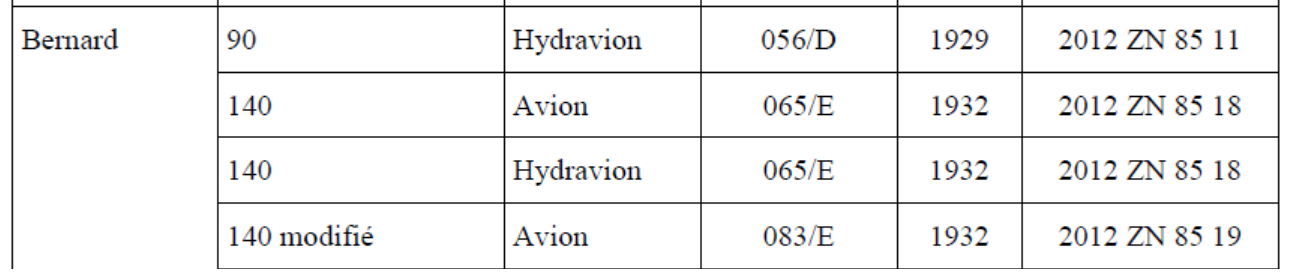

Also from Onera Archive,
90H was a seaplane of flying boat Project of 1929,maybe developed from Type-90 ?
140,140H & 140Mod was a three airplanes,a landplane and a seaplane
also there was a modified version Projects from 1932 ?
340H maybe a seaplane version of Type-340 BN.5,Project of 1933 ?
50 or H-50 maybe proceeded H-52,was a single seat seaplane fighter
Project of 1932 ?
Four-Eng was a four engined seaplane or flying boat Project ?
If by 'Type-90' you are referring to the 90 BR, it would be the other way around. The Bernard 90 hydravion dates from 1929, the Bombardier de Représailles (Reprisal Bomber) programme from 1933. Since this hydravion predates the 90 BR by four years, the question becomes: Was the 1933 Bombardier de Représailles a land-based development of the earlier Bernard 90 hydravion?
That said, I think we need to be very careful about using short forms that resemble official designations - eg: '90H', '140Mod', '340H', etc. The ONERA (L'Office National d'Etudes et de Recherches Aéronautiques) pdf ONERA: Essais en Soufflerie lists the designation the type numbers 90, 140, and 340 with 'Hydravion' solely as their description. (ONERA also lists the type 140 and 340 as 'Avion' but we feel no compulsion to create a '140A' or '340A' designation.)
Where Bernard applied 'H' for hydravion, it seems always to be as a prefix (eg: the H.50 listed by ONERA, the H.52 float-fighter, or HV.100 - for Hydravion de Vitesse - flying boat racer). So, it possible that a built Bernard 90 may well have been designated 'H.90' ... but we have no evidence for that. Ditto for the '140H' and.
There are similar issues with '140Mod'. ONERA lists "140 modifié", obviously refering to a variant of the original 140 landplane (or its wind tunnel model). When existing Bernard types were given minor modifications, they seem always to take on a new role designator suffix - eg: Bernard 18 T modified for distance flying becomes the 18 GR (Grand Raid). More serious modification of the Bernard 18 T were first indicated by bis ('again') as in 18 T bis or re-designated (as, in this case, the Bernard 190 T).
Same issue, the 1933 340 BN 5 was likely a derivative of that 1929 340 hydravion. Oh, and the undated four-engined seaplane is listed as Quadrimoteur, not 'Four-Eng'.
There are also some glitches in the ONERA listings. The V 3, HV 40, and HV 41 - all wind tunnel tested in 1929 - show up with numeral prefixes '9' or '12'. Other than that '9' or '12', there is no change in the listings. Under the '9' prefix, the V 3 bis also shows up (a variant which is not on c460's designation list). There is also a glitch in the C1 chasseurs monoplaces suffix listings where the '1' is displayed as a superscript ... Okay, pedant-mode off ;)
Another designation of interest in the ONERA listings is the Bernard 15 C1 hydravion wind tunnel tested in 1929. Presumably, Bernard was considering a float fighter derivative ... but why three years after the SIMB AB 15 prototype had flown?
Undesignated in the ONERA listing is the twin-engined Bernard-Ferbois hydravion wind tunnel tested in 1926. I presume that this would be a float version of the "Bernard-Ferbois V 2 racer? (I rule out a V 3 derivative only because that design was wind tunnel tested in 1929.)

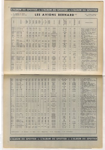

From Aviation magazine 1960,
here is the list,and we can add AB.13T & HV.47.
  • Aviation_magazine___président-directeur_général_[...]_bpt6k53234292_26.jpeg
