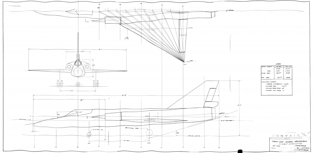

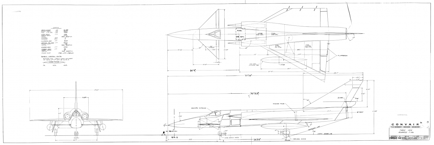

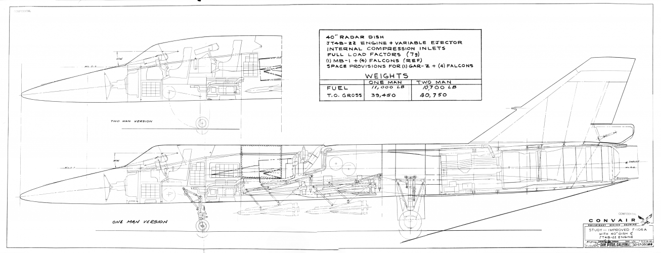

Advanced F-106
FYI, another new stack of pictures showing the development of an advanced Convair F-106 were uploaded at the SDASM Flickr archive today. :cool:
Here are some appetizers. Please notice the inlets and the canard.
Please also see @Orionblamblam 's blog post "Advanced F-106/Sky Scorcher" from 2009-11-13.
Link: up-ship.com/blog/?p=4514
View: https://flic.kr/p/2r8WjPj
View: https://flic.kr/p/2r8UDiy
View: https://flic.kr/p/2r7sxV8
I reached out to the SDASM archives about a month ago to get that document rescanned. We should have a better cross-section profile in only another week or two, as well as better proposed armament information.
Not to meddle, but did you ever get any higher quality documents?

I've got the files. Insanely high res scans, but one is quite distorted. I'll upload in a more usable format.
Distorted? They appear fine on my device, so I'm not sure what you mean/you're experiencing. Also yeah. 2400 DPI scans are bit ridiculous, but this is what I was given and I was hoping to preserve at least a little bit of that quality.
for completists - the full resolution scans. I reduced to 1 bit (black and white) to reduce the filesize. These are far too large for the server to thumbnail. #2 is 75855 x 25398 Pixels.
