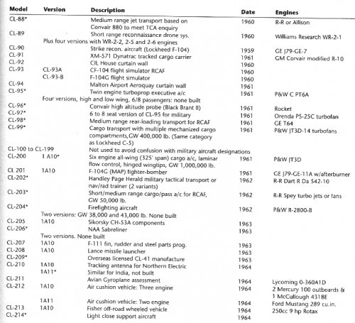

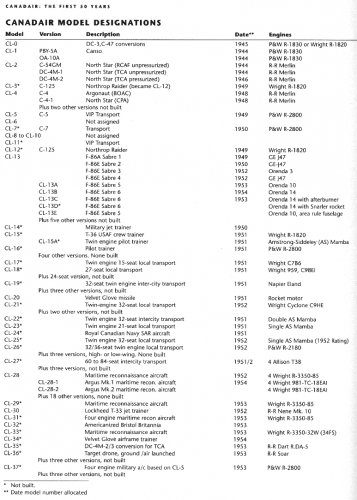

Apophenia,
Do you know "Canadair - The First 50 Years" written by Pickler and Milberry (CANAV Books, Toronto 1995 / ISBN 0921022077)? It's a good reference for a designation list, but - as usual - my copy is somewhere in a pile of boxes in the loft ...
Cheers boxkite! I meant to ask if anyone had a copy of "Canadair - The First 50 Years" ;D

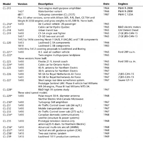

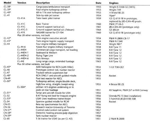

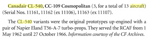

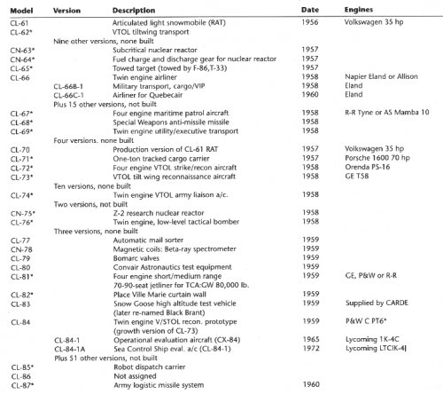

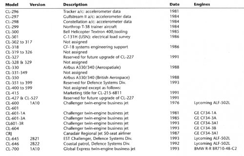

Ignoring my own plans for the afternoon ;) , here are the lists from the mentioned book.
Enjoy!

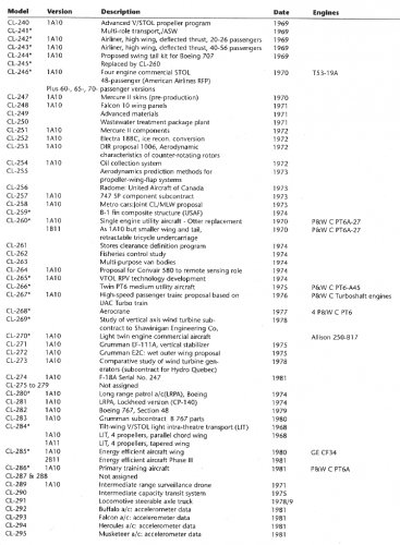

Edit: For completeness, the Canadair CL-200 to CL-700 series is listed below (once again courtesy of boxkite).
Canadair CL-200 to CL-700 designation list
___________________________________

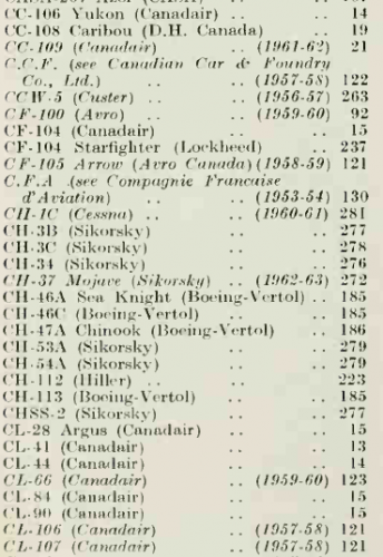

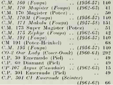

I suspect on that,in JAWA 1963 index a reference to CL-106 & CL-107,and also they mention CC-106
and CP-107 as anther designs ?.
Hesham: With "CL-106" and "CL-107", JAWA mistakeningly assumed that Canadair designation and Department of National Defence designations were directly related. They weren't (at least not in any methodical way).
CC-106 and CP-107 were strictly military designations for two of Canadair's Britannia-based designs. The CC-106 Yukon military transport was the Canadair CL-44-6 (4 x Roll-Royce Tyne 11s). The CP-107 Argus maritime patrol aircraft was the Canadair CL-28 (4 x Wright R-3350 TC18EA1).
My dear Apophenia,
but for CC-106 & CP-107,they were appeared in 1962 & 1963,although we will
wait to see the pages of those designation to can judge well.

Here is an Info about CL-540,was it a typo or not ?;
https://books.google.com.eg/books?id=_xAv7OwZMTgC&pg=PA172&lpg=PA172&dq=CANADAIR+cl-540+AIRCRAFT&source=bl&ots=cJye2GZ2Ww&sig=qxae8529hP-0NfQzAcFkdsVO4dE&hl=ar&sa=X&ved=2ahUKEwjvvc-dssfcAhVLaFAKHeDmAn4Q6AEwCXoECAIQAQ#v=onepage&q=CANADAIR%20cl-540%20AIRCRAFT&f=false
Molson and Taylor describe the CL-66, Canadair's in-house designation for converted/new build re-engined Convair CV-440s. Canadair had bought the unsold CV-440s, as well as CV-440 production jigs and tools when Convair phased out the type's production to make room for CV-880 production in San Diego. Canadair re-engined the three inherited CV-440s with Napier Eland turboprops, redesignating the lot CV-540C. Then, Canadair received a Canadian government contract for ten new CL-66B cargo and passenger aircraft, used as CC-109s by RCAF Air Transport Command from 1960 until the last two were decommissioned in 1979.
Source: 'Canadian Aircraft since 1909' by KM Molson & HA Taylor, Putnam, 1982.
Enjoy!
