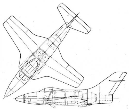

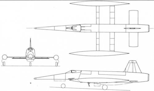

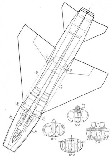

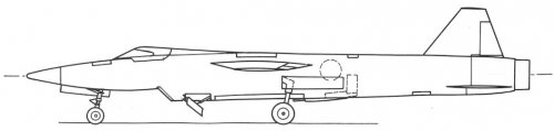

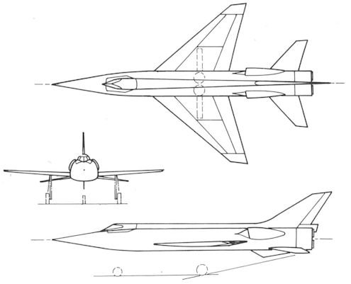

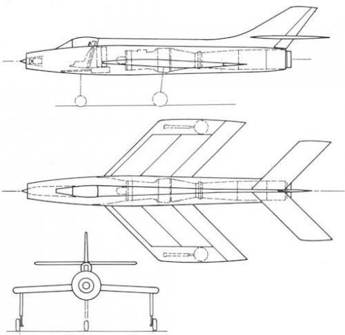

These two look like they could have been lifted straight out of "British Secret Projects: Fighters since 1950". Then again, why not? It was early days, and with little known, convergent solutions would have been the norm. They vaguely suggest straight-wing versions of Avro's jet-plus-rocket fighters, which suggests an interesting answer to the question of what, if anything, might have evolved had the Miles M.52 flown and the resultant data been used as a line of development.
GTX said:
I have the articles you were referring to. The XP-65 was to be powered by a RA24R Avon series engine. Span was 7.3m, length was 14.3m.
Here are some pics from them. First the XP-65:
And the related XP-68 - this was also to be built of stainless steel. It was to be powered by a RR Avon RA19R. It also had provision for a search radar. Armament was 2 30mm cannon + 1 missile on each wingtip + another semi-recessed under the fuselage. It was to be Mach 2 capable and was largely seen as a competitor to the F-104

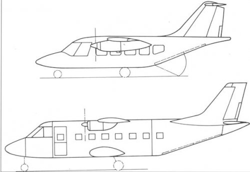

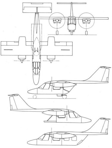

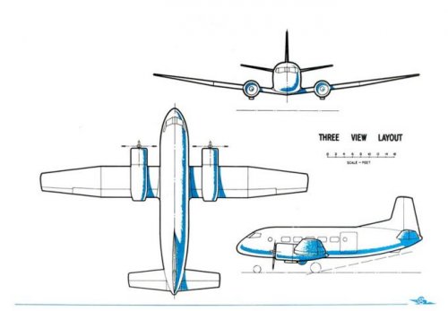

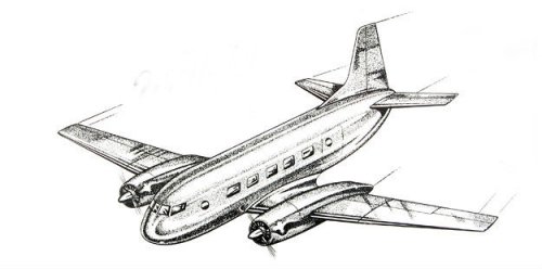

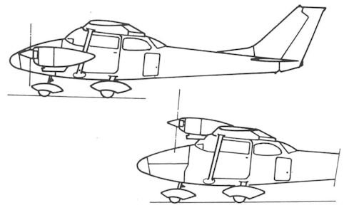

I wonder if it was this one based upon the Nomad (but GAF rather than CAC):
I believe this was another version of the same:
Supplied to me by "Uncle Les" (of modelling fame) who got them from the late Kevin Kerle.
Les has actually attempted to model it too:

Wow,very nice drawings and Model,thank you my dear GTX.

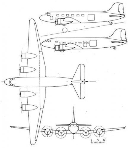

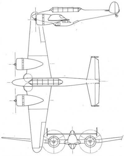

There are a few pages of details in Joe Vella's CAC projects article in AE63. It was basically a high wing, light twin (300 hp pistons) with a narrow fuselage and a modular 'prime mover' cab. Called the LMS [Light Military Transport] but despite the name concieved as a COIN support aircraft. COIN aircraft had a turret with two MGs, pilot and rear facing observer/gunner.

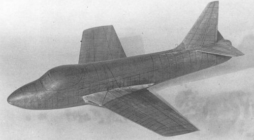

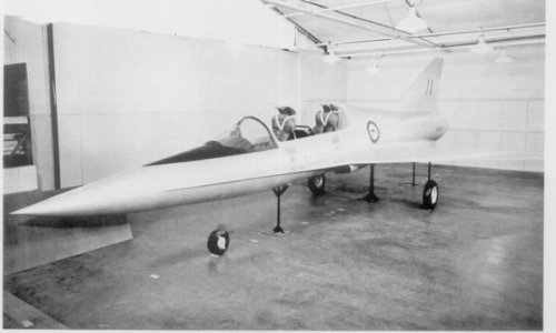

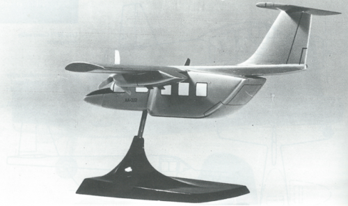

Here is an image of the display model of the CAC LMS. This example is fitted with the 'wide' body passenger/cargo pod. The COIN version would just have a gunner's position and turret in its place. Air Enthusiast 63 has three view line drawings by Joe Vella of some of the different proposals. And many other CAC designs. I recommend anyone interested in CAC secret projects should get a copy:

Hang on....hold the fort :eek: I missed this CAC LMS [Light Military Transport] design posting ???
The head-on drawing you posted GTX of the COIN design, is this a real design proposal or one of your 'What If' drawing mate?
If it's the real thing, can I obtain more info please??

The drawings aren't mine. They were supplied to me by Uncle Les.

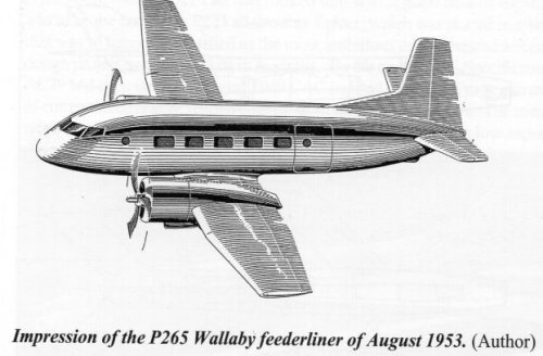

Abraham Gubler said:
From this source here is the brochure for the CAC Wallaby downsized to fit within the attachment limits here.
Absolutely splendid... Thank you so much for sharing.
Amazing find Abraham,
and can I ask you,on the last drawing,they wrote AP35,is that meaning Project P.35 ?.

Does anyone know where I could find stats/specs for the CAC LMS? I'm curious about engines, weights, dimensions!
GTX
All hail the God of Frustration!!!
Apr 15, 2006
2,957
442
beyondthesprues.com
LMS? I might be able to assist but need to clarify exactly wha you are referring to.
Avimimus
CLEARANCE: Top Secret
Dec 16, 2007
1,966
78
GTX said:
The Commonwealth Air Corporation LMS Light Military Transport:
http://www.secretprojects.co.uk/forum/index.php?action=dlattach;topic=1479.0;attach=577624;image
Mentioned in reply #53 and #54.
