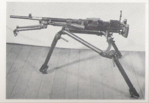

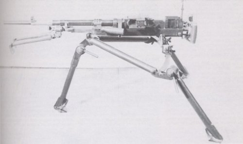

There was a belt fed MG chambered for the same round based on the Bren called the Taden, picture available here,

For more details on the TADEN see:
Pictorial history of the machine gun FWA Hobart Ian Allan 1971 (very good, dirt cheap second hand as it seems to have just got to library throwouts reaching the second hand market.)

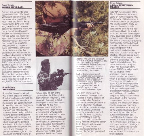

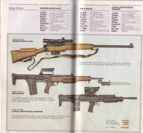

Found the book, less info than i remembered, i'll see if there is more somewhere else in another book. I've scanned and the images anyway, as the EM2 is discussed along wth the Individual Weapon. Basically makes for the family tree of the SA80. Hope its of interest.
Re: British .280 Rifle Circa 1951
Apart from being a bullpup, the EM2 is internally not much like the 4.85 and the SA80 developed from it to fire NATO 5.56mm. That, although your text says "mechanically more advanced" has had rather a chequered career, with a complete mid-life redesign to make it work.
I note your text also says "lighter" (but gives weights of 7.55lb for the 7mm EM2 and 8.5lb for the 4.85mm Individual Weapon, both with 20-round box magazines) and "smaller" but note that the extra length of the EM2 is barrel length, which makes for accuracy, though not so useful as a substitute for a sub-machine gun - though most of those are much smaller these days. But tactics change, and carrying the rifle inside an APC or IFV is more important now.

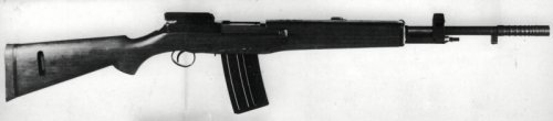

I've just found some info on another, lesser known British assault rifle chambered for the .280 British (or 7x43mm) cartridge: the BSE P-28 or Model 28-P. It was developed by Claude Perry and Roger Wackrow in 1949-50 to compete with the EM-2. The rifle was tested in the summer of 1950, but wasn't particularly accurate. It also suffered breech explosion during testing. Thought a revised version had its breech modified and performed adecquately, the project was cancelled. No more than fifteen rifles of the type were ever made.
Specifications:
Length: 42 in (1068 mm)
Weight: 9.4 lb (4.26 kg) with empty magazine
Barrel length: 20 in (508 mm) (5 groove rifling)
Magazine capacity: 15 rounds (the source says "apparently 15 rounds", it seems likely however that the magazine could have had a capacity of 20 rounds)
Best regards,
Piotr
*The data according to "Rifles of the World" by John Walter, photo below from "Modern Small Arms" by Ian V. Hogg

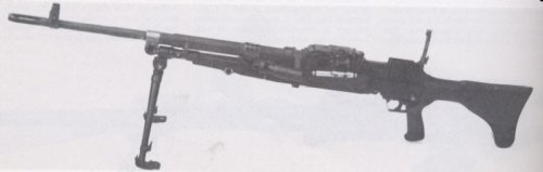

British early postwar rifles and mgs (not EM1 and EM2!)
Does anyone have any information about two projects using the
.280 calibre ammo in the late 1940s which are not the famous
EM 1 and EM2 rifles covered in another thread.
BSA apparently offered a rifle using the usual configuration
similar to the FN SLR with a pistol grip.
At the same time a new machine gun based on the Bren with
belt feed was proposed to replace British Army machine guns.
Because EM2 was so expensive it was proposed to equip second line units
with the Danish Madsen machine gun (This weapon often featured in
1960s films and TV series) and looked like a cross between a Schmeiser
and a Greasegun.
UK 75
ps I was amazed and depressed to find out how much better the EM2
was than the SA 80 despite over twenty years gap.
Re: British early postwar rifles and mgs (not EM1 and EM2!)
For the BSA rifle see Petrus last post on http://www.secretprojects.co.uk/forum/index.php/topic,3736.30.html
For .280 machine guns, see Pictorial history of the machine gun FWA Hobart, Ian Allan 1971

Many thanks to the moderator for getting my question in the
right place. The info here is truly awesome.
The machine gun looks a real winner and again has me wondering
how the British Army would have fared in the years since with
these weapons.
