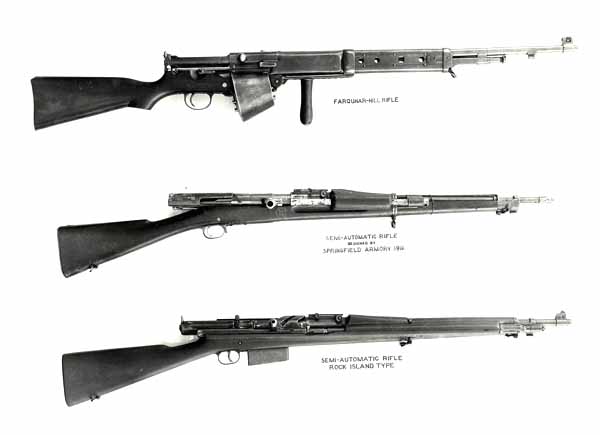

I couldn't quite see the pics on the WW2talk forum, found this one instead.
It's the top gun.
Original location: http://www.nps.gov/spar/historyculture/experimental-semi-automatic-rifles-at-sa-1900-1919.htm
Thanks for picture, as I understand it those pictures are of a weapon that was trialed in the US in 1917 and may not be the final variant as adopted for Great british production in 1918 though I would imagine that it is not far off.
The weapon seems to have been called the 'Rifle, .303 inch, Pattern 1918' which would effectively confirm that it was a semi-auto platform.
