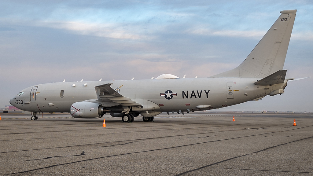

Well, things are getting interesting for the P-8 Poseidon TomcatVIP now we have two special mission variants. I wonder what the new variant might be used for? SIGINT/ELINT or some other role that requires such modifications.
Well, something had to replace the EP-3Es, and maybe RC-135s.
Once upon a time there was a formal requirement for an EP-3 replacement, called EP-X. Boeing was clearly the front-runner with a 737 derivative similar to the P-8, but Airbus and Embraer both had proposals. EP-X got "cancelled" back in 2011, but it looks like it essentially got done via the backdoor with aircraft modifications rather than new builds.
