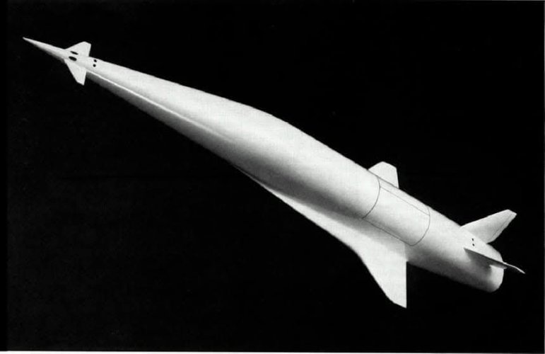

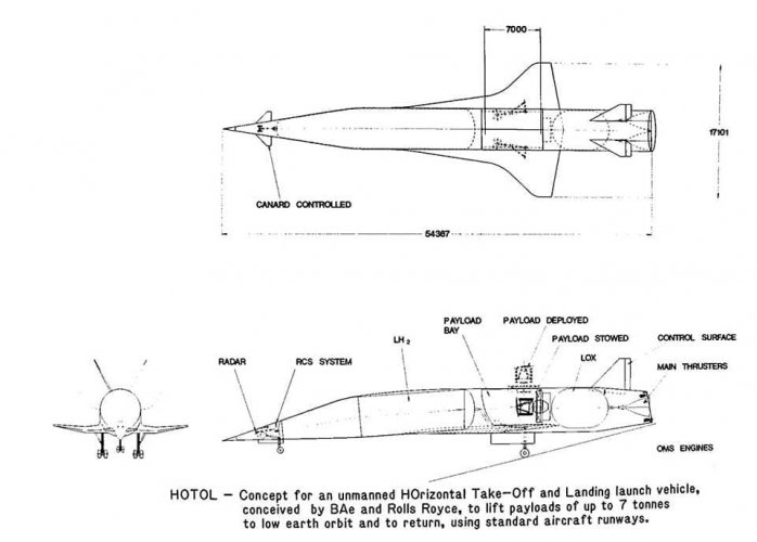

As luck/serendipity/coincidence/synchronicity would have it, I just started leafing through my shiny new HOTOL book copy, and the top drawing on page 103 shows *exactly* such an axisymmetric inlet arrangement for HOTOL, albeit with the nosecone and inlet slightly canted downward.
I have the book on my desk, right hand, as I type this. (checks frantically) Ok... oh boy, I've just realized that it might have been the right shape as far as engine vs CoG is concerned; and thus might have salvaged 40 years of Alan bond research, 1983 - 2023 ...

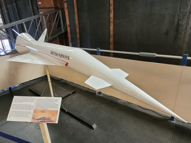

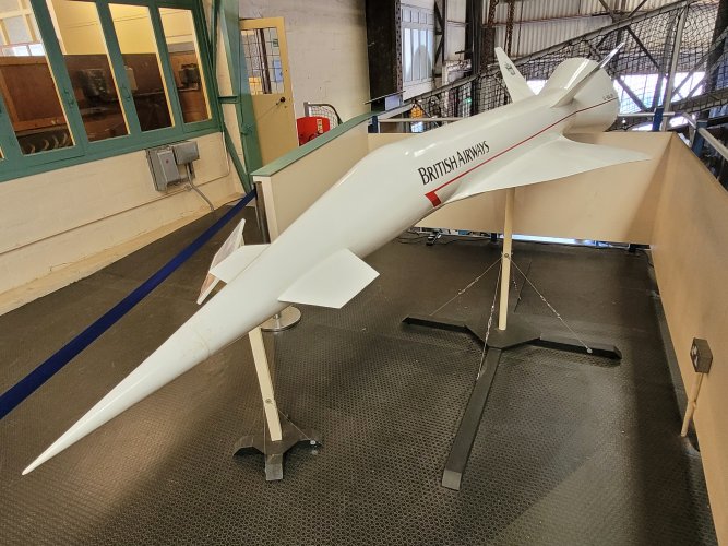

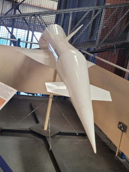

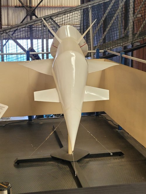

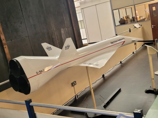

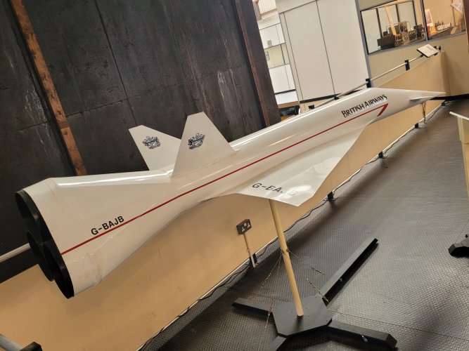

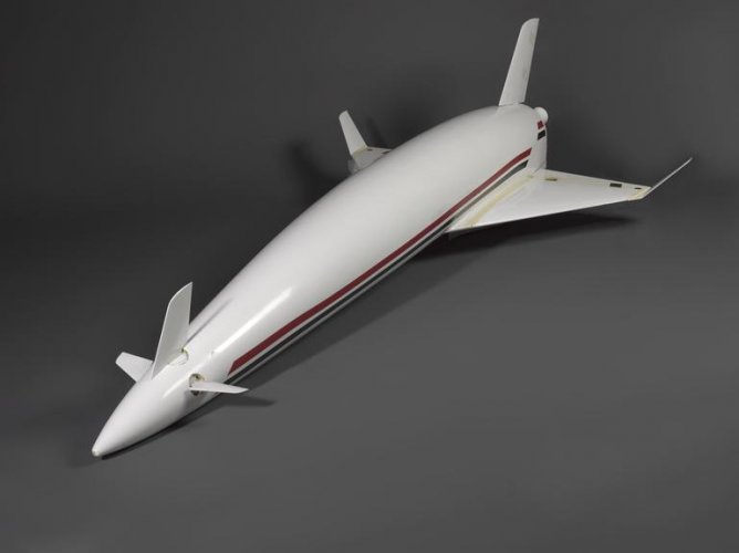

Brooklands Museum, July, 2025 (refinished tunnel model ? the flared back is intreguing hence thinking its there for a reason ?)

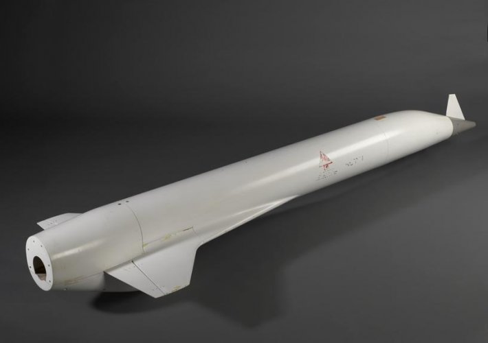

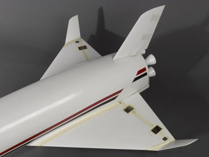

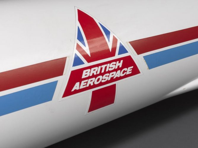

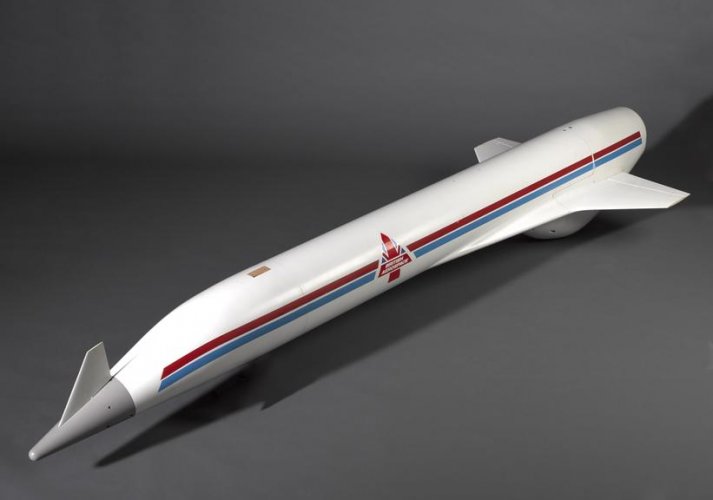

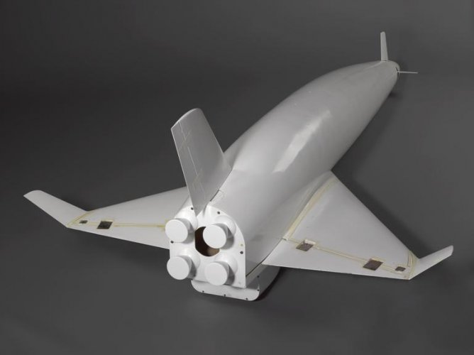

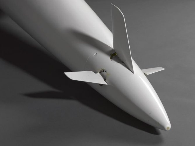

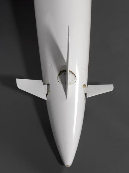

That's the first I have seen with two vertical stabilizers...I thought it only had one on the nose--any other tailfins on airframe noses?
The model in the Science Museum photos is mislabelled. It's actually HOTOL wind tunnel model SC2 of January 1989, representing Configuration H. The reason it has both fore and aft fins, as well as wingtip surfaces, is because someone has just stuck all the different test parts together and given it a lick of paint to turn it into a display model. As tested, unpainted, it would have either the fore fin or the aft fin, but not both at once, and was tested with and without the tip fins.
It's like if you got a model kit that came with alternative parts to create different variants, but then just stuck everything on at once.
To be fair, a two-fin (fore and aft) HOTOL, based on Configuration F, was assessed in 1986 to determine what effect that arrangement would have on controllability but the layout wasn't adopted.
A fuller account of SC2 can be found on p273-275 of my book HOTOL: Britain's Spaceplane. There's a photo of SC2 against a red background on the back cover too.
Details of the two-fin Configuration F are on p122.
That model in Brooklands museum was actually made by British Airways (apprentices?) as just a futuristic aircraft for display at some sort of BA internal event. A bunch of volunteers who like shiny things found it in a load of junk and decided with museum management backing that it must be Hotol.
It doesn't look much like any version of Hotol, it has no connection with Brooklands and should go into the skip.
Why would British Airways have anything to do with Hotol? Was a passenger carrying version considered? I think not.
One of the now numerous examples of inaccurate guesswork and non-accredited information that is taking over this once brilliant museum.
Just looking at it, I can agree with that. The flared rear end is ridiculous, and so are the big engine nozzles there. Kind of aerodynamic bottleneck.
The very long pointy nose with the canards makes no sense either.

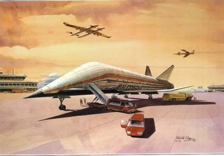

The Brooklands model looks like someone tried to do something notional for display purposes based upon a verbal description of the Keith Paige painting or a sketch of the early configuration studies

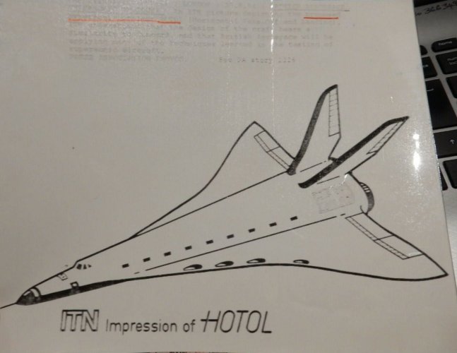

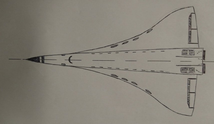

Here was ITV. media's interpretation of HoTOL. again based upon rumour and speculation (the Concorde like wing I'm thinking was a common descriptor ?)
