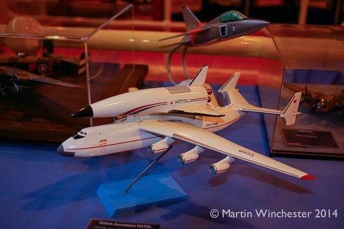

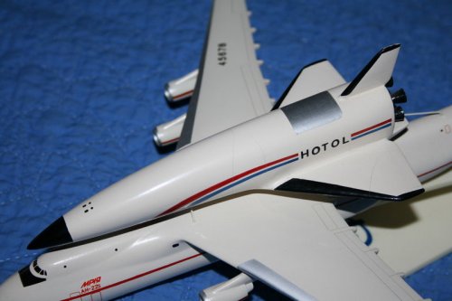

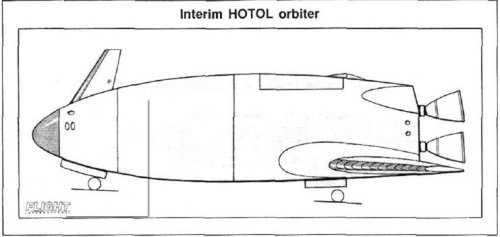

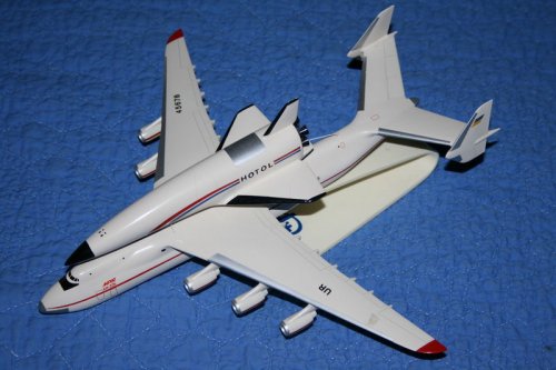

Just a note: As I understand it, there were two different projects under the HOTOL name: The original HOTOL, and the HOTOL 2 (or "Interim HOTOL"). The latter was a much less ambitious project using fairly ordinary rocket engines for a mid-air start off the back of an AN-225. This was, again as I understand it, intended as a stop-gap launcher until the Full Monty became available, air liquefying engines and all.
Regards & all,
Thomas L. Nielsen
Luxembourg
that's true HOTOL 2, nickname in some forums as "Super Deform" HOTOL ;)
was cheap Interim version to expensive to Developed air liquefying engines version
mmm... Monty ? dit you mean Money Thomas?
we have good "spell check" in this forum B)

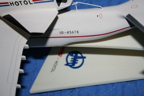

http://www.ebay.com/itm/RUSSIAN-UR-45678-AH-225-456-HOTOL-MPIR-RESIN-AIRPLANE-SPACE-SHUTTLE-/190580890442?pt=Diecast_Vehicles&hash=item2c5f819b4a#ht_500wt_1413

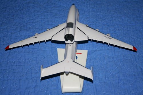

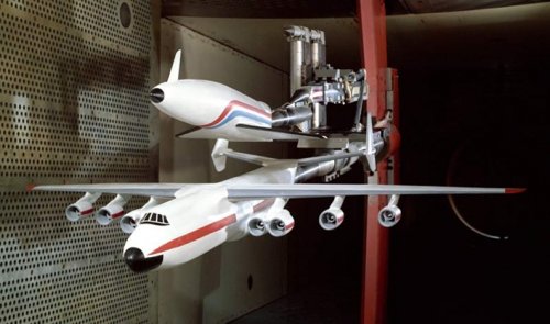

Mriya&HOTOL in WT in slightly better resolution
