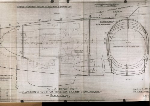

I have a 1942-43 file for the Rolls Royce 46-H-24 engine (later known as the Eagle 22). It has significant detail on the engine which at the time was under development, which in layout is essentially an upsized Napier Sabre.
The file also includes installation/proposal drawings for this engine in at least 4 aircraft;
1.Typhoon II
2.Tempest
3.Centrally engined (i.e. behind the pilot with a shaft drive to the contra airscrew) fighter with 4 nose cannon
4.6 engined (plus 6x thrust augmenters) 100 ton cargo aircraft (19200bhp plus 43200lb take-off thrust, calculation dated 16.3.43)
Although aircraft section drawings are included, there appear to be no manufacturers mentioned (though the first two are presumed) but there is one drawing APD1031 described as 'preliminary profile of engine prepared for Bristol Aeroplane Co.', dated 12.12.42. The aircraft views look quite Brab-like but with a Lanc-like tail.

That 46-H-24 Tempest would be the P.1027 but your Typhoon II is a bit of a puzzle. BTW, there was also the P.1032, an Eagle-powered Fury proposal.

Attached here most of 1 drawing that compares a 46-H-24 installation with Napier Sabre but over the weekend I'll start a new topic under propulsion and put the RR H engine stuff there and maybe start new threads for 1. centre RR H engined fighter 2. 5 Merlin engined high altitude Lancaster and leave the RR H engined heavy transport (100 ton) in this topic ? There's probably a better way so please let me know !

Nice drawing,thank you Liberty12.
