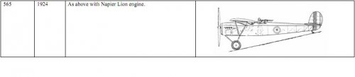

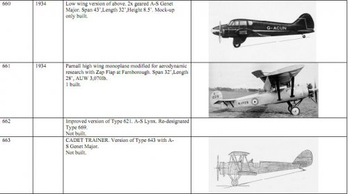

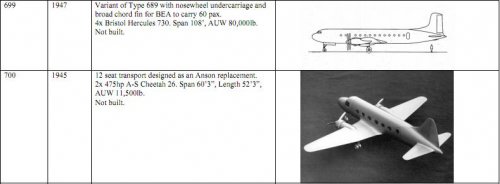

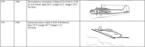

For example,Avro-564 was a two seat fighter monoplane Project of 1924,was it involved in any Contest ?.
Yes there are a lot of questions. Of course not all designs were drawn up to fulfil specifications but in the 1920s in particular it was hard to justify building anything as a private venture. In the 1930s and the advent of the RAF expansion plans, and into the 1940s, most effort was naturally put into pursuing Air Ministry requirements. A lot of these are probably no more than quick concepts even though they appear to have been allocated project numbers. However without some explanation as to the source of the drawings and some idea of the context it is hard to make judgement
That's right Schneiderman,
but in private venture,the Avro Heritage mentioned this,for Avro-564,unfortunately no drawing,
but the Avro-565 was relate to this fighter,and also a mystery ?.
The side view drawing appears to have RAF markings but at this date there was no obvious requirement for a new two-seat fighter. However Condor powered two-seaters, torpedo bomber and light bomber, were requested for 25/23 and 26/23 so perhaps the design started life to meet one of these.
Good analysis Schneiderman,and if we look to 1924,there was two Spec. for high speed fighters ?.
also for Avro-570 single seat seaplane Project,I suspect if it was submitted to Spec. 2/25 ?.
Also I think the Avro-568 was submitted to Spec. single seat fighter 25/25 ?.

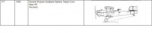

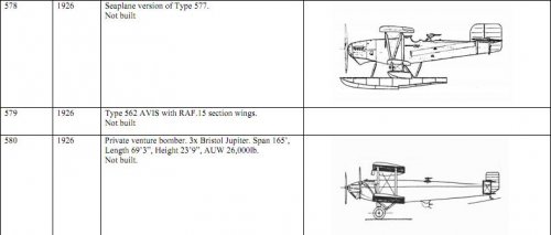

also I suggest that the Avro-577 was submitted to Spec. 33/26 ?,by the way this
competition had anther tenders.
I'm not sure that is correct. I think the Atlas, Hyena and Vespa were competitors for 30/24, which the Atlas won. 33/26 was just to cover development of the Atlas.

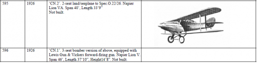

also I can ask if Avro-596 was submitted to Spec. 22/26 as Avrop-595 or not ?.
Probably not as 22/26 was specifically for a two-seater fighter reconnaissance machine.
There is quite a big difference between the 595 and 596, which had both a longer fuselage and bigger span, more like 'derived from' rather than 'version of'. I can't think of any Air Ministry spec. that requested a single-engine, three seat bomber.

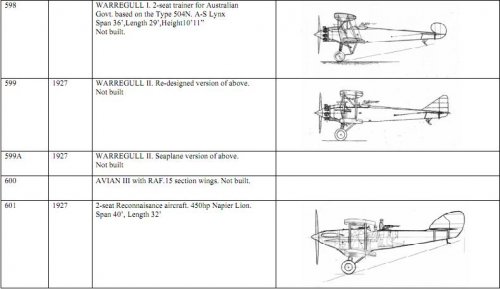

anther doubt in Avro-601 and if it was submitted to Spec. 22/27 or not ?.
22/27 = three-engined night bomber. I guess you mean 22/26? If so then maybe, an alternative to Type 595. Spec issued Nov 1926 so tendered designs could have 1927 dates

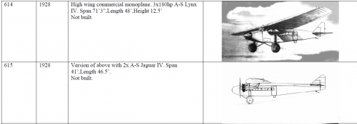

can we assume that,the Avro-614 & Avro-615 were submitted to Spec. 20/28 ?.
Whoaaa, no.
20/28 was for a six-engine flying boat, Supermarine type 179 'Giant'
Schneiderman said:
Whoaaa, no.
What about 22/28,I know it was cancelled,but maybe the competitors were not satisfy
the Air Ministry ?.
