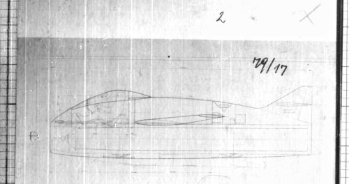

The P 1079/13a P 1079/13c (for which no known drawing exists) became the Me 328, not the P 1095. And the P 1099 had an all-new fuselage, not just the nose.
newsdeskdan said:
The P 1079/13a (for which no known drawing exists) became the Me 328, not the P 1095. And the P 1099 had an all-new fuselage, not just the nose.
There's a designation Project 1079/17 in the beginning of 1942 changed to Me 328, which is stated in my source - " Samoloty Luftwaffe " vol. 2
by Marek Murawski, Wydawnictwo Lampart, Warszawa 1997, but I won't argue. I'm not specially interested in the late Nazi projects :)
Boogey said:
There's a designation Project 1079/17 in the beginning of 1942 changed to Me 328 in my source - " Samoloty Luftwaffe " vol. 2 by Marek Murawski, Wydawictwo Lampart, Warszawa 1997, but I won't argue, I'm not specially interested in the late Nazi projects :)
Oh, you won't argue? That's nice. My source is the original P 1079 project documents from Messerschmitt.

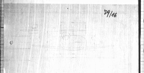

Boogey said:
It seems Mr. Murawski has right and he knows what he's writing ... Ahough airplane in the drawing above doesn't look like the Me 328.
Or maybe you think the P 1079/16 is a better candidate?

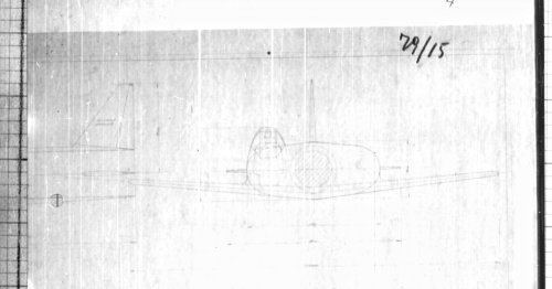

How about the P 1079/15?

Something else interesting about one of them - looking at the 'Libelle', you can see that it looks rather similar to that early P 1101 drawing that also appears on these pages elsewhere. In fact, from a forward view, they could be the same. This doesn't seem like a coincidence. It seems, to me, more like someone got a look at the original designs, then tried to recreate them years later from memory.
