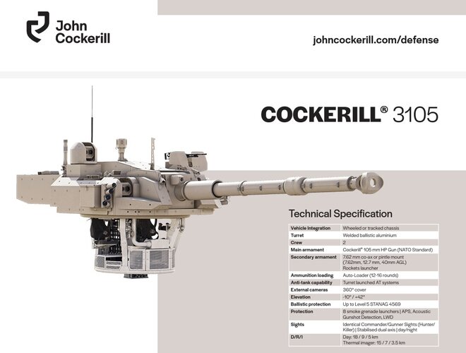

Hmm. Could a high elevation 105mm be made? I know that one problem tanks had in Afghanistan was insufficient elevation to engage ATGM and RPG teams. I know autocannons have higher elevation than 120mm so could a 90 or 105mm be made to match that of a 30-50mm range auto cannon? I think that heavier autocannons are the route to go as 20 and 25mm doesn't have much use for smart rounds.
