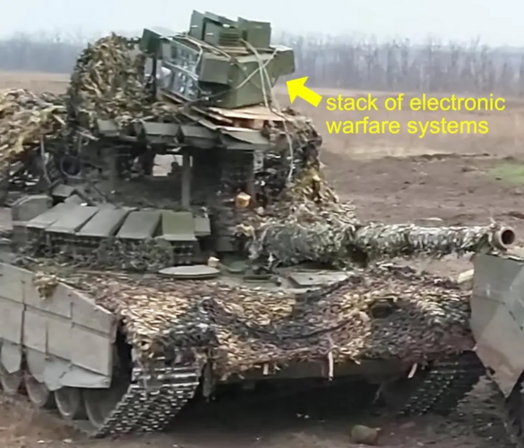

Drones will be cheap and cheerful decades before the end of the century - they are already there - so a good anti-drone defense is needed. Unless there is a good laser to make hard kills, something like a 40mm grenade launcher should do it, with proximity fused ammo of course. Dual feed, so the ground targets can also be engaged, the weapon sitting on the top of the turret.
