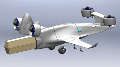

Regarding the Sabrewing design I am flabbergasted by the mounting of the forward thrusters on the swiveling noze. That makes for some freakingly solid latches requirements (the attachement points would have to be able to sustain the weight of the entire aircraft in dynamic conditions).
VTOLicious
Nov 24, 2008
723
338
Regarding the Sabrewing design I am flabbergasted by the mounting of the forward thrusters on the swiveling noze. That makes for freakingly solid latches (the attachement points would have to be able to sustain the weight of the entire aircraft in dynamic conditions).
Imho, the whole concept is ridiculous... Btw, is that a coffin? :D

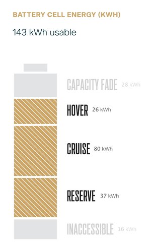

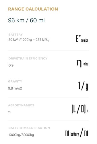

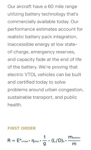

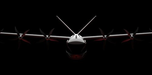

A new player...
https://www.aviationtoday.com/2020/...build-generational-electric-air-taxi-company/
"...Like many other eVTOL startups, Archer Aviation’s website includes a sleek-but-mysterious computer-generated aircraft design, detailed performance targets, and a “master plan” to take over the electric aviation future.
But a few elements of Archer’s unveiling set it apart from many of the 250+ other startups eager to join the UAM race. The aircraft’s performance targets — 60 miles range, 150 mph cruise speed — are calculated realistically and transparently, incorporating energy reserve requirements, inaccessible elements of battery storage as well as capacity fade..."

TomcatViP
Hellcat
Feb 12, 2017
3,338
2,104
Definitively, the Age of the Startup is over... Please welcome (and grab tightly your wallet) the new era of Startup[side down] :
“The tilt-wing design is more aerodynamically efficient than lift-plus-cruise configurations and it has fewer moving parts compared to tilt-rotors, making it more reliable,” Rimenalli told Robb Report. “The control system is simpler than both configurations as well. It just made sense to choose this path.”
Reaper
Mar 31, 2009
215
18
I think not lying about realistic performance is not really a differentiator, the talent from A³, Kitty Hawk and Joby might be though.

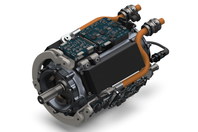

Hmmm...do i understand correctly that this is a liquid-cooled design? If that's the case, it's unfair to compare its specific power to that of air-cooled designs without adding the mass of the cooling system. I mean, still impressive figures, but i doubt they actually 'tripled the power density'. Headline aside, the rest of the article had good information.
TomcatViP
Hellcat
Feb 12, 2017
3,338
2,104
If we are speaking about installed power, we would have to take into consideration the liquid cooling unit from the original ICE. Yes it would be removed with an air cooled electrical engine and not replaced but at the end this little "trick" is still valid: regarding any engine swap, this one will triple power density (the weight balance with the liquid coolant unit being certainly negative) regarding any other electrical installation.
To give some perspectives, from my mem, this unit packs three time more for 1/4th the weight of a Rotax 100hp when other market engines, as claimed here, would simply have an equal output with a somewhat equal weight.
This is significant.
Zoo Tycoon
May 27, 2008
504
629
In my experience this kind of misinformation from new entrant electric motor vendors is monotonously common. The other common thing they claim for WoW factor, is a peak useable torque at the stall torque, which of course it’s not a practical useful condition.
Ultimately it’s quite easy to design an electric motor at reasonable high efficiency which means you bump up against the laws of physics. At this point it’s a law of diminishing returns, where you need to work really hard to get a small improvement.... single digit improvements are quite possible and impressive (eg reduction in AC filter sizing, hence core losses, by inbuilt PE being such an idea) Ultimately the motors performance depends on winding resistance, cooling and magnetic flux density.
Liquid cooling generally doubles, maybe a bit more, the power density of the electromotive element.
