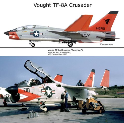

I wish somebody could modify that stupendous Twosader color profile with a Spey exhaust and some of the other goodies planned for the RN bird...
Only by looking at this picture one can understand why the Crusader got his variable incidence wing. That rear fuselage is sooo loooong... as I mentionned in my earlier post, a shorter Spey would allow a drastic cut of the rear fuselage. Look at the picture author signature DEBARRE Michel: it corresponds to what would be cut thanks to the shorter Spey (up to the strakes).
two-seat trainer version based on F8U-2NE, fuselage stretched 2 ft (0.61 m)
Length: 54 ft 3 in (16.53 m)
17 m in length,
J57
Length: 244 in (6197.6mm)
So the J57 is 1/3 the length of the entire Twosader ! Which bring its length up to the "N" in NAVY on the rear fuselage.
The spey is 1/6 shorter (5.2 m vs 6.2 m). More or less the dark grey exhaust is gone.
