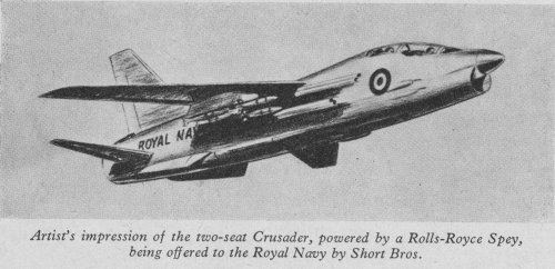

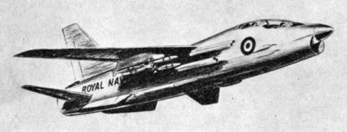

This the one Ralph ?
Cheers
Geoff

What are the 2 paired tubes on the fuselage sides?
They look like the encapsulated launchers for the far later SRAAM missile?
TinWing said:
Thorvic said:
Cheers
Geoff
Wow!
Those are two round launchers for the Zuni air-to-ground rocket. Used primarily by USMC Crusaders in Vietnam.

Have you noticed the modified nose ?
UK Crusader
(Project stillborn by June 1964)
Built by Short Bros in Harland
RB.168-25R Spey turbofan, 12,000lb dry, 20,000lb reheat
Based on two seat TF-8, but equipped for pilot & navigator
Front fuselage development and production by Short, with rest of fuselage imported from Vought in the US, for assembly in Belfast.
With Spey, 50% British
Unit cost only slightly above French purchase price (£500,000)
French system of double leading and trailing edge droops, together with (BLC) blown ailerons and flaps
Could be made compatible with Firestreak and Red Top
Flying Review International June 1964

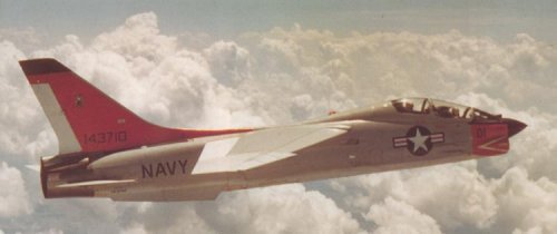

Yeah... I think LTV were trying to interest the USN in a conversion trainer but they didn't bite, she ended up on test duties until being sold back to LTV for use as a trainer. She crashed in 1978 I think whilts training Pilots for the Philippine Air Force...
This is the original shot of the bird from Wings of Fame... looks much better in RN colours imho... but then most things do!

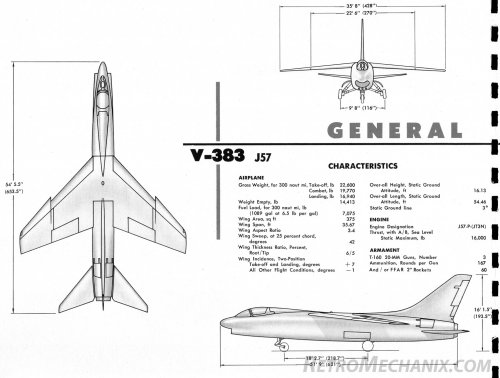

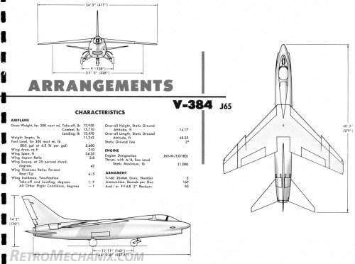

Pioneer, I would think that references the original "small" Crusader (V-384) wrapped around the Wright J-65 engine, a license built Sapphire. This was offered at the same time the J-57 powered F8U (V-383) was offered and in the end, selected.
Good reference here - http://retromechanix.com/vought-v-383-v-384-day-fighter-original-f8u-crusader-proposal/
Enjoy the Day! Mark

From Mark's link to Jared's site:

The V-384 was a smaller airplane than the eventual winning V-383
V-384 Length: 48' Span: 34.2' Takeoff weight: 17,950 lbs Straight forward deck spotting on 200' of deck 27 airplanes Manually folded wings
V-383 Length: 54' Span: 35.6' Takeoff weight: 22,600 lb Straight forward deck spotting on 200' of deck 25 airplanes Power folded wings
The power-plants differed of course as the V-384 was using the J-65, the lowest output engine considered for the day fighter competition vs.
the J-57 which was considered at the highest output engine for possible use.
