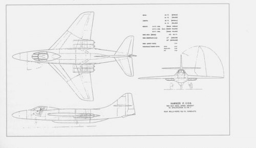

Presented here is a three-view line drawing (I have little else information) on the Hawker P.1108, one of the aircraft that competed with the ultimate winner of the contract, Blackburn.
The only information given besides the three-view, is the following:
"Two-seat Naval Strike aircraft to Spec. M.148T. Four small Rolls-Royce turbojets. Blackburn Buccaneer was successful tender to this Specification."
(If anyone has any tech data and other information on the Hawker P.1108, could they please post it on this website?)

In the moment no more information, but it is mentioned in Tim Lamings
"Buccaneer" book, I'll look for it this evening

Original Hawker 3 view painting with dimensions is in Maurice Allward's Modern Combat Aircraft 7: Buccaneer.

Hi Jemiba!
Thanks for posting the illustration! That's FAR BETTER than the one I was going to send anyway, and the most important thing is that this information gets to the website for everyone to see!
Chuck

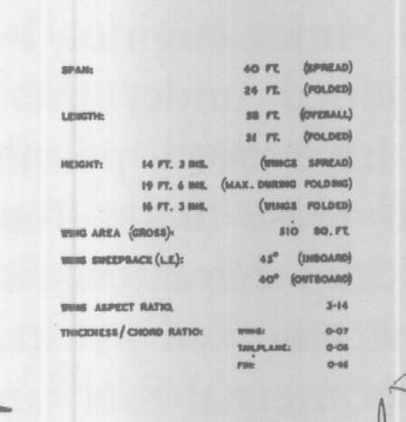

The power plant is given both by Tim Laming and Tony Buttler as four RB.115 engines.
The dimensions are hopefully readable on the cutout of Lamings 3-view.

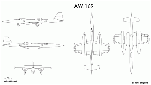

As per the Subject 'Grumman A-6 Projects' - I posted a reply regarding similarities to the Vought V-416 submission and the Armstrong-Whitworth AW.168 designs
The Armstrong-Whitworth AW.168 design was submitted to the Royal Navy`s NA.39 requirement of 1952, which was subsequently won by the Blackburn Buccaneer design
I am after more information and 3-view drawing of the AW.169 design if you have it please, so that I can compare it to the 3-view drawing and specifications of the Vought V-416

Hi Pioneer,
for the AW.168,please see;
http://www.vectorsite.net/avbucc.html
and for AW.169,please see;
http://www.strange-mecha.com/aircraft/Cancel/UK-AW.htm
For both types I would recommend Tony Buttlers "British Secret Projects", the fighter and bomber
issue, and Derek Wood "Project Cancelled".
The AW.169 was to meet R.329/F.155T for a supersonic all-weather interceptor .The Armstrong-
Withworth proposal was a straight wing aircraft with four Gyron Junior engines and an additional
rocket engine. Aerodamically quite similar to the Bristol 188.

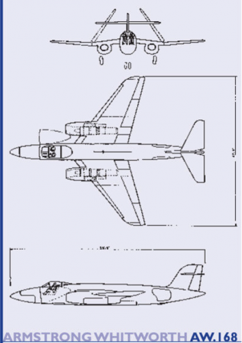

Yes, I know, but I saw just a request for a 3-view of the AW.169, sorry.

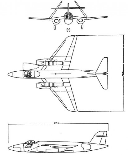

Here's the 168 . But I have to correct myself, this type isn't mentioned in
"Project Cancelled" but in Tim Lamings "Buccaneer".

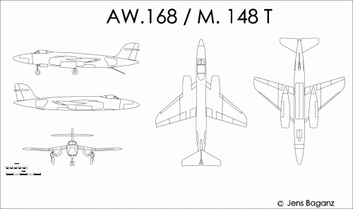

Well, similarities, yes, of course, at a first glance, but that's true, too, for the
Sud-Oust Vatour, and even more I think.
Between the V-416 and the AW.168 there were quite a number of differences.
Swept to straight wing, mid wing to shoulder wing, tandem to side-by-side
seating and the AW.168 was a considerable larger and heavier aircraft, (40.000
compared to 25.500 lb) than the V-146, very similar to the before mentioned
Vautour. What remains is more or less the operational role and the basic layout
as a twin engined aircraft with the engines under the wing, I think.

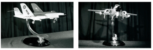

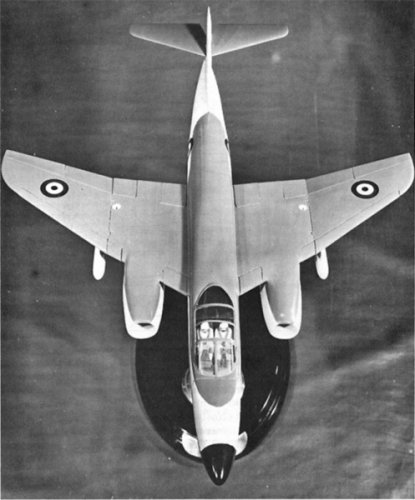

AW-168 model
Oliver Tapping, Armstrong-Whitworth Aircraft Since 1913, Putnam 1973
Do you have any further info on the AW.168's specifications? Its dimensions seem unreadable from the drawing you've posted (at least I cannot decipher them)... Especially it would be interesting to know what engines the plane would have had.
Best regards,
Piotr
It used two de Havilland Gyron Junior engines. Placing the engines in underwing nacelles freed the fuselage for an internal bomb bay sized to ft Green Cheese, but concern over thrust asymmetry pulled them inside the landing gear. A single wing fold was used for weight saving. Rather than flap blowing like Buccaneer, it used jet deflection of the engines through 45 degrees to improve takeoff/landing performance.
A full-sized wooden mock up of the aircraft was constructed, and it ran the Blackburn NA.39 a very close second in M148T. AW proposed building two prototypes as flying shells, without the wing fold mechanism or jet deflection, to check the aerodynamics.
Do you have any idea what thrust the RB.115 would have had? I couldn't find the info, unfortunately.

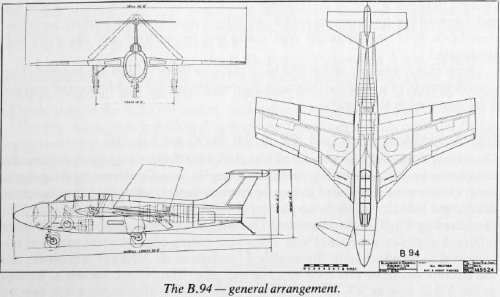

Hi Ivran,
it was Blackburn B-94 naval fighter,here is some info about it.

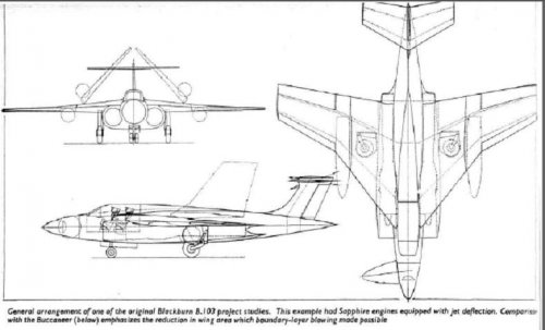

Hesham,
Not quite, the version in Flight is the B.103, the first true step on the way to the Buccaneer. The B-94 is very closely related, but more of a fighter than a strike aircraft.
Early B.103
Span 45ft
Wing area 650 sqft
take-off weight 42,000lb
2 x 11,000 lb thrust Armstrong Siddely Sapphire ASSa.7
From my dear Rolf,
and Keypublishing Ltd.; 100 years of British Flight,here is the Armstrong-Withworth AW.168,which
intended to compete Blackburn B.103 Buccaneer.

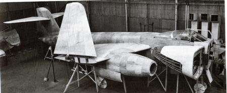

Mock-up of the Armstrong-Withworth AW.168
Would love to see more pics if anyone has them ;)
Regards
Pioneer
