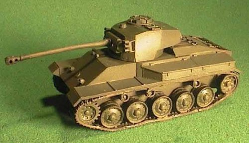

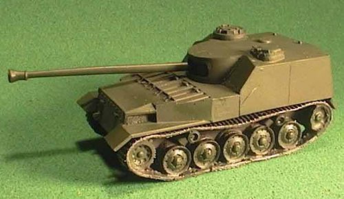

Canceled in the early 50s alongside the FV 200 family of vehicles was the lightweight FV 300 family of vehicles (~20 tonnes).
* FV301 21 ton tank with 77mm gun (based on A46)
* FV302 GPO/CPO Command Vehicle
* FV303 20pdr Self Propelled Gun
* FV304 25pdr Self Propelled Gun
* FV305 5.5 inch Self Propelled Gun
* FV306 Light Armoured Recovery Vehicle
* FV307 Radar Vehicle
* FV308 Field Artillery Tractor
* FV309 RA section vehicle
* FV310 Armoured Personnel Carrier
* FV311 Armoured Load Carrier
Pictures at: http://henk.fox3000.com/FV300.htm
So well before Brig. Simpkin's Scorpion family of vehicles the British Army had a requirement for a range of lightweight AFVs. The FV432 family (including Abbott) filled many of these roles but not all.

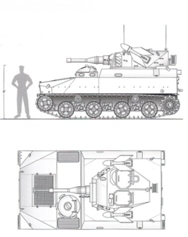

The Vickers 13-ton light tank concept, i.e. a hull of the FV430 family plus the Saladin turret with side-mounted ATGMs reminds me similar Canadian project of the Bobcat variant, namely the Light Recce Tank. It was to have a Saladin turret as well, but with two or four SS-11 missiles rather than the Vigilants.
Here you've got a speculative drawing of such the Bobcat LRT that has been published in "The Army Doctrine and Training Bulletin" of Winter 1999 (of course "the army" in the title is that of Canada).
