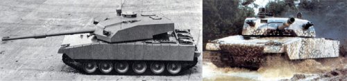

The Vickers Valiant turret was redesigned to incorporate the L11 120mm tank gun. This design came to being in 1982. Weights did change, i have no information on the weight of this tank.

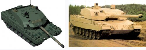

In 1985, in an effort to sell tanks to Eygpt the german leopard-2 chasis was matched with the Universal-120mm turret and renamed Vickers Mk-7 MBT. Combate weight of 54,000kg and 1500bhp engine.

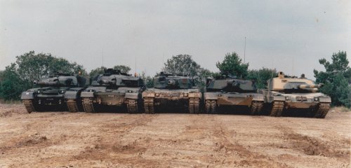

I found this picture on 4chan of all places, no background info was given.
